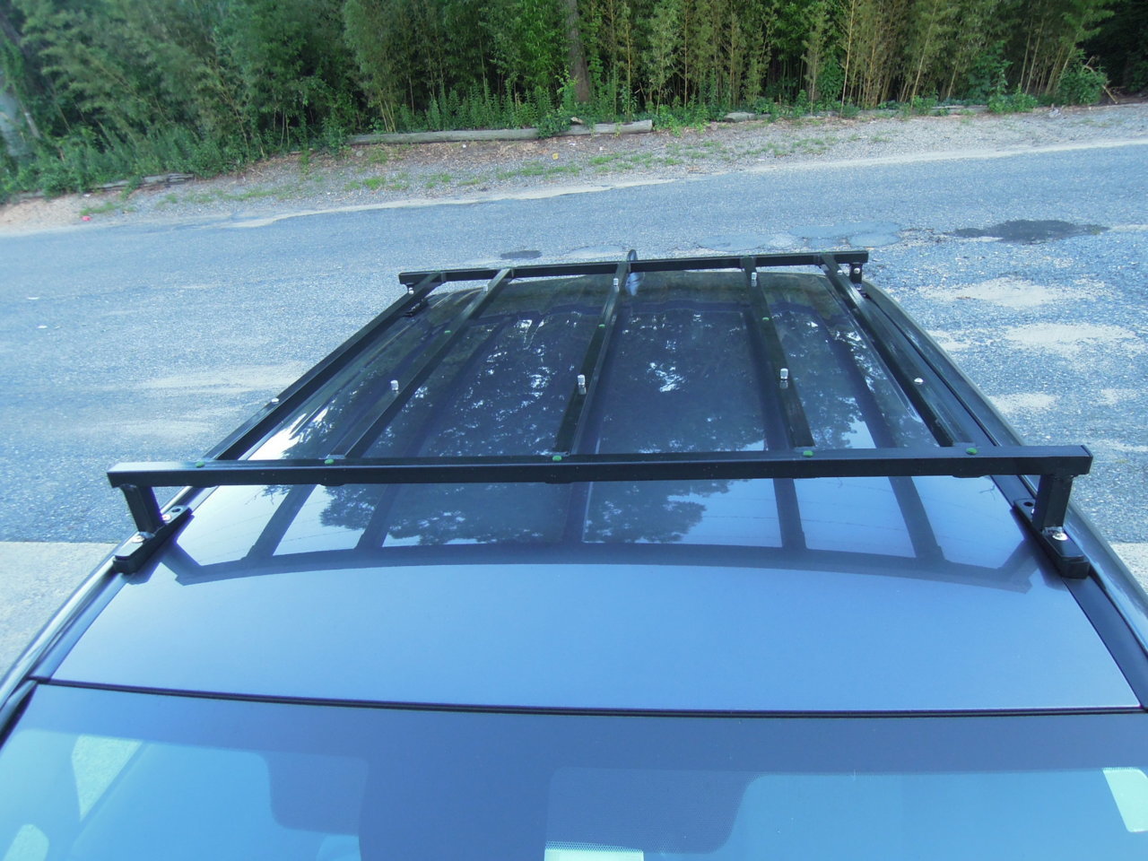

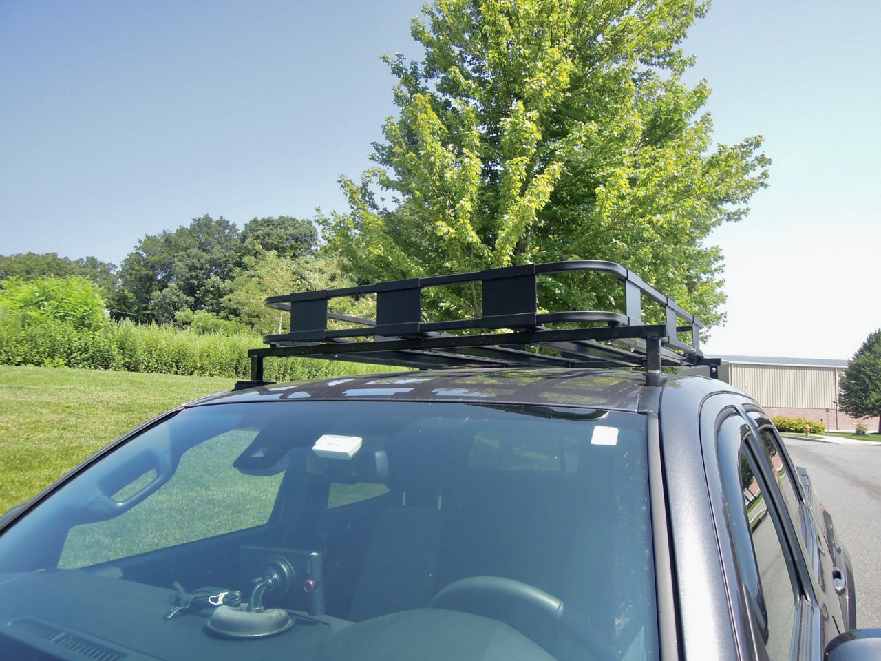

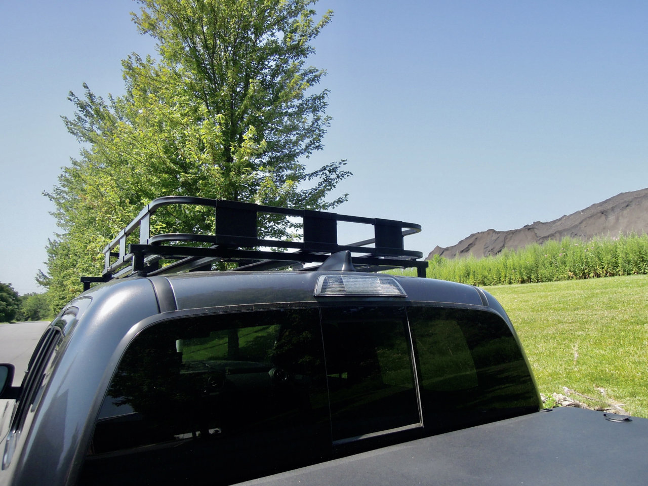

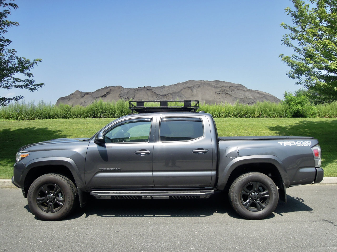

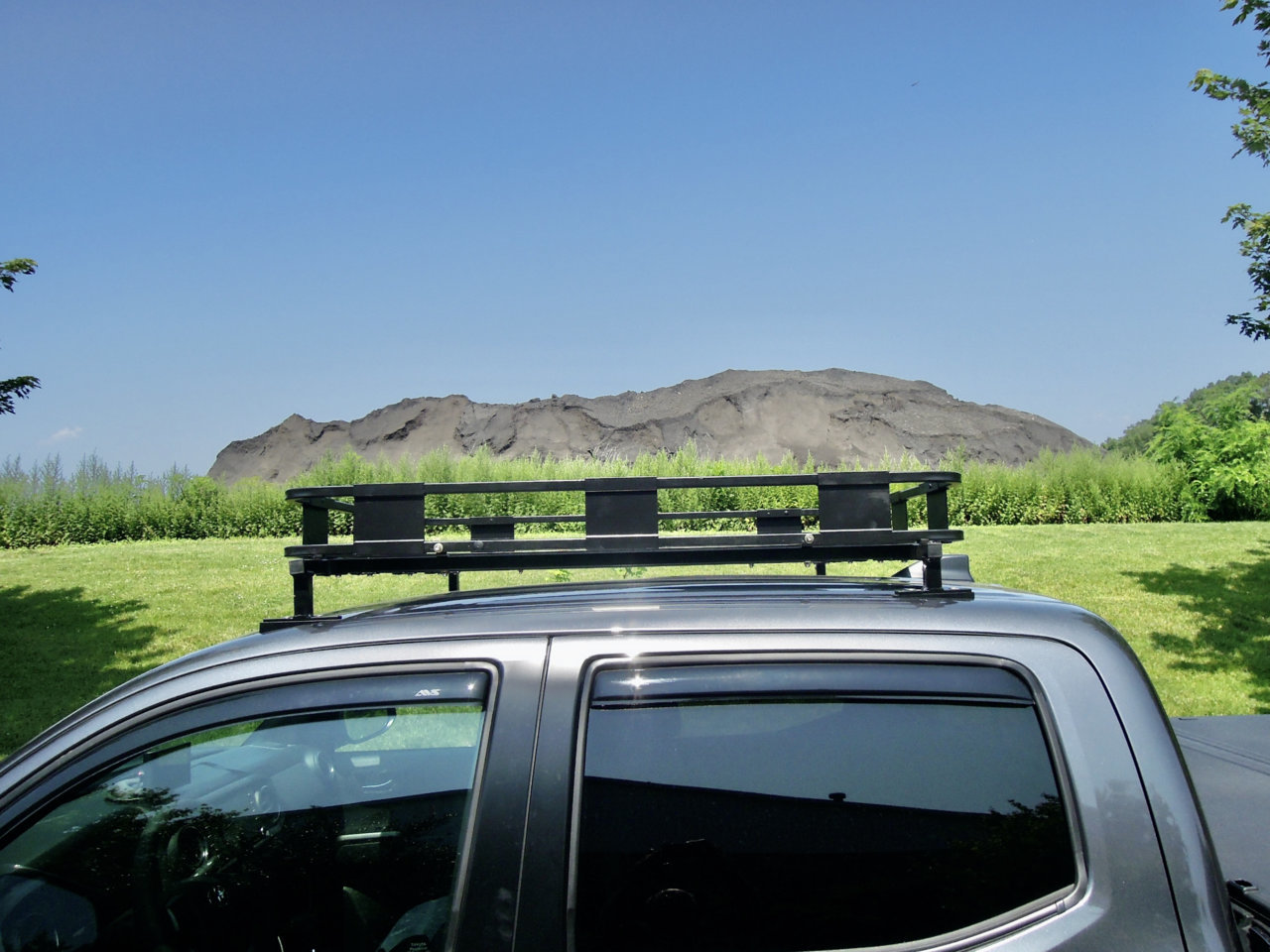

    All done and it can really hold way more weight than I could ever plan to put in it. Just about no wind noise at high speeds. Very happy with the project, and how it turned out for my use. Still quite easy to keep the roof clean through the openings.

    Very cool! I'm thinking about DIY'ing a single cross bar to sit in front of my overhanging camper. Would you mind sharing what you used for materials particularly to attach to the roof holes and get a bit of height? Thanks!

    Hi I started the base with scraps of Azek 3/4" decking board and mitered the angles as needed to give me a flat base. I spaced the base with flat 1/4" bar stock from leaf spring shackles that I had - but 1/8" would be fine also. Bought extended bolts on EBay to secure to the factory threaded holes with 3M Marine adhesive as a thread sealant. I then built the structure with 1" thin wall square stock and had a good friend powder coat for me. After I test secured the mounts - I laid blankets on the vehicle and tack welded the bars in place, so that it was one complete unit. I plugged the ends with plastic caps that I also found on EBay or Amazon. Fun Project !!

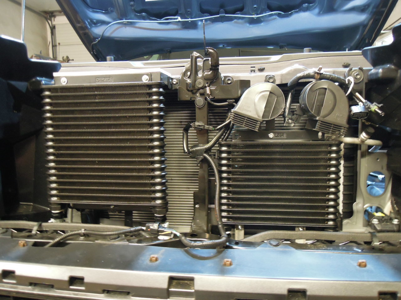

    Now for my transmission cooler set up that was cheap too ---
