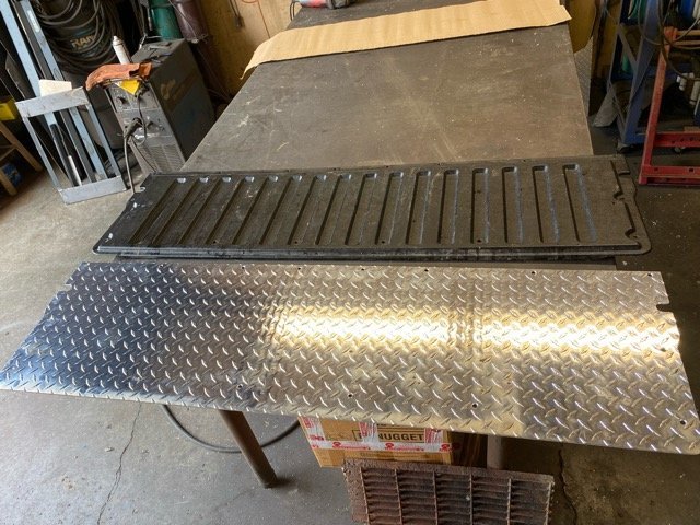

    2018 TRD OFF ROAD
    Was seeing if anyone has made their own versus spending $400 on a piece of plastic. Was thinking if I found a sheet of Kydex big enough, I could cut it to size and add my own cupholder inserts. Anyone toy around with this? I tried searching but may have missed some info so apologies there. Thanks

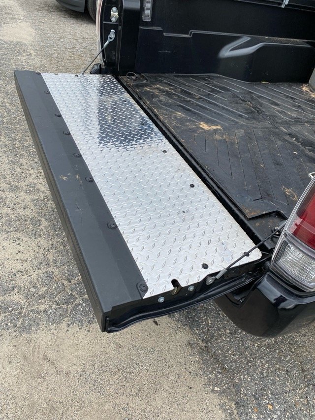

    Made mine out of aluminum tread plate years ago - way better than plastic. Also got threaded "nut-serts" and stainless Torx to put it onto the tailgate to screw it down tight. Also laid out and added a row through the middle just for good measure. Use 1/8" 6061 aluminum if you can - it has the same strength as mild steel.

    This looks like it would hurt more to kneel on than the original lol

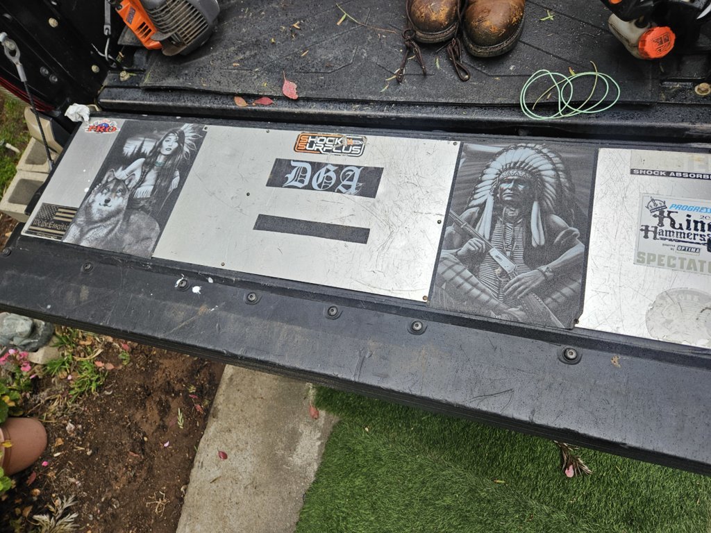

    Looks great,but thats gonna be slicker then dog shit when it gets wet. I took some skateboard grip tape and placed it on mine. Ill take pictires tonight.

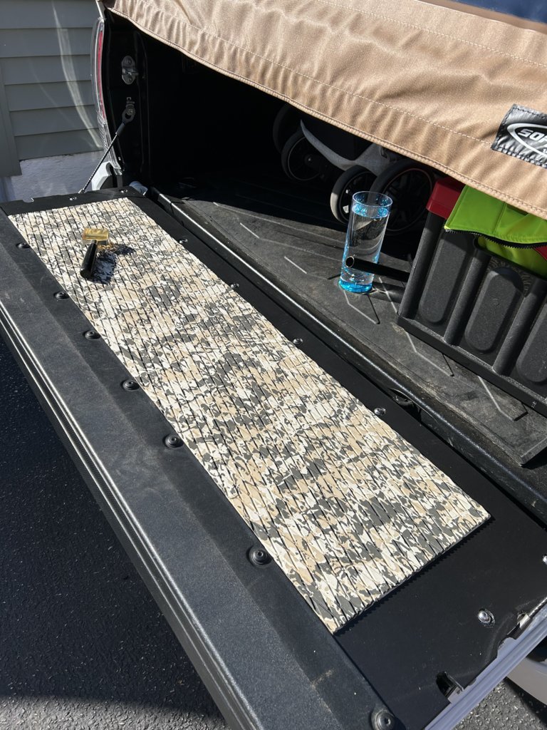

    I didn’t have it listed when I posted :rofl:but saw you were and figured it would help if you needed to find some. The guy there was very helpful and he chamfered the edges for me. It’s super easy to work with btw.
    edit - I added a sheet of self adhesive foam boat/jet ski decking last fall. It’s held up pretty well

    Here's mine. The Indians are skateboard grip tape i had laying around. And the (doa) letters are grip tape as well.
    I slipped when it was wet and almost busted my ass. The grip tape made it better.
    The metal is aluminum sheet.

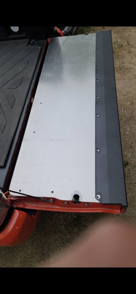

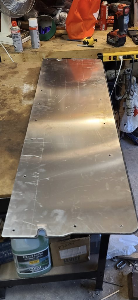

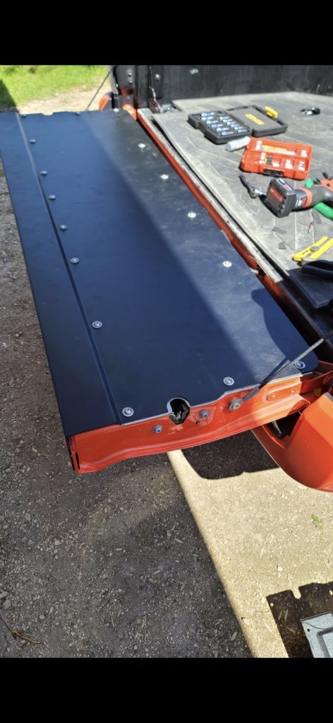

    I also made my own, then I wasn't a huge fan of how little it helped with tailgate strength. I ended up getting the relentless fab aluminum one and sandwiched my aluminum one under it. Then added rivnuts and stainless hardware. Works great for hauling bikes now.Screenshot_20250506_121848_Gallery.jpg Screenshot_20250506_121834_Gallery.jpg Screenshot_20250506_121621_Gallery.jpg
