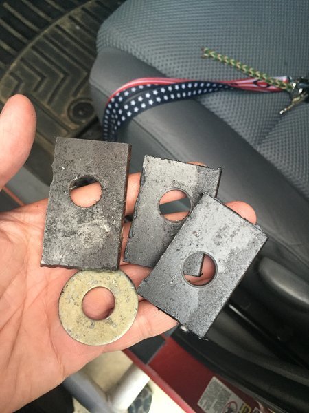

    Hey buddy I have an install question. Trying to do the front skid and can't remember if those little pieces you gave go with the fronts or not

    what pieces?

    Those should be the washers that go on top of the crossmember. It'll go skid, crossmember, rectangle washer, flat washer then nut i believe

    Gotcha. I was just under the truck and realized that lol. Guess I'm going to home depot

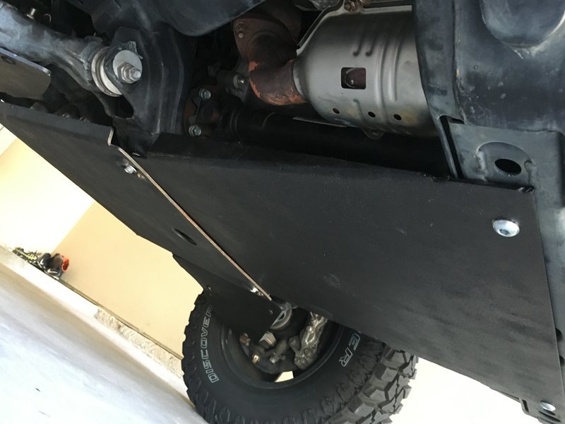

    Front ifs skid uses bolts from the factory skid in the same location. Rear bolts go up through the cross member which holds the rear of the ifs and front of the mid skid. Let me see if I have pics of any of those connections

    something like this one?
