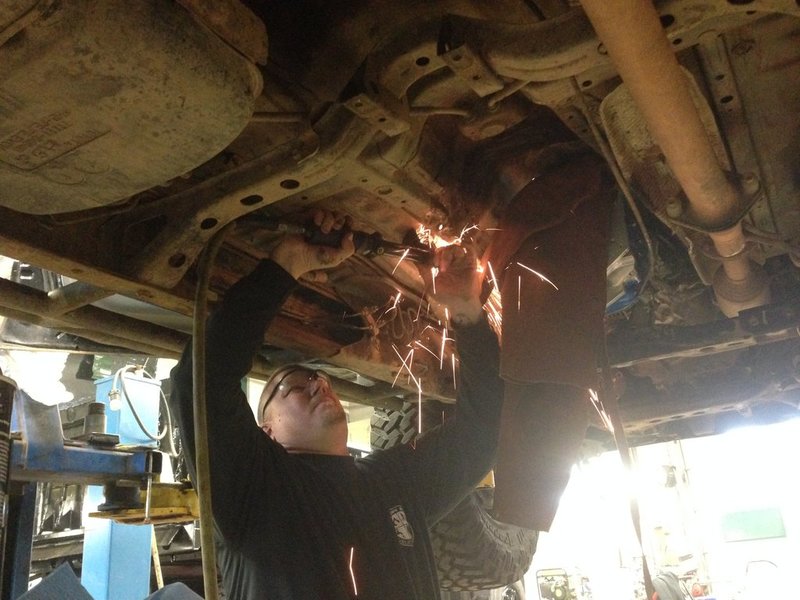

    Craig beating on his truck

    And grinding :sawzall:

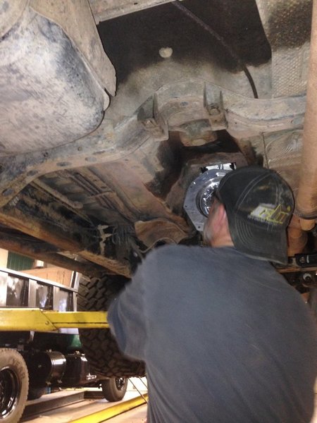

    Crazy... you plan forever to get something done and one thing you've had since day one does not fit... :annoyed:
    When I got the crawl box from Inchworm they shipped an incorrect seal housing extension. We had what we believe is one for an auto trans not manual trans. Due to that we were unable to fully install the setup. What we DID get done was basically mocking the entire thing up and getting it all in the right places.
    I'll post a pic dump later on after I get the kids settled down for the evening.
    Truck is sitting immobile @ the shop yard until next Friday when I'll hopefully have all the correct parts I need.
    *the rear driveshaft is 1" too short. :frusty:
    Regardless, my thanks go out to Jerry @loosnut & Anthony @PSU Taco85 without them this would never have been possible. :thumbsup:

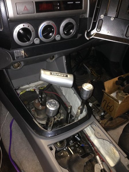

    All the days progress:
    so long to solo trans stick!
    Mocked up in a box...
    essentials
    goodbye rear driveshaft
    goodbye stock t-case
    goodbye stock exhaust crossover
    I think this bolt goes here...
    old & new
    the magic blue box...
    And this is where all joy left my heart. (for a little while)
    she has been doomed immobile.
    Fuck it! Keep cutting!:sawzall:
    Looks like it'll work...
    sure, why not?
    Jerry cuts some moar.
    makin shit happen.
    moar cut.
    moar bash
    what fucking unicorn kind of shit is going on here?
    Dafuq?
    further adjustment required...
    magic black toothpaste
    a dash of derp.
    too short shaft :mad:
    Ant gets to play with molten metal - hence the grin
    moar sparks flying
    git er done!
    Bottom line: everything is mocked up and functions as it should.
    Up until today, as far as I know, no one has ever done a triple stick setup in a 2nd gen Tacoma. Today we made it happen.
    Another note: without the NWIfab short-shifter setup for the FJ case I do not think this would ever have worked. Thank you Mark @NwiTACO

    So the body lift wasn't quite enough huh? I'm guessing that's the result of clocking the transfer case, right?
  18. Oct 4, 2015 at 8:32 AM
    #2278
    HomerTaco
    HomerTaco [OP] also HomerTaco Vendor
    Mar 28, 2010
    #34129
    45,875
    HomerTaco
    HomerTaco
    HomerTaco
    The BL was fine but yes - clocking the case required a bit more persuading.
    Learned that there was no way the triple stick linkage would come close to fitting without the BL.
    Also the FJ short shift kit from Mark was key. I honestly don't see it working without it.
