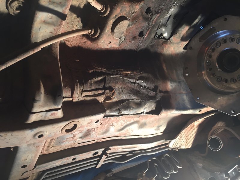

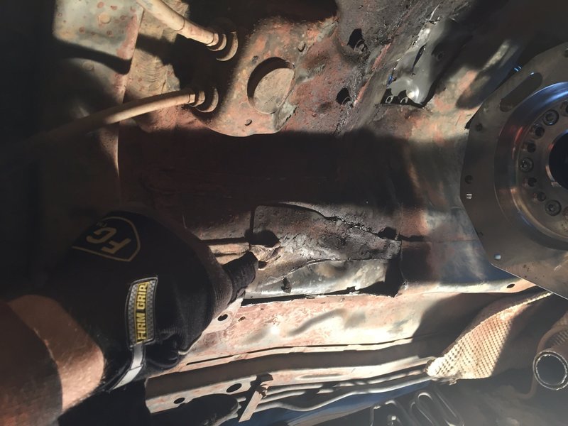

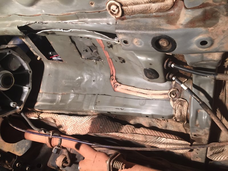

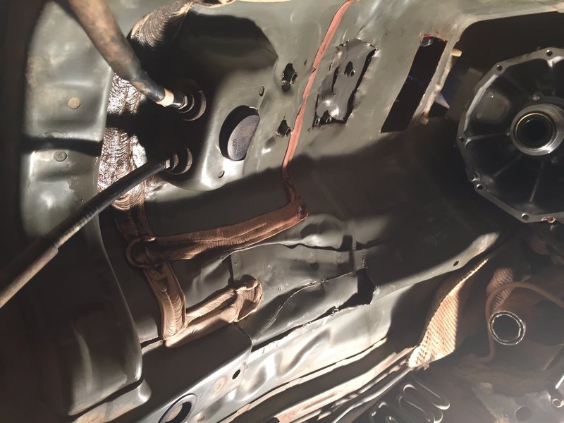

    I first had to take everything we had mocked up apart. More clearance was needed hence the BFH:

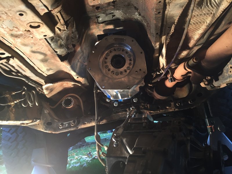

    I already had the triple stick linkage out so the first move was to drop the FJ case:
    The tunnel was pretty hacked up and i still needed a bit more room on the drivers side for the clocked case.
    Here's the spot that needs moar persuading:
    All better:

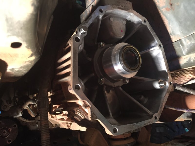

    Pulled the crawl box next and was finally able to put the elusive oil housing in place. :yay: Sucker fit like a glove. :cool:

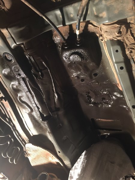

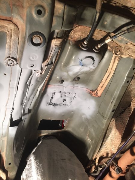

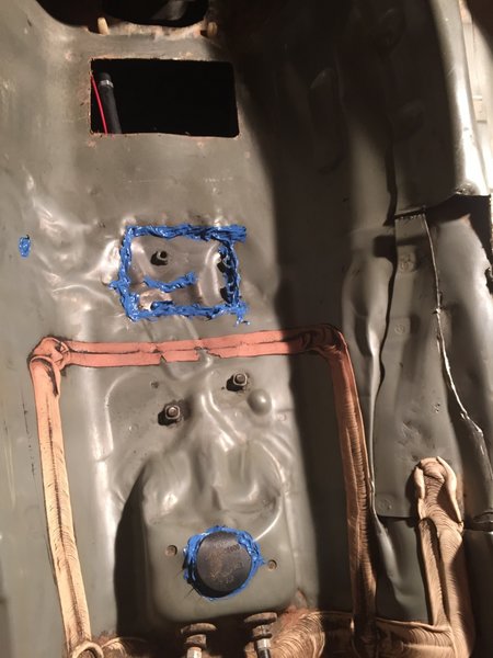

    the next task was to clean up and seal the tunnel.
    Some RTV for the holes...
    A bit of primer.
    A couple coats of Rustoleum Rubberized Undercoat.

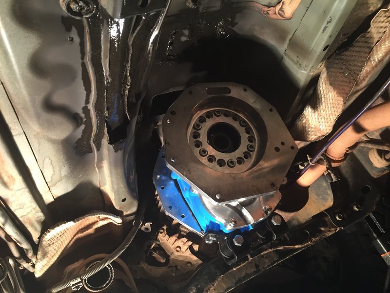

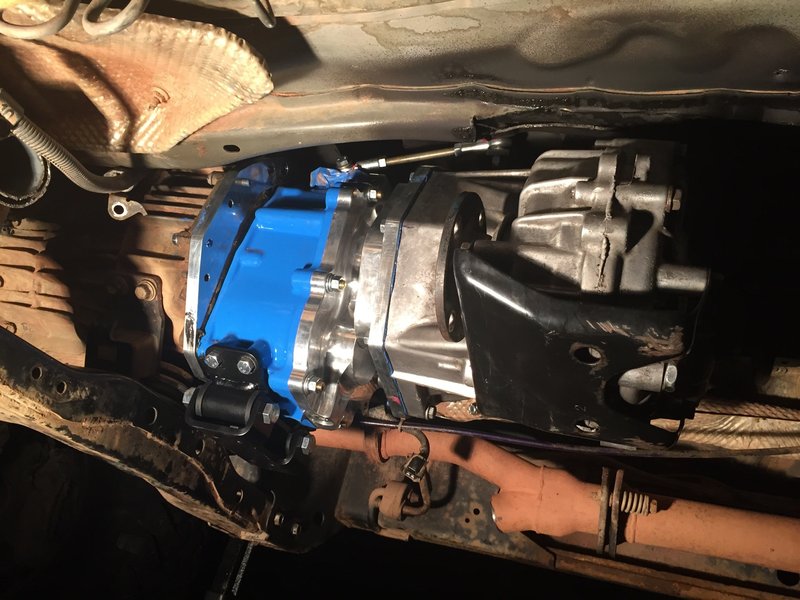

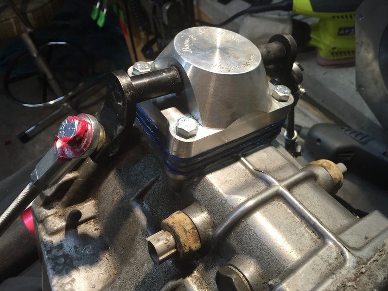

    While that was all drying I turned my attention to the FJ case. Since Jerry & Ant & I had everything pretty much all lined up I needed to seal up the shift assembly and get it finally ready.
    With the undercoat still drying I carefully RTV'ed the Crawl Box and bolted it back on the Trans:
    Taking the FJ Case out by myself sucked. Putting it back in solo was a test of patience... I basically had to bench-press it with a bolt in one hand and once it was in hold it with one hand and thread the starter bolt with the other. Needless to say I was covered in RTV. :oops:
    Got the bitch back in though. :cool:

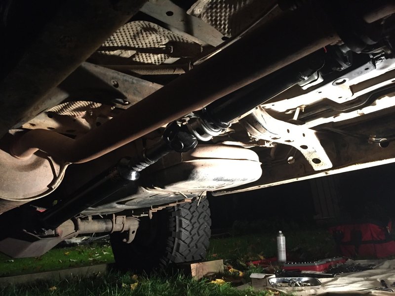

    Ready to install the driveshaft! However the bolt holes would not line up & I could not move the flange on the third as the rear wheels were chocked & the front was up on stands. I ended up re-installing the triple stick linkage and then simply shifted the FJ case to neutral. I could then spin the flange on the T case and line up the driveshaft.
    All bolted up!
    It was getting late so I had to call it quits. Tomorrow I'll throw on the front shaft and load the crawl box up with oil. I should then be roadworthy :fingerscrossed:

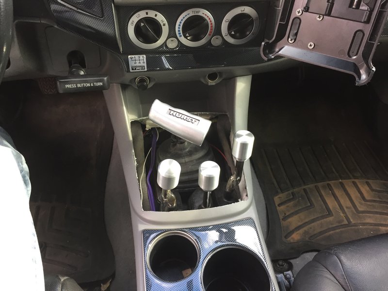

    It'll be hilarious thr first time you have to take clients somewhere that have ridden with you before and they ask whatthe fuck you did lol
    Could you simply shorten the 2wd/4wd shifter to clear the transmission shifter?

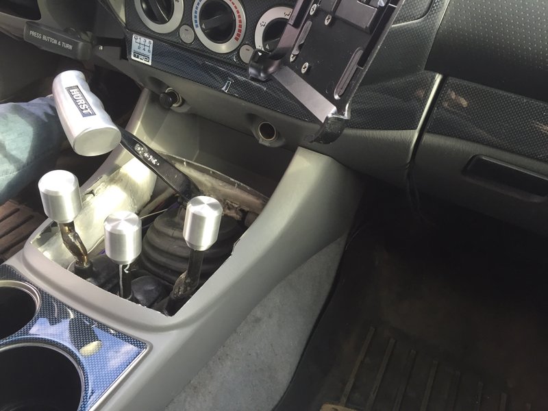

    I'm an idiot - I had the knobs reversed. It does not like to stay in low on the FJ case, 2 Wheel Drive and four-wheel-drive are not a problem.

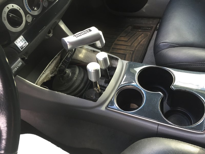

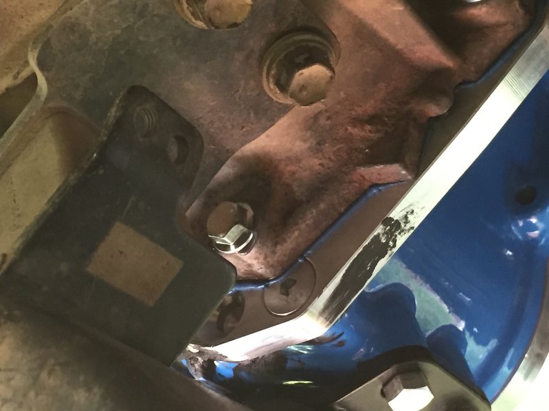

    Got the innards somewhat back together again:
    Fixed the worst of the oil leak too, there was an unused bolt hole that was the main culprit - I JB welded a bolt to it. :oops:
    There's still some minor seeping from the bottom of the crawl box I'll have to address later. :(
    It turns out that the FJ Case low range is just tricky to engage. Once I figured that out I was able to walk it around my house in compound low. :cool:

    Good stuff Craig! Put the crown shift boots in yet?
  20. Oct 25, 2015 at 2:42 PM
    #2400
    HomerTaco
    HomerTaco [OP] also HomerTaco Vendor
    Mar 28, 2010
    #34129
    45,874
    HomerTaco
    HomerTaco
    HomerTaco
    I have the triple shift boot just sitting in place for now. We need to do some minor adjustments on the FJ case H/L and the Crawl Box H/L for fitment so I figured I'd wait until that's done before finishing that piece off. Also won't do the finished shifter boots until it's all buttoned up right. :thumbsup:
