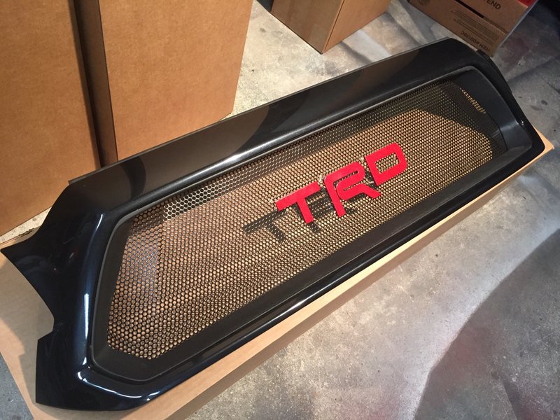

    Still leaky. :(
    Finished this today though:
