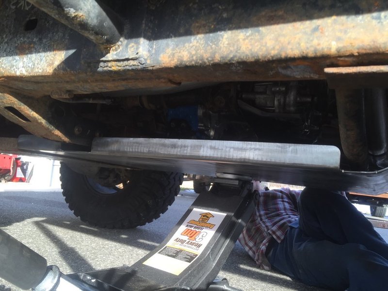

    Headed over to the land where they pump the gas for you today...

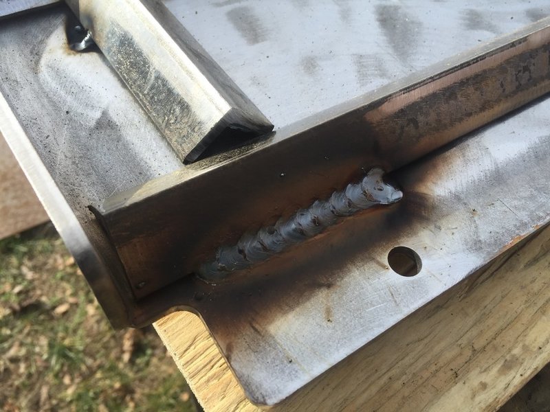

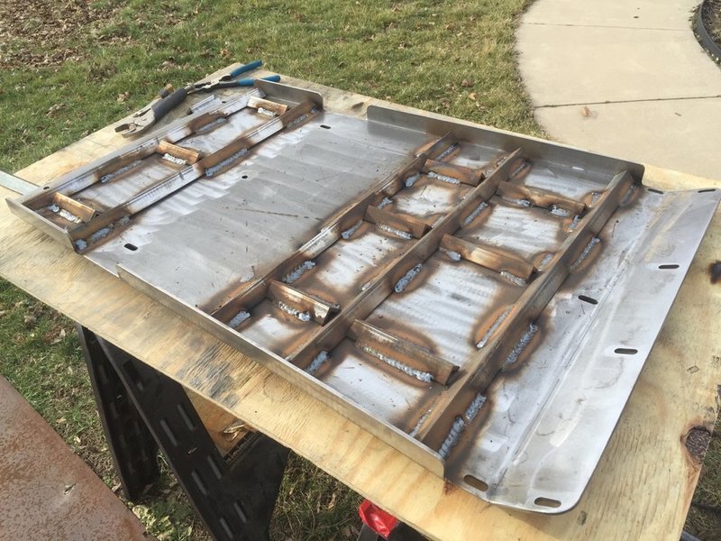

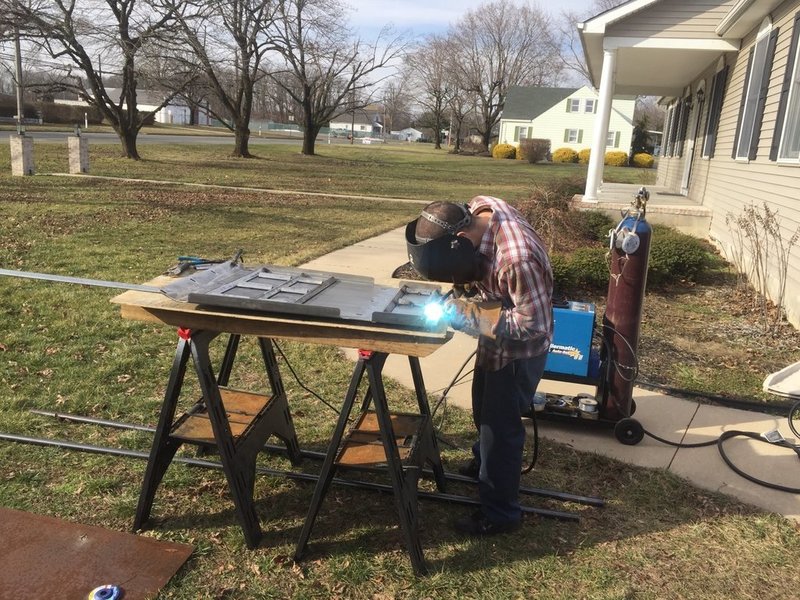

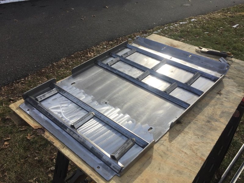

    The final piece for the crawlbox saga was to mount up the new extended BudBuilt t-case skid.
    Due to the fact this piece seemed to take the most abuse Ant recommended reinforcing it with some 1" angle iron. :cool:
    The man can fucking weld...
    stitch welds for days...
    fits.

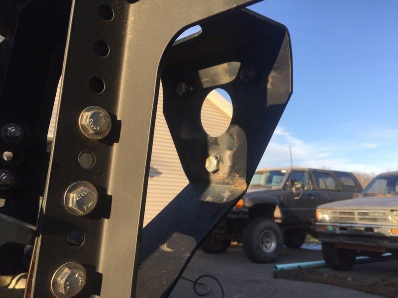

    Another small job: the CBI tire carrier used bolts that were not attached to the mount to hold the tire on. A real PITA because you needed a 3/4" wrench to hold them from behind to take the tire off. Ant tack welded them in place. Problem solved. :cool:

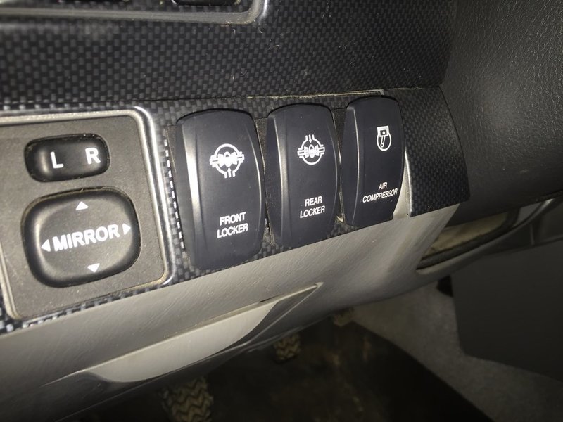

    One last small item: swapped out the locker switches to match the auto pilot switch from OTRATTW.
    dark:

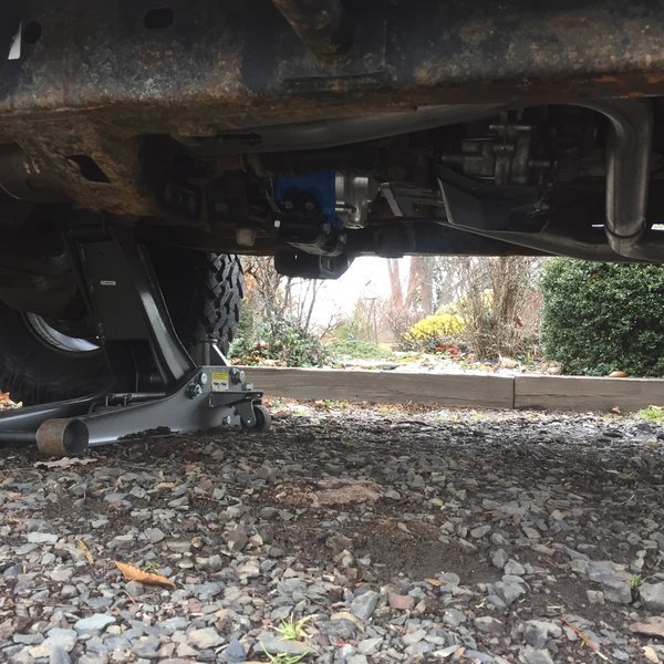

    I would seal up the ends of all those pieces of angle. Those crevices are just gonna pack with mud and never clean out. That skid will get even heavier.
    TacoFMS likes this.

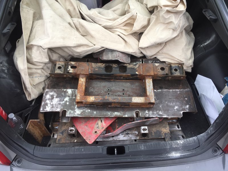

    I intend to. :D
    Dropped it all off to powder coat today:
    The poor little tC was sitting pretty low. :oops:
    The truck is now immobile:
    Almost there! :D

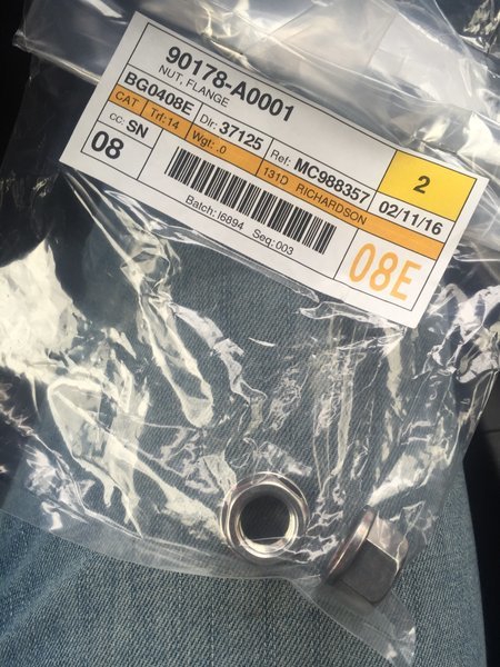

    One additional piece I picked up today:
    forgot to get these suckers when I picked up the LCA bolts. :oops:
    Ready to swap out those Moog "problem causer" pieces of shit.

    What brand are the new cam bolts? OEM? I need to swap my cam bolts soon.
