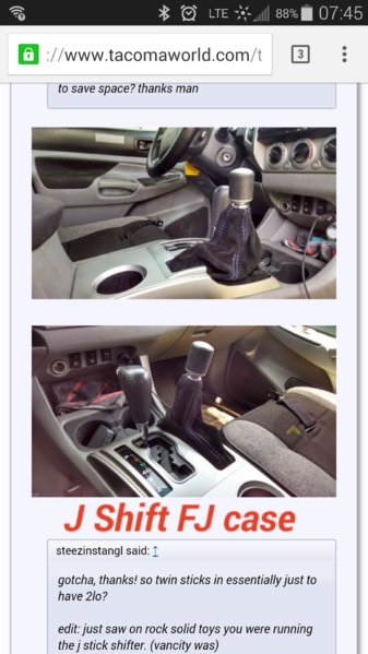

    Is there a way I could make the crawl box linkage come up thru the can cup holder on the manual transmission?
    If so then you could put the j shift in the shifter boot corner and then still have both cup holders.

    So if you are swapping transfer cases on an automatic tacoma with a FJ case is there any real logic behind doing twin sticks? Or is it merely the "cool" factor at that point?
    Also if not doing a twin stick is it just a simple swap (minus the wiring needed and extra hole in the cab) and nothing real "custom"?

    Twin sticks allow for the independent operation of high
    /low range and 2wd/4wd. With the standard J shift, low rangin only available in 4wd.

    From what I've seen the crawl box shifter is going to come up right behind the transmission shifter, so out the same opening. The J-shifter for the FJ transfer case is the question. Don't know which hole it's going to want to poke out of. :D

    Except mine is going to look like this.
    That's the crawl box shifter sticking through. The J-shift for the transfer case will be behind that somewhere.

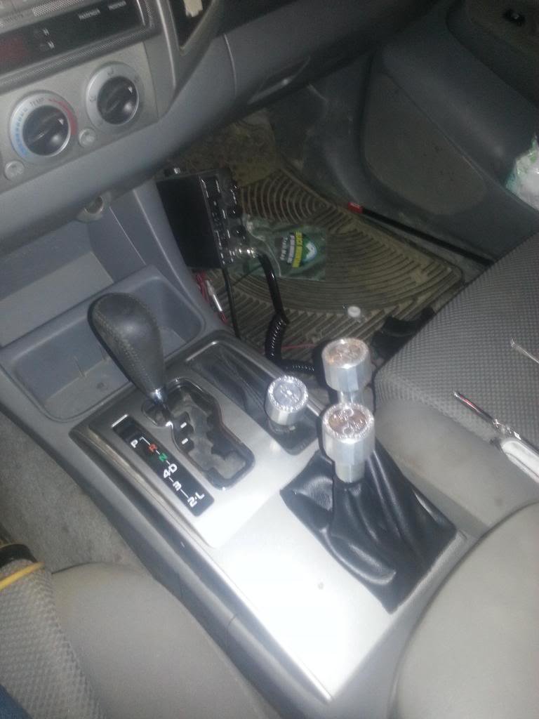

    Mine started making some weird ass noises then totally stopped working on me. And of all the threads I've seen ppl with 4wd problems they have no idea what actuator is broken and usually replace both LOL. With the FJ case it eliminates half the electronics, thereby eliminating half the failure modes of the crap 4wd system that toyota now makes. It's the soccer mom, text and 4wd on the go while eating mcdonalds kind of fucktards that have ruined the popularity of old school manual hub/transfer case vehicles. Unfortunately Toyota also drank the kool aid and tended to the market and left the old school 4x4 guys in the dust, but their designs for these systems are lacking reliability. The funny part is that most of the people that buy the trucks/SUVs for 4wd never use them as they are intended so if they see a blinking 4wd light they problably think everything is working fine.
    It's only a couple bolts and you grind one shift rail, only takes half a day. As long as you put everything back the way you found it there's really no way to mess it up.

    Here's what my crawlbox and stock FJ case looked like installed:
    Then here's the twin sticks:
