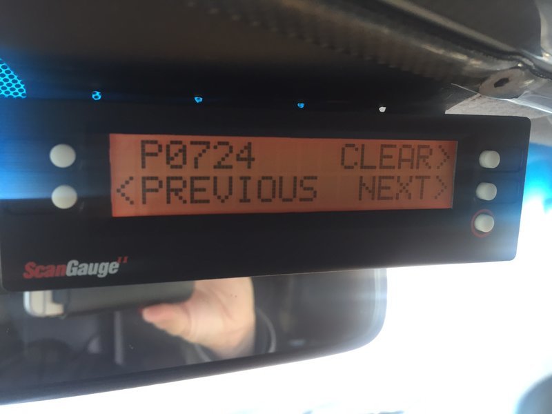

    Threw this code over the weekend...
    :confused:

    this:
    P0724 Torque Converter/Brake Switch B Circuit High

    Or just clear the code a few times & keep rolling... :headbang:

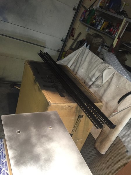

    My next mission was to finally solve the PrInSu Rack wind noise issue. I've got a bunch of odds & ends floating around the shop for this. I decided to approach the build like I did with the RTT Fairing. There were still leftovers from that build so I got started measuring.
    Here's the clear acrylic sheet cut to size & sitting in place:
    I had several L brackets for old shelving left over so I decided to modify them to use as the top mounts:
    A minute in the bench vice and I've got this:
    After a trip to Sears Hardware and $40 later I had all the stainless steel hardware and two 5' L pieces to make up the supporting frame. Here's the bottom piece mounted with the same 5/16 bolts as the rest of the rack hardware:
    For the sake of ease I used wing nuts on the top mounts. I could adjust them easier while messing with the fitment.
    After an intermission to drop of kids & then have dinner I cut the top cross bar to fit & held it in place to measure for the holes in the acrylic.
    Once I had this mocked up I drilled the holes and then fastened the sheet to the new frame with carriage bolts.
    Tough to see but I also fit some gasket material on the bottom to protect against hitting the roof.
    Here's the final result:
    The best part: It fucking works! :yay:
    I drove it at 65-70MPH and there was not a hint of the previous howl. :D
    Now to take it all apart & paint it. :oops:

    Disassembled for paint:
    I want to have this 100% done for Sundays Rausch run. :D
