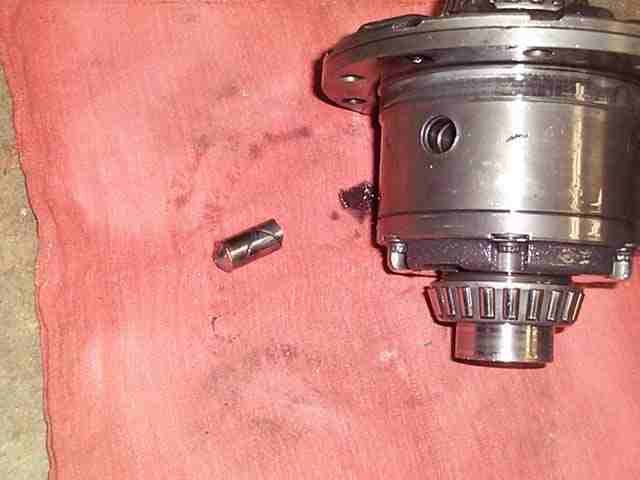

    the pinion flange is bolted to the splines on the back of the pinion, his driveshaft and pinion bearing looked fine.

    Exactly. No bang. No grinding. No noises at all. I put it in gear in 2wd and the driveshaft spins but the truck does not move at all.
    I locked the rear when starting one of the trails & a few folks told me that only one wheel was spinning...
    Have no clue what it is but it will have to wait until I've got time to wrench on it.
    Picking up my back-up 3rd tomorrow. It's 3.73 but I'll be able to move it & get the Pa inspection done. :notsure:

    The weirder part was the fact that you left for gas in 2 high and it just disappeared on you.

    Interesting Steve...
    I guess I really won't know until I pull the 3rd. I'm leaning towards a locker issue since there was no audible indication of catastrophic failure. Or any feel of one for that matter...

    Did some symptom trouble shooting, didnt think ARBs had this with their replacement carrier, but I guess they do. My best guess is that the solid pin that connects the two spider gears together has broken.
    Would be pretty silent and like most info online, the ARB unit is usually stronger than the R&P except this Solid pin.
    That's what I bet it is. R&P would spin all day and never move the truck.

    This is a visual explanation of what my father in law told me today.
    I think you and he may be correct.
