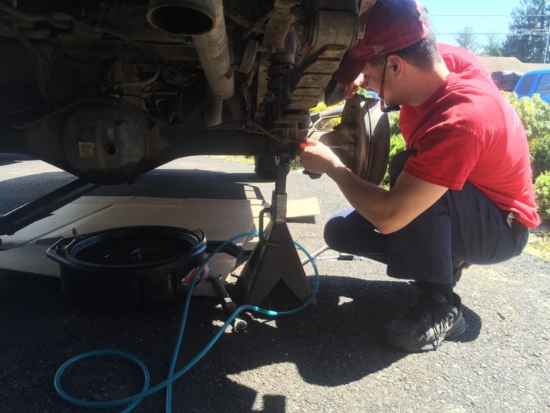

    So my fellow Gumballing Otter and wheeling partner in crime @PSU Taco85 made the trek to Pa today to help me try and get my bucket of bolts trail worthy again. :D
    Ive never pulled a third off a rear axle before but with the exception of a 24mm socket for the drain bolt I have plenty of tools for the job...
    The rear lost power on the highway driving from Rausch to go get gas. I ended up limping home in front wheel drive.
    When we got it all disassembled this is what we found:
    Drivers side axle shaft snapped cleanly at the shear point.
    Now it's a fun paperweight!
    I think I tweaked the fuck out of it on trail 20 and then whet I hit the gas to pass on the road it finally let go.
    The splines are noticeably twisted but the broken end slipped neatly out of the third.
    We cleaned up the third & reinstalled it. Conveniently, my father-in-law stopped by while we were in the process and said he'd track me down another axle shaft tomorrow. :cool:
    We also pulled the starter (which mysteriously was missing a mounting bolt) and replaced it with a new one.
    I'll likely just have Dads shop swap out the axle. After that I'll need to get the inspection up to date & an alignment.
    Should be good to go after that. :thumbsup:
    Many thanks again to Ant - I'd be still messing with it now without his help! :oops:
