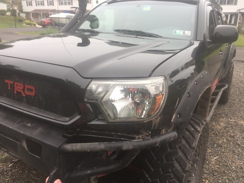

  16. Oct 1, 2016 at 5:09 PM
    #3156
    HomerTaco
    HomerTaco [OP] also HomerTaco Vendor
    Mar 28, 2010
    #34129
    45,875
    HomerTaco
    HomerTaco
    HomerTaco
    Hoods all whackadoodle again... :(
  17. Oct 1, 2016 at 5:37 PM
    #3157
    Evenflow
    Evenflow Well-Known Member
    Jul 15, 2013
    #108344
    5,774
    Jason
    San Diego, CA
    06' DCSB 4x4
    Yes
    Fender looks good at the a pillar and headlight, my guess is that the core wall is crying for mercy
  18. Oct 1, 2016 at 5:40 PM
    #3158
    HomerTaco
    Mar 28, 2010
    #34129
    45,875
    HomerTaco
    HomerTaco
    HomerTaco
    Probably :(
  19. Oct 1, 2016 at 5:54 PM
    #3159
    G.T.
    Jul 14, 2010
    #40169
    19,785
    G.T.
    CONUS
    Yikes, I'm watching out for that myself as I have a pair of group 35's in that front corner. I've seen some impressive gussets and braces made and am thinking about following suit just to keep that section from fatiguing earlier than necessary.
  20. Oct 1, 2016 at 5:59 PM
    #3160
    Evenflow
    Jul 15, 2013
    #108344
    5,774
    Jason
    San Diego, CA
    06' DCSB 4x4
    Yes
    The best thing you can do is get the weight off of the body completely, build a battery tray that ties into the frame rail. Pretty easy to run some tubing to the frame there.
