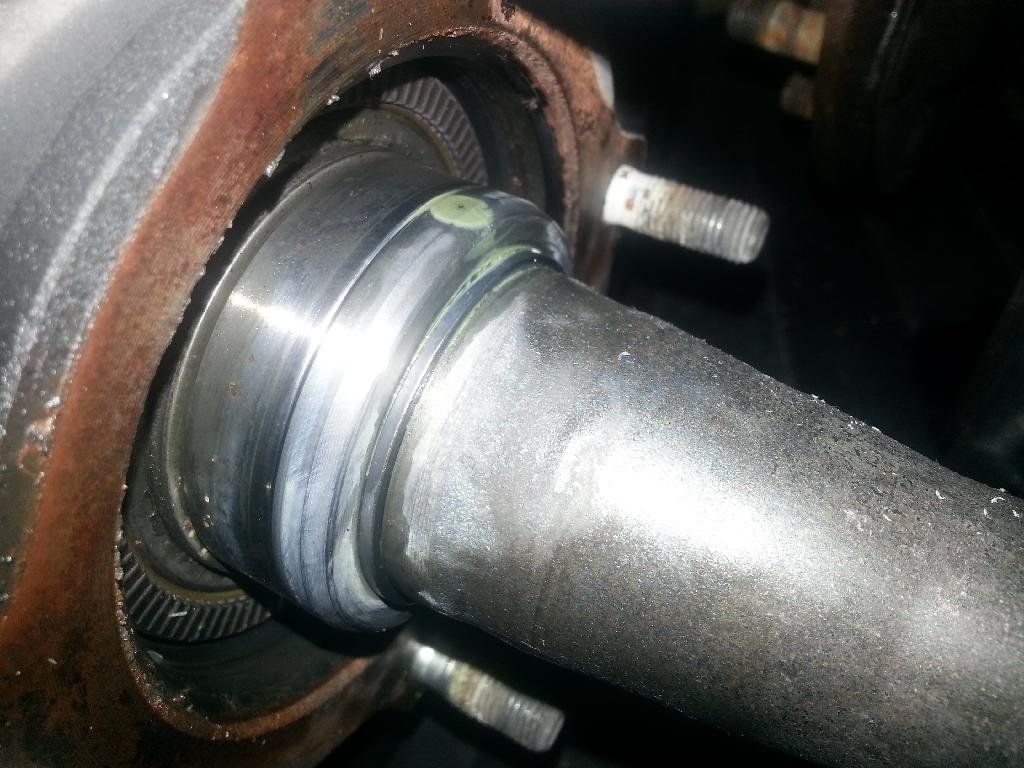

    I know the exact problem. The seal has worn a groove into the tapered bearing retainer. Now gear oil gets by, and soon will bebon your drum shoes.

    The worn is groove is directly behind the greenish drop.

    OEM rear bearings are ~$450, if I remember correctly. As long as that bearing is good, just replace the retainer and the seal.

    Bearing should be good. Need new seal

    Just be sure to inspect for that groove. A new seal alone won't work well or long if that groove is there. Plus, that is a cheap part as well.
    If it comes to it, that metal retainer has to be cut off, if you want to save the bearing. Otherwise they would normally be pressed off together.

    yup...notch that thing and crack it off with a hammer and chisel!

    Notch the retainer as much as you can with an angle grinder, then smack dead center of the notch with a chisel and hammer. Comes right off !
    Did my wheel bearings just like this. Be sure to take measurements of where the second retainer goes that the seal rides against.

    I think theirs is a little different from ours though. The photo @Torspd posted shows a ring with a c-clip in front and their ABS ring looks nothing like ours. Either way, that ring that @Torspd posted with the groove in it's placement is the most important in all of this.

    Good catch ! Agreed, getting in that groove is crucial.
