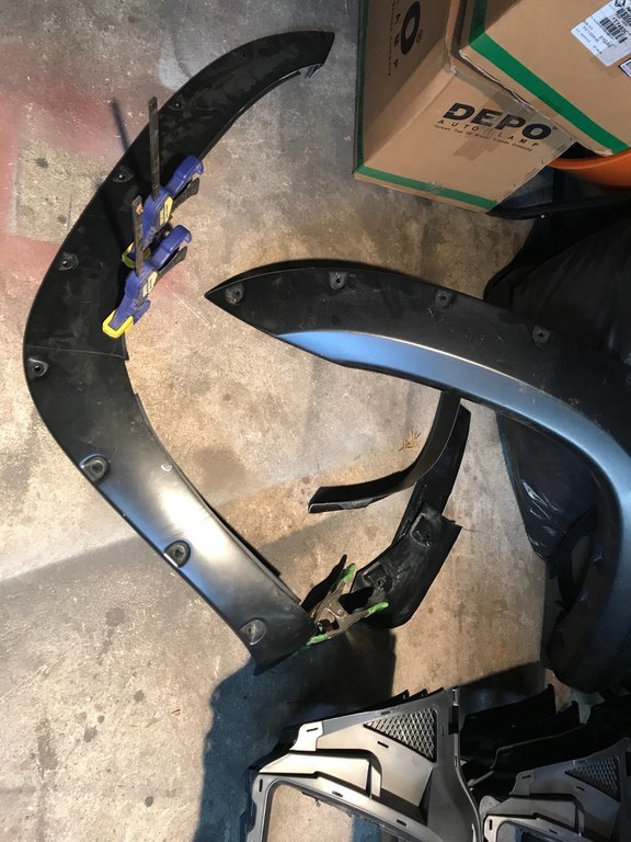

    One of the things on the truck has always been bothersome to me ever since I completed it: my custom fender flares.
    I was very pleased with the way they looked however, they were never very stout. I don’t make a practice of bouncing off of trees every time I go out in the woods but it seems that anytime I even rubbed one a little bit the flares would crack. It’s become pretty obvious to me that the process that I use on the grills works well because it is a small area that I am modifying. When I tried to use the same process on the much larger surface of a full fender flare it is simply not durable for flexible enough.

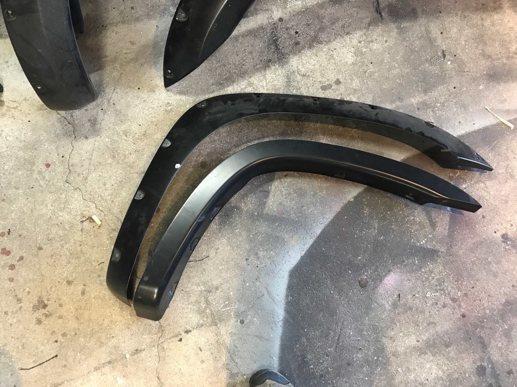

    I have had an extra set of Bushwacker Fender flares sitting in my shed for a few years. With everything else that is going on with the truck I decided to finally take the time to build another set that I intend to be much more sturdy.
    I haven’t gotten very far with that yet but here’s where I’m at:
    The flares.
    Passenger front cut:
    Backer pieces adhered:

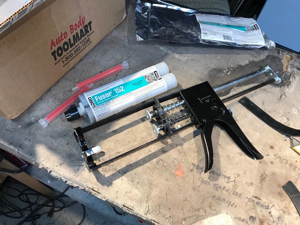

    I’m using a liquid nails product from HD called Fuze it to attach the backing pieces. This product has excellent adhesion to ABS and is relatively inexpensive compared to the smaller loctite 2part epoxy I used previously. Also, the Fuze it retains it’s flexibility once cured.
    For finishing I’ll be using this:
    Lord Products 152 fusor.
    My game plan here is to create a sectioned flare that is strong that I’ll also be able to have color matched to the truck.
