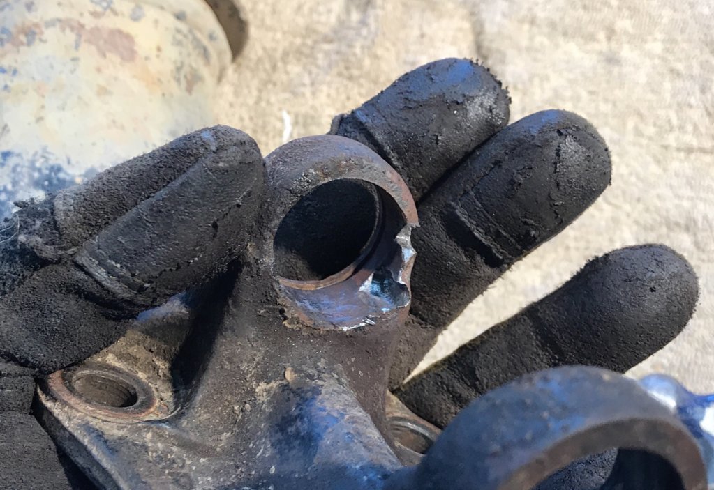

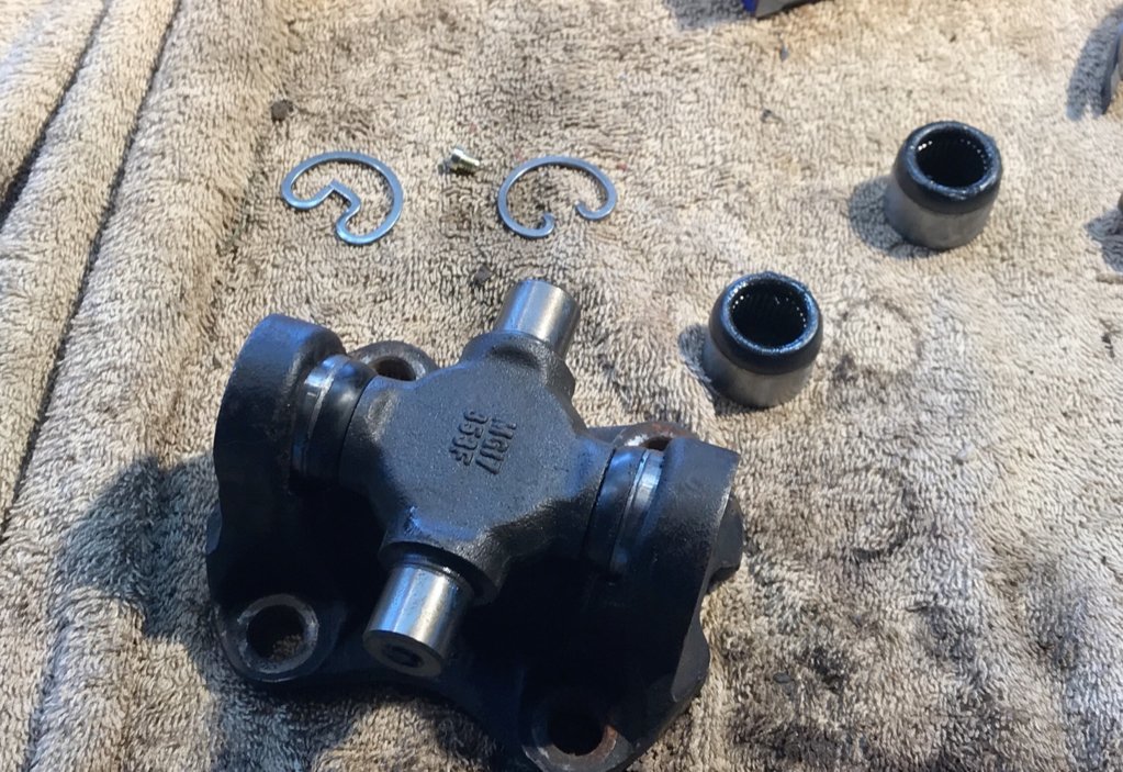

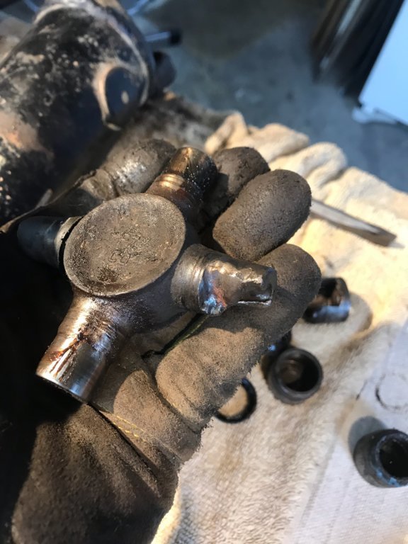

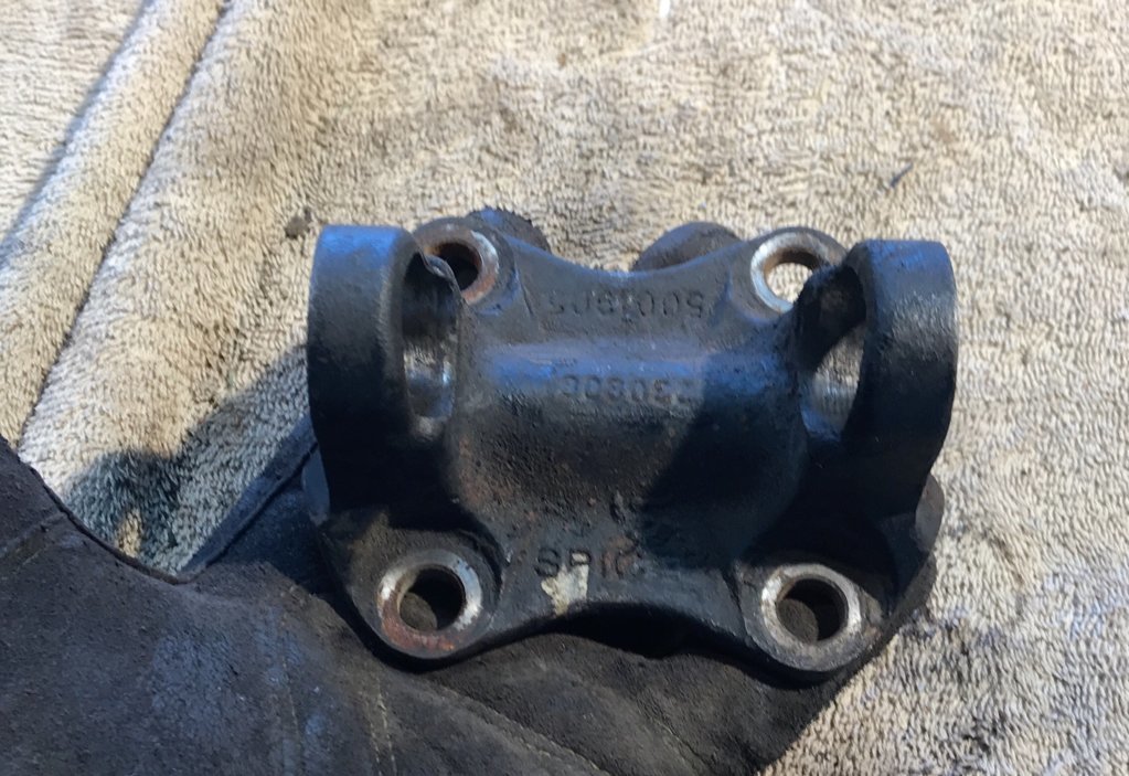

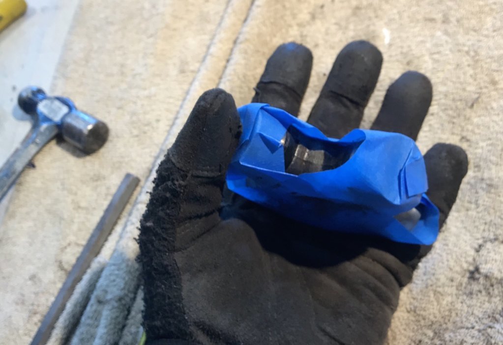

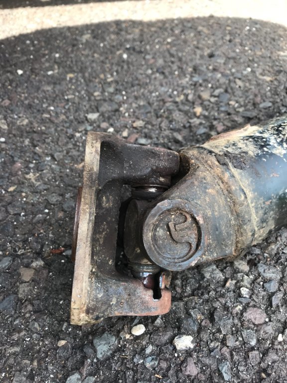

    Here’s a few pics of the cooked u-joint and the repair. I believe the cause was a missing zerk.
    First removed:
    Cooked
    Damaged the yoke
    Replacement yoke
    Now a spare
    New u joint:

    Yeah... I don't just break it, I have to royally fuck it in the process. :oops:

    No pictures however I got the driveshaft U joint finally installed and put the driveshaft back on the truck. I took it for test drive and everything seems to be completely fine now. I did have a heckuva time with the u joint because the first time I pressed it together one of the needle bearings came dislodged and would not allow me to seat the U joint completely in the yoke.

    My father in law recommended a trick: get some extra grease into the cups that hold the needle bearings to keep them in place when assembling the new u joint.
    I did this a second time without issue.
