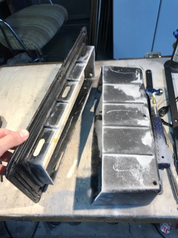

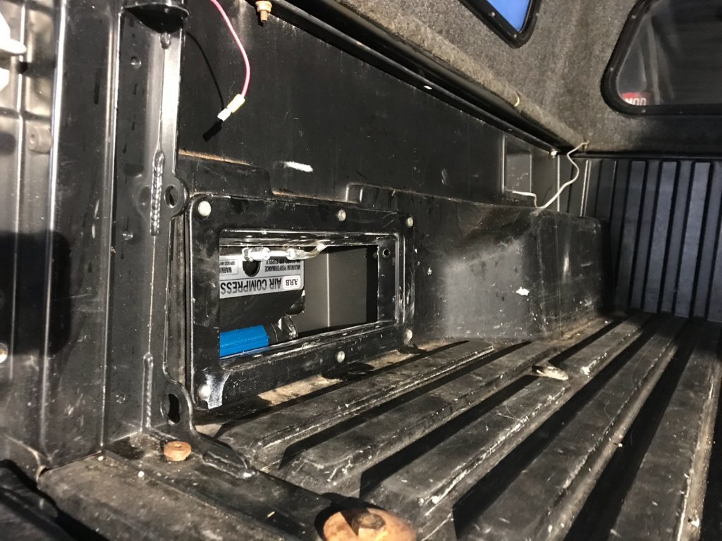

    Got the bed cubby & door set up now. Just need to run all the lines & im good. :)

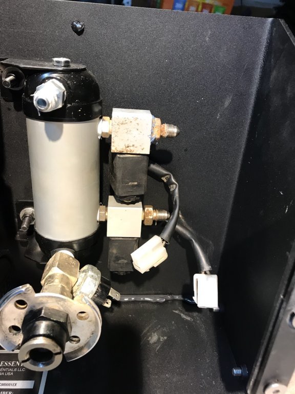

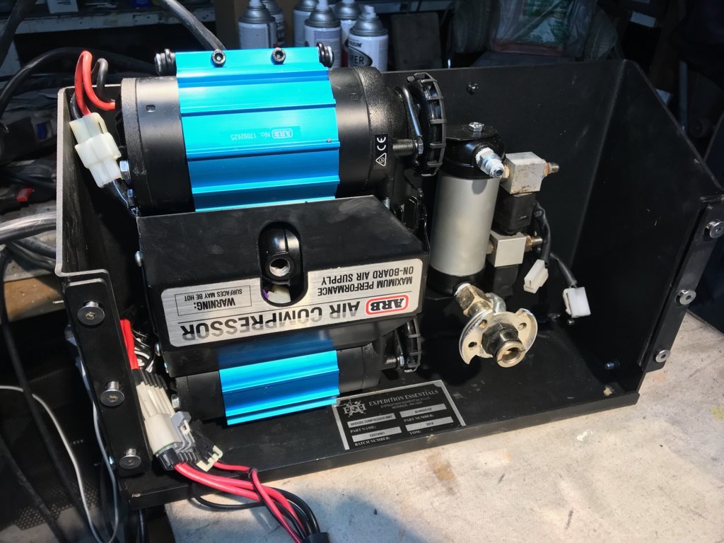

    One trip to the farm yesterday and my new compressors home was full of crap. :mad:
    Took it all apart & in the process of sealing it up.
    For the time being the vent will be opening the cubby door. I spent over $750 on this fucking setup and I refuse to allow it to get wrecked by debris.

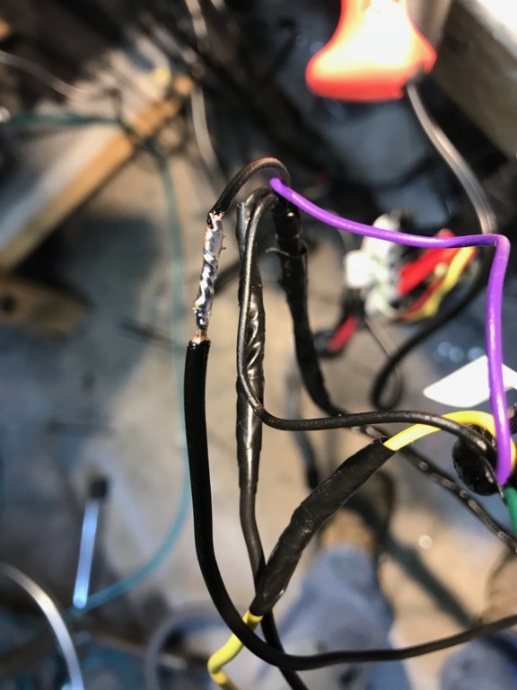

    Sat down this evening and actually figured out the wiring myself. I’m NOT a fan of automotive electrical at all but I am able to do it myself when I set my mind to it.
    I discovered the extended loom from EE does not include the 4 wires needed to activate the locker solenoids so I’ll need to extend them and piggyback on the power lines to the new mount in the bedside.
    Other than that one detail I’m very impressed with the quality of the product. Installation was pretty straightforward.

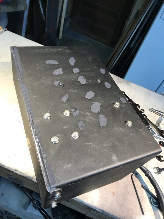

    Box sealed. Solenoids installed.
    Next comes wiring. Time to wrap this up.

    I’ll make a top myself out of aluminum for a cover. It doesn’t have to be really thick - I’ll bend it on the brake out of trim coil.

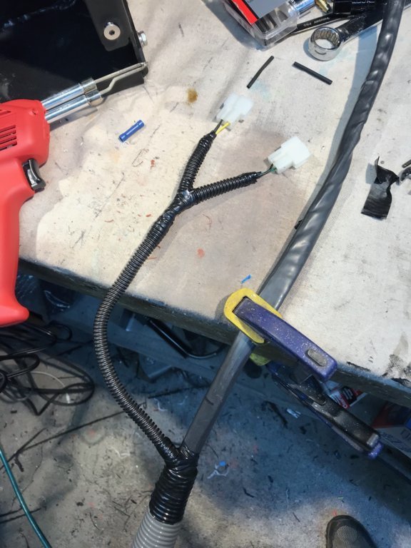

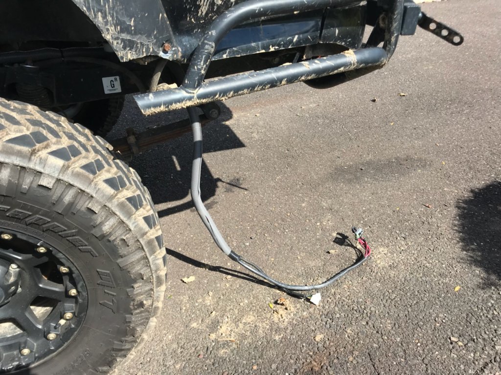

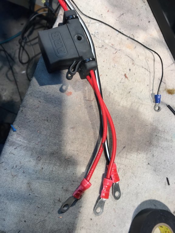

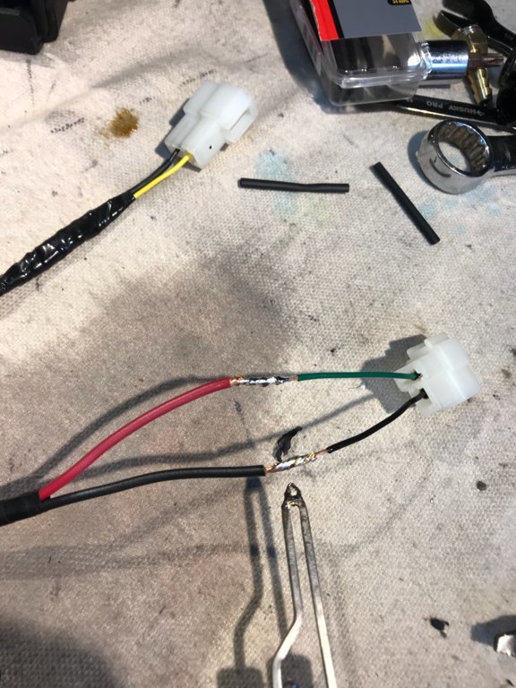

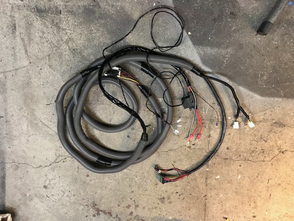

    HomerTaco
    HomerTaco
    HomerTaco

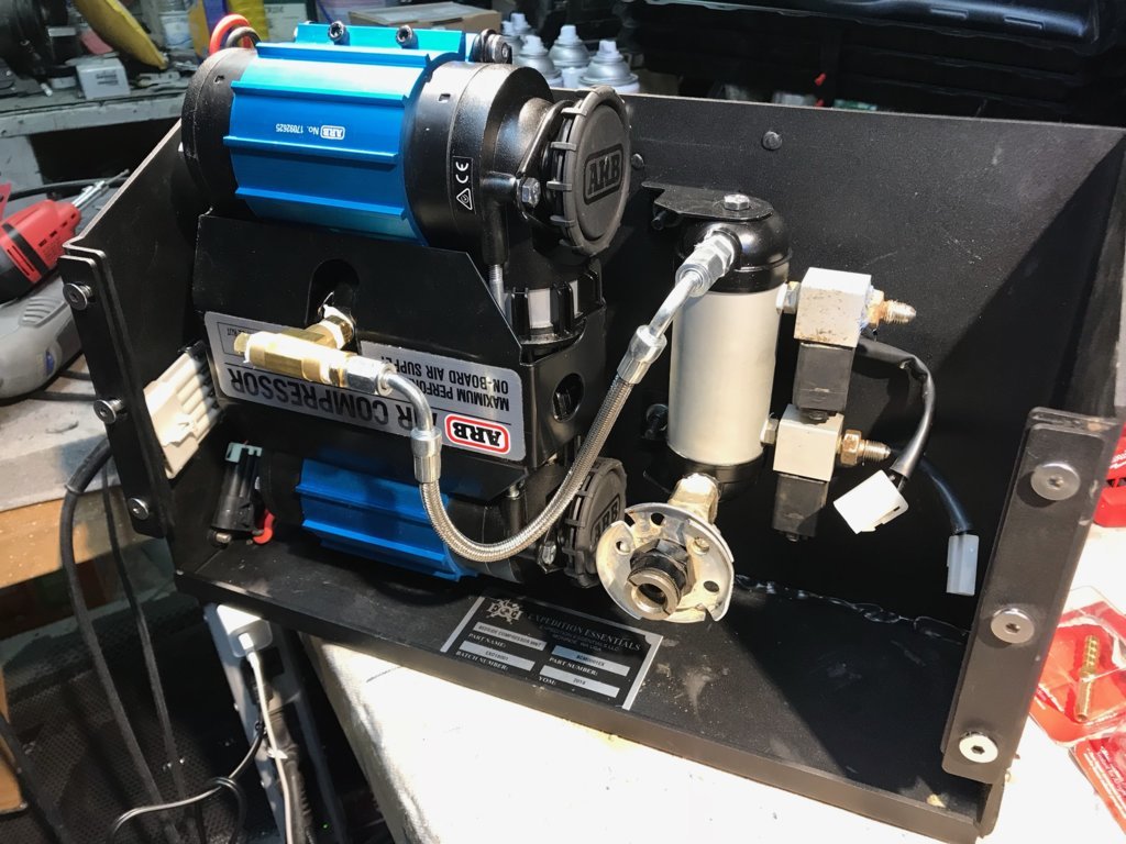

    Not quite done yet but further along in the process.
    Had to get a connection that sat a bit closer to the compressor to allow the cubby door to close. Got a T fitting and that did the trick.
    I ended up buying a bunch of shit I didn’t need but I did use a lot of it. One of my purchases was a new soldering iron.
    I am not very adept at automotive wiring but as long as I am on interrupted and completely concentrating on it I can do it successfully. :oops:
    Here’s the solenoid wires getting extended:
    Cleaned up the connections and protected all with wire loom:
    I also got the rest of the power leads ready to connect:
    Here’s the final product, a complete extended wire setup to run the length of the truck from the battery to the bed cubby:
    Took me about two hours to put the whole thing together. I added about 15’ of the gray wire loom and a couple smaller sections of black loom.
    Not professional by any means but hopefully this gets me back in business.
    :fingerscrossed:

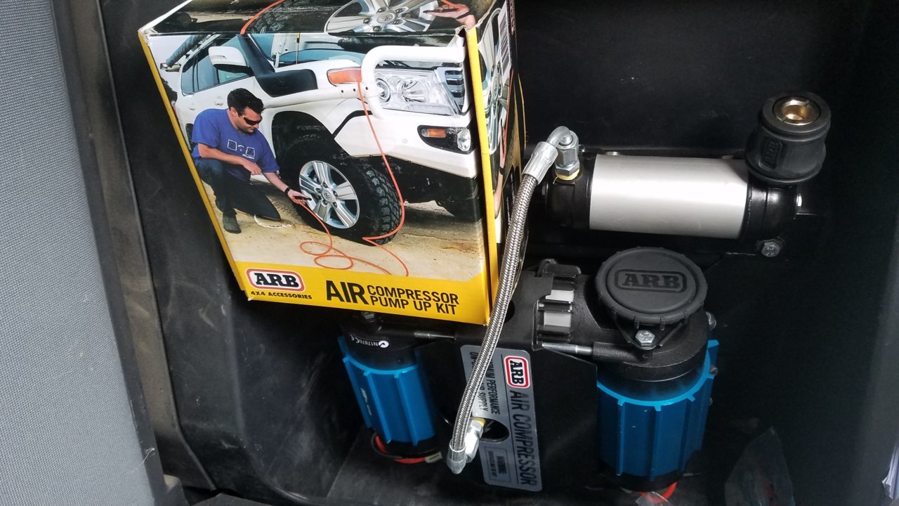

    I'm sure you have your reasons, but why did you install in the orientation that you did versus the orientation that Expedition Essentials advertises? Trying to learn as much as I can so I know what to expect if/when I get this system.
  17. Oct 16, 2018 at 9:21 AM
    #4377
    HomerTaco
    HomerTaco [OP] also HomerTaco Vendor
    Mar 28, 2010
    #34129
    45,874
    HomerTaco
    HomerTaco
    HomerTaco
    The “stock” setup from them seemed to me an inefficient use of the space. I wanted to fit everything in and enclose the box to prevent crap from getting in there...
  18. Oct 16, 2018 at 9:23 AM
    #4378
    PcBuilder14
    PcBuilder14 Well-Known Member
    Jun 19, 2011
    #58522
    23,312
    Brent
    Nor Cal
    2018 Tacoma TRD Off Road 4x4
    Oh, so setting everything up in the cubby the way they have pictured would not allow you to close the lid? Or does it leave the top open for debris to fall in from the wheel well?
  19. Oct 16, 2018 at 10:29 AM
    #4379
    HomerTaco
    Mar 28, 2010
    #34129
    45,874
    HomerTaco
    HomerTaco
    HomerTaco
    Leaves the top open. I could not close the lid because I needed a different fitting to connect the manifold to the compressor.
    PcBuilder14[QUOTED] likes this.
