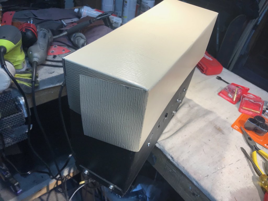

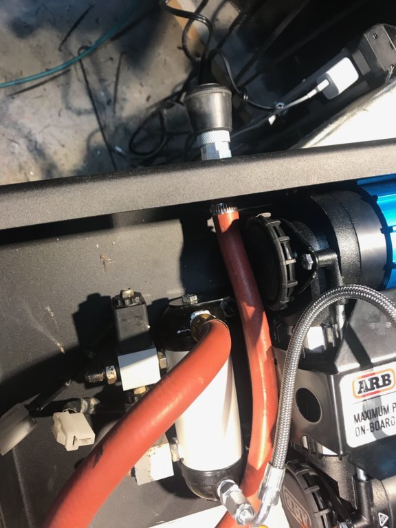

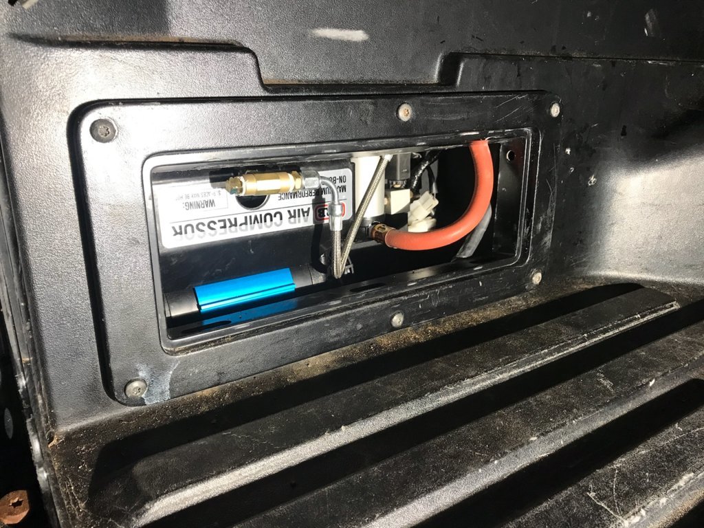

    I grabbed a piece of scrap aluminum trim coil and made a top for the box:

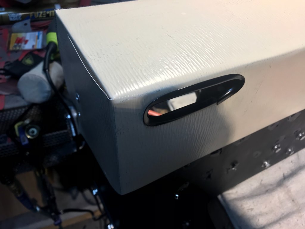

    Cut an access hole and trimmed it with door edge guard to protect the lines:
    Came up with a simple idea for running the air connection outside. I drilled a 1/2”hole through the bottom and connected a female hose adapter directly to the second manifold outlet:
    Somehow I actually managed to get the thing back in place and all screwed down by myself. :confused:
    I honestly thought I’d need a second hand considering how much @V5ioV and I wrestled with it the first time we installed it...
    Door still needs a bit of tweaking but for now it’ll do. :oops:

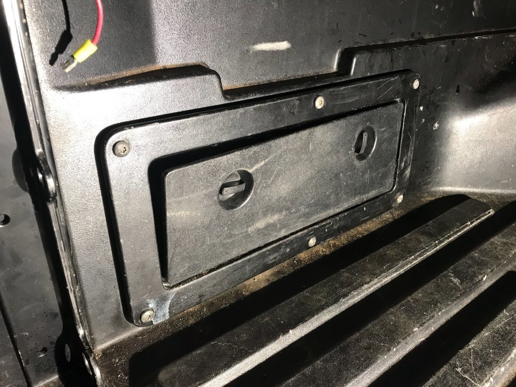

    Here’s the view of the bottom of the EE mount - it sits about 1” above the cut bedside and the air connection is now easily accessible from outside. :cool:
    The compressor runs as expected and the rear air locker line is connected but leaking. I need to spring for some new lines - the ends of the old ones are pretty corroded. :(

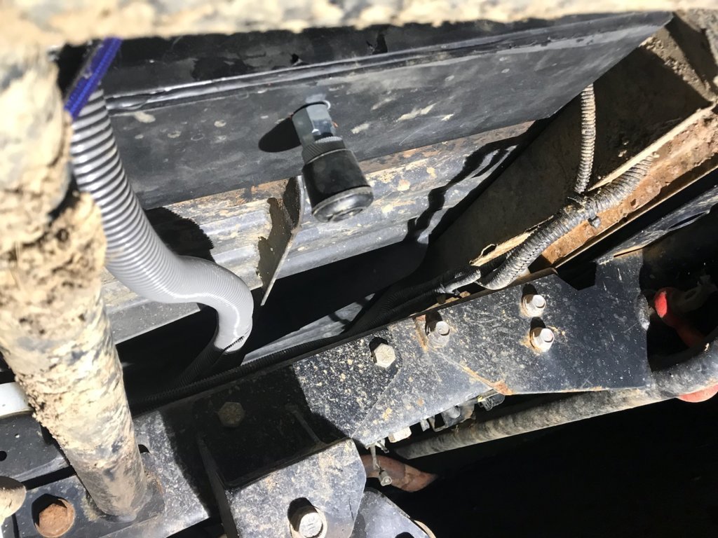

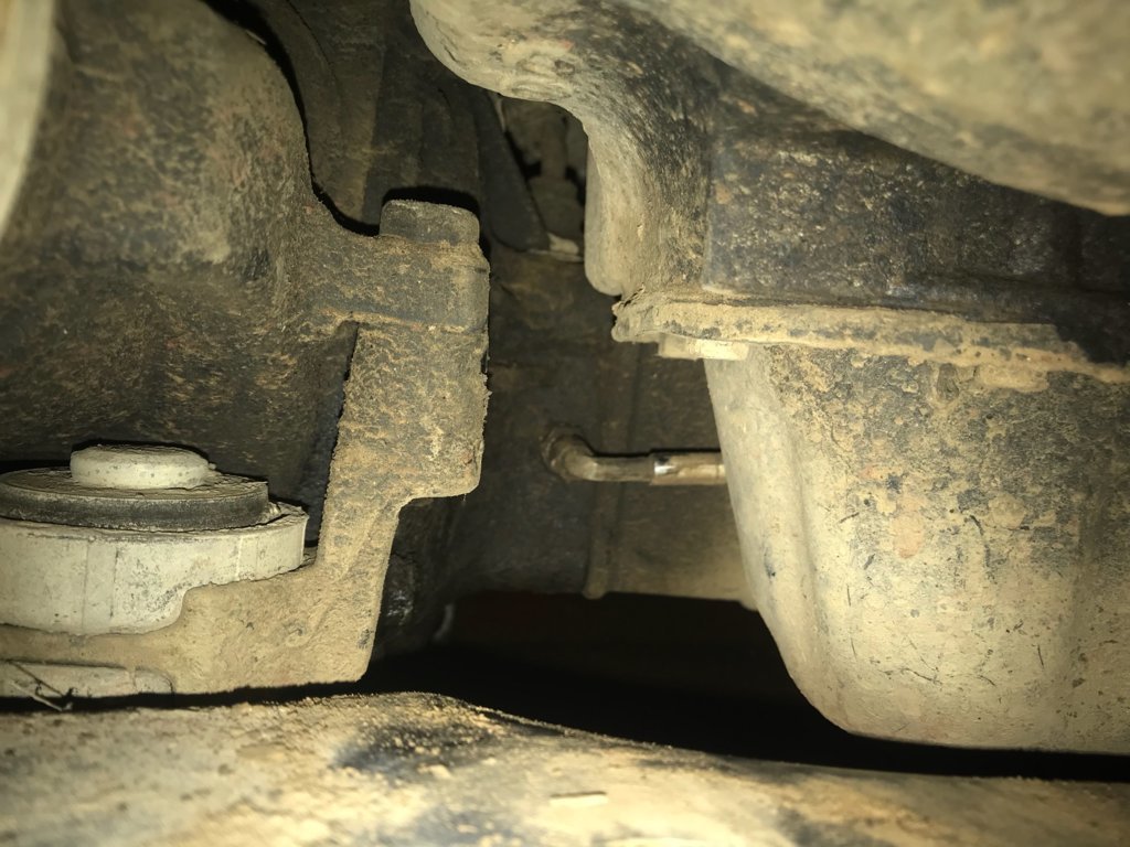

    The front one I may get away with just connecting a longer line to... the connection on the diff is not easily accessible with the skid still on:

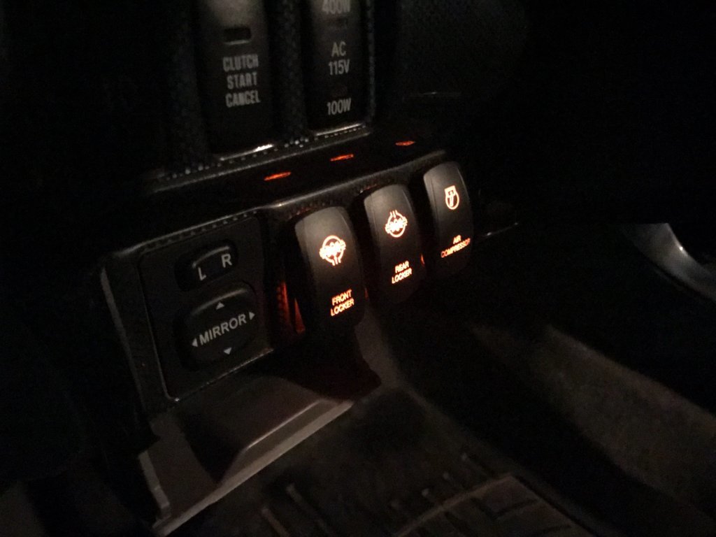

    Regardless of that, I’ve got functional OBA for the first time since like May and the rear locker will function if needed.
    Lit up like a Reno Saturday night!

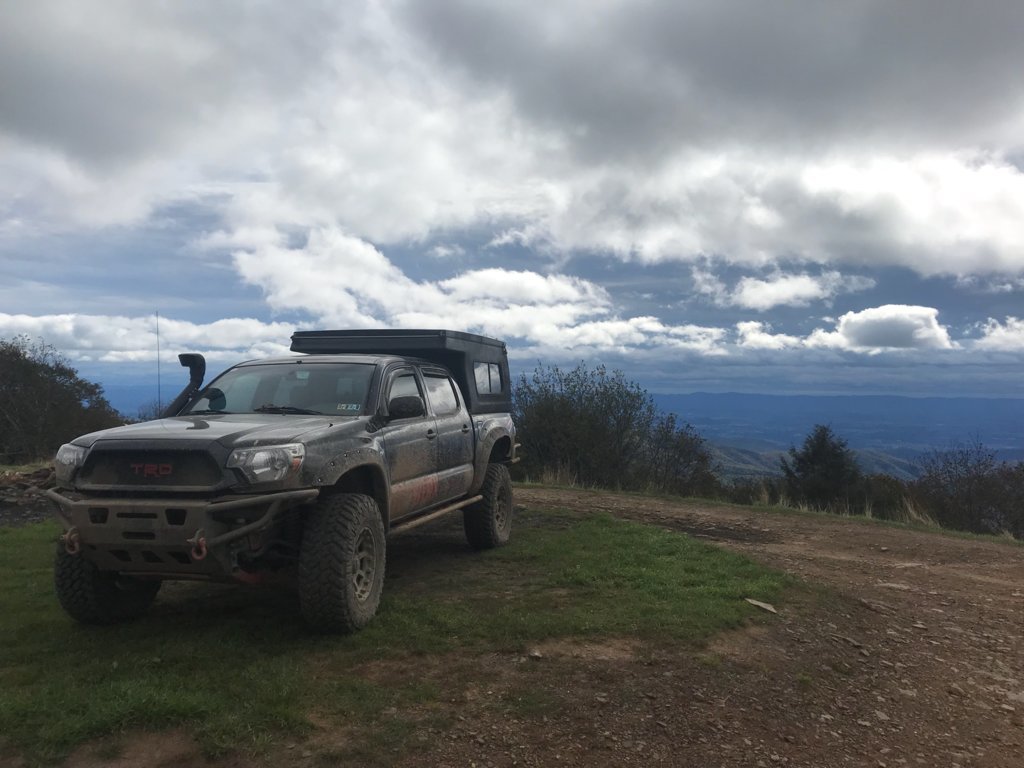

    Couple pics from this past weekend's trip to VA:

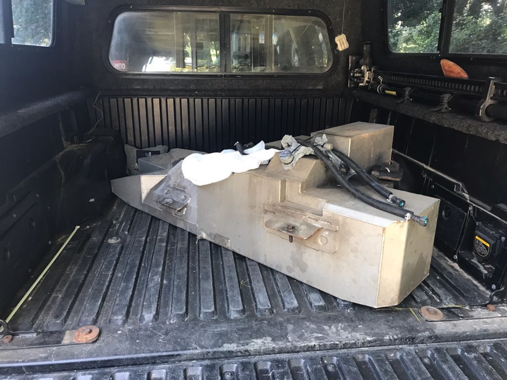

    Also picked this up on Sunday morning outside Charlotsville Va:
    Imported 34gal LRA fuel tank. :cool:
    Theoretically will have a 500 mile range on a single tank...
    not_nick, V5ioV, TinyTech626 and 7 others like this.

    The hover cam really lets you capture a lot of what you can't see from the top. Awesome shot Craig.
    steele-taco and HomerTaco[OP] like this.

    Wow, does that fit where the standard tank goes!?
  10. Oct 23, 2018 at 7:42 AM
    #4390
    HomerTaco
    HomerTaco [OP] also HomerTaco Vendor
    Mar 28, 2010
    #34129
    45,874
    HomerTaco
    HomerTaco
    HomerTaco
    Yes it does.

    Just got all caught up on your build thread...Love the flippac and you really did a great job with the electrical!
    I'm not sure if you tried this already to get that cubby door to close, but the next time you feel like taking it out, you can take off the compressor cover and rotate the compressor outlet a couple degrees and it might give you the clearance you need.
    Check out page 4 (PDF page 6) of the instructions.
    https://www.4wd.com/sku/ARB 4x4 Accessories/standard/CKMTA12.pdf

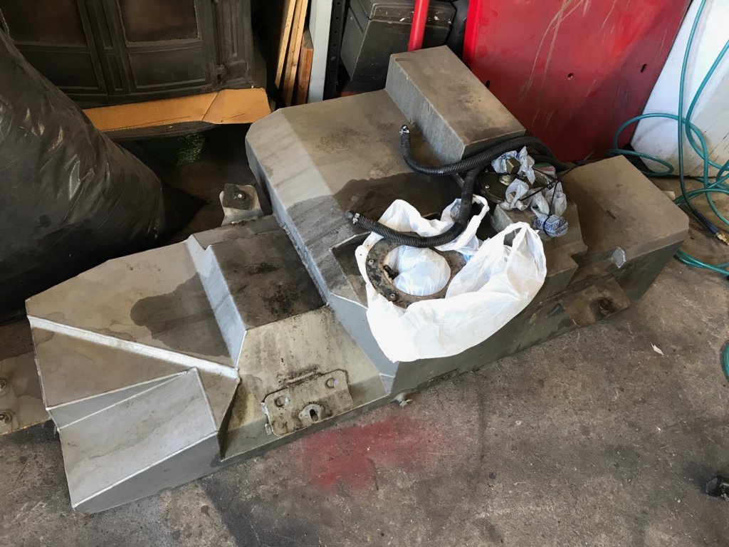

    Took a few minutes to degrease the LRA Tank. I hate trying to install dirty parts.
    Used some “purple lightning” 50/50 mix with water.
    Pretty pleased with the results.
    During:
    After:
    I believe I’ve got everything I need to get it installed now. May give it a shot this weekend. :notsure:
