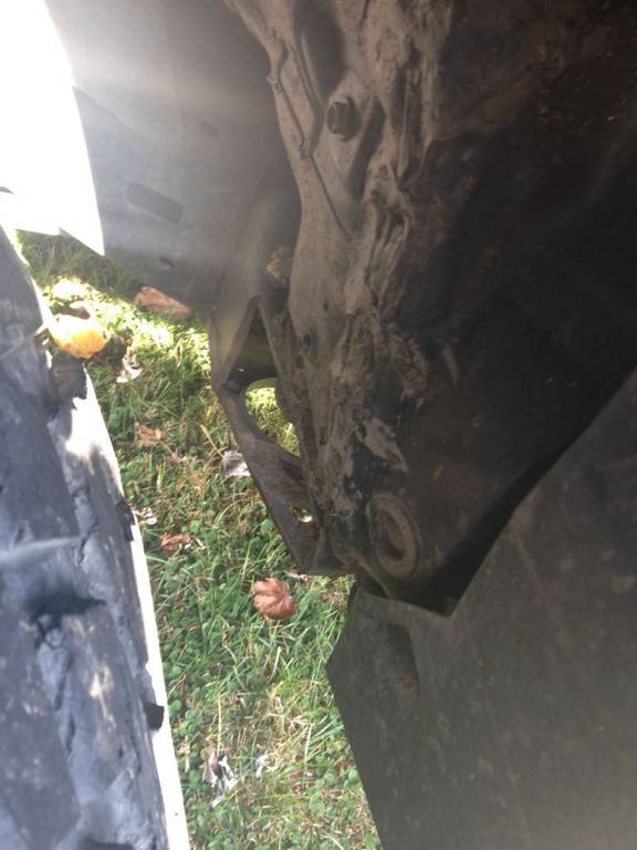

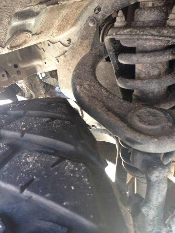

    my CMC as I did it for the 295's:
    Major rub even before full lock.:(
    Started in with the spark making tool & took this off both sides:
    (just under 1/2" off both sides)

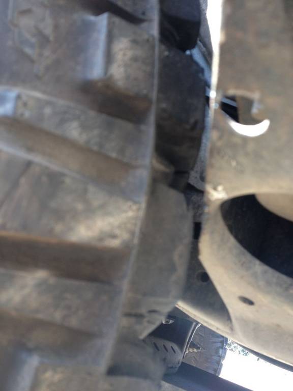

    Now at full lock:
    Got a 1/4" to spare. :eek:
    Serious offset wheels so the UCA's are no issue :cool:

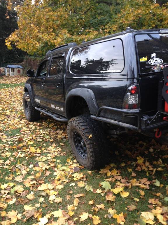

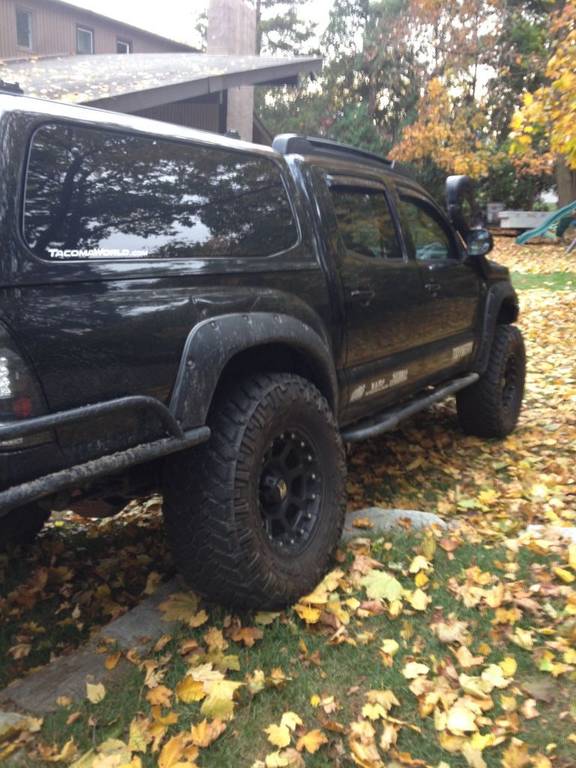

    It's no ramp but a little wall in my backyard to just flex the rear a bit for the hell of it:
    Happy to report that it handles excellent on the highway @ 70mph and 2650rpms :yay:
    Honestly brought the performance back to as close to stock as it has been since I sized up to 295's with no re gear. :eek:
    Now to make it trail worthy with these suckers... :drevil:
