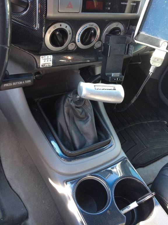

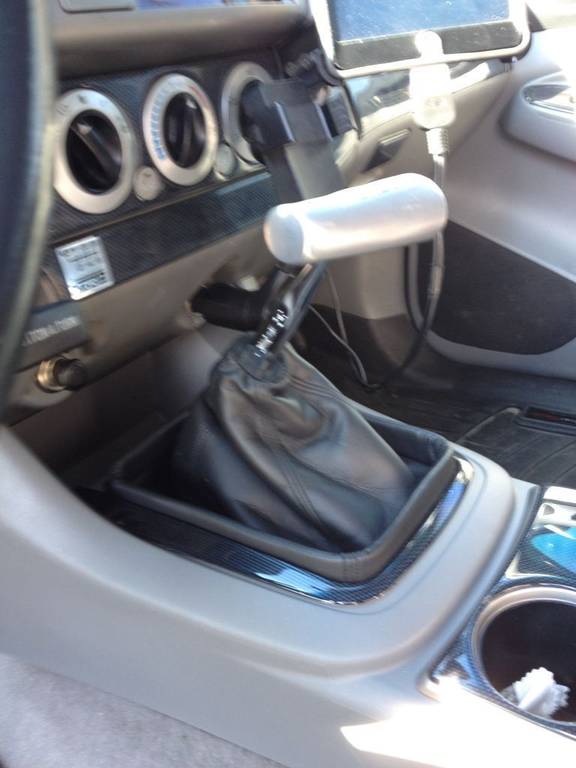

    I took a couple hours today and got the Core/Hurst short shifter installed today. Once the new assembly was in it was very tough to get the front center console section back in place.
    Once I got it in I found I was hitting the back of the shifter surround when trying to engage 1st,3rd, and 5th gear.
    I took all the carbon fiber trim pieces off and trimmed about 1/2" off the back of the opening. I then put the trim back onto cover the gap left in the front.
    For the stick itself, I mounted it on the left side of the assembly instead of the right side as intended. I also used 1/2" longer bolts and put about 5/16" worth of a spacer in between. This effectively moved the stick over 1" toward the drivers side, hopefully freeing up enough space to do a triple stick for the crawlbox and T-Case.
    I also did some digging and found my old Hurst T-handle shift knob! :yay:
    This thing was in both my 87' and 99' at one point in time. :cool:
    The miracle of the day was actually finding the adapter nut for the handle that worked with the Core stick as the threads are much smaller than the stock Toyota ones.
    I was in the zone so I did not take any shots while I was doing it but here is the result:
    The throw is very similar to that of the URD kit that I have had in since I purchased the truck.
    Very pleased with the look & feel of this new shifter. :thumbsup:

    Here's the final shot with the other trim piece back on.
    There's now a 1/2" gap between the two close to the cup holders

    New shifter is louder - can hear the trans more - nothing that jacking up the volume on the stereo don't fix. :eek:
    I really like the new shifter feel too.
