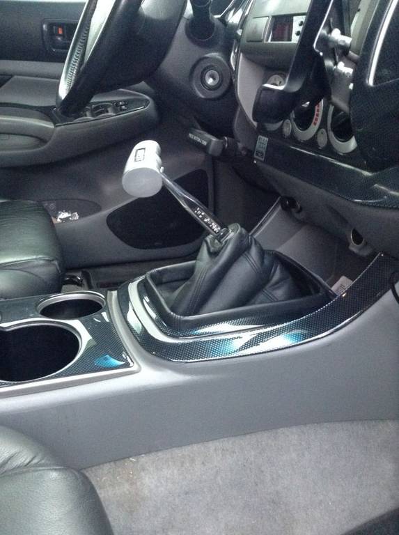

    Take A picture from the side like this with the shifter in 2-4 or 6th gear.
    Looks like a lot of room to work with there :D

    I thought so too.
    Here you go Mark:
    This is in 6th.

    Looks like plenty of room to me, as long as there's nothing in the way under the console shouldn't be a problem! :)

    I thought so too. The only things hidden under there are a few wires - easily relocated.
