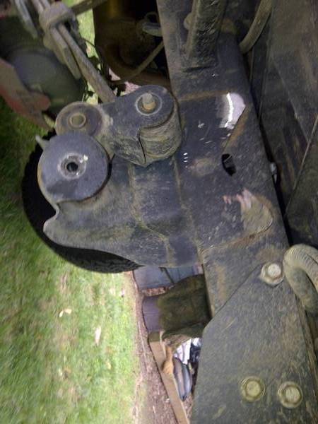

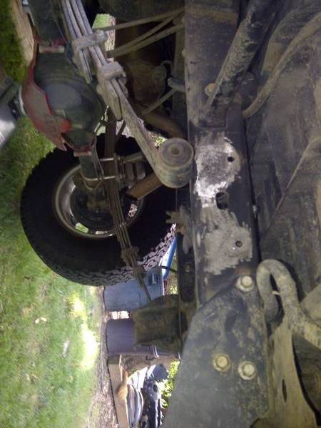

    I've spoken with a lot of members about the Shackle Flip mod (SFM) and have done a lot of research...
    This is just one part of the mod process - I still have to get longer shocks and get extended rear brake lines. (both of which i hope to have by next Friday)
    The SFM Kit that I used was built by Kevin at ATO. He currently does not have them in production, I was able to purchase this kit from another TW member who bought it but never installed it.
    I spoke with Kevin about what setup I was running and he was kind enough to email me a PDF. with the complete install instructions.
    As indicated by these instructions the hardest part of the entire install was the removal of the stock shackle hanger. I used an angle grinder to take off the heads but for the life of me I could not hammer them out with a punch as described.
    I ended up just drilling them out completely.:eek:
    Here you can see the stock hanger removed. I took a grinding wheel & removed some surface rust and then put a couple of coats of flat black over it.

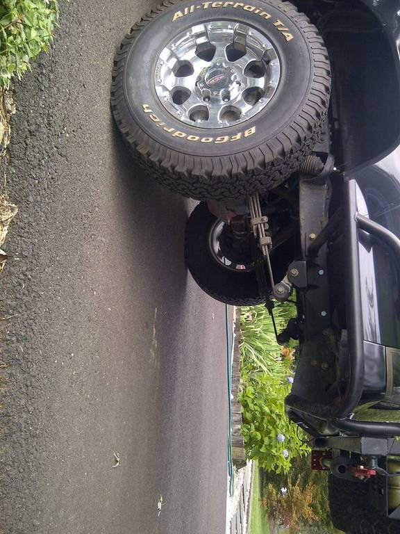

    Here is the completed SFM:
    I ran out of time today to measure for the new shocks - that will happen tomorrow.

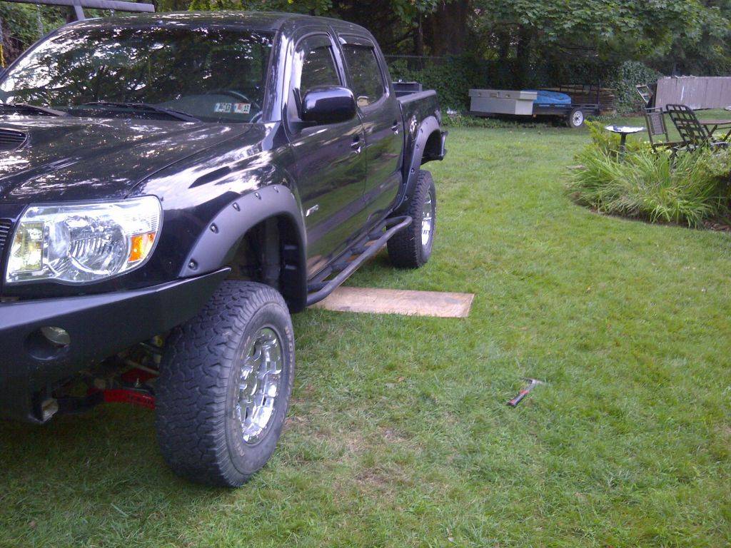

    I took it off to get the bedside painted.... Unfortunately Bonnie's van got hit two weeks ago and the van took my trucks appt at the body shop.:(
    It will go back on once its fixed. :cool:

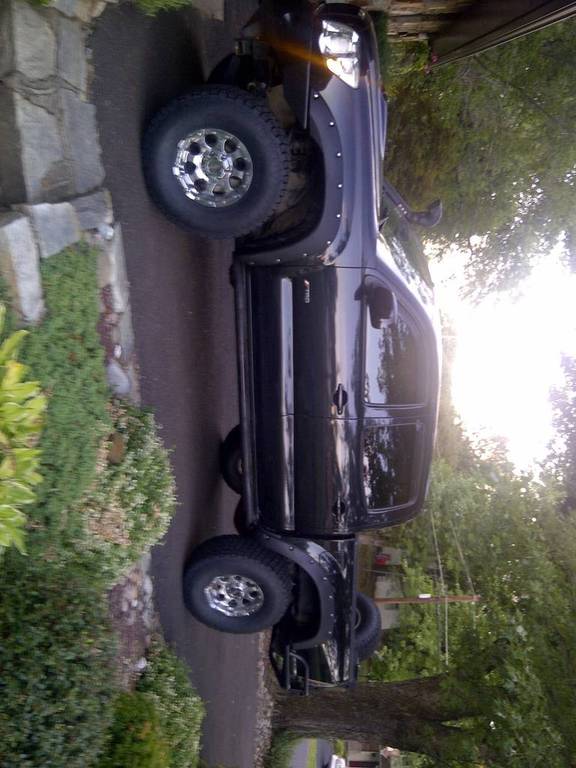

    From the fender flare thread...
    Passenger side begins tomorrow... :cool:

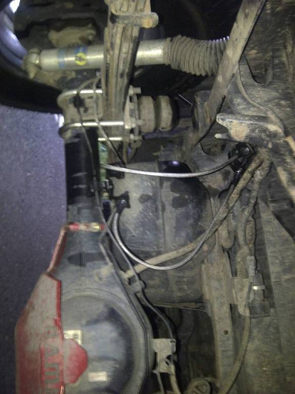

    Got the new larger tires today....
    Also had the shop install my 23" brake lines from Low Range Off-Road:
    Much needed due to the increased down-travel with the ATO Shackle Flip.
    Next is the B110 Billy 5100's - They should be here tomorrow...
    Still have to figure out how to limit the up-travel a bit as to not bottom out these new billies...
