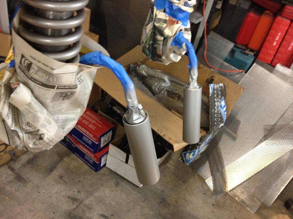

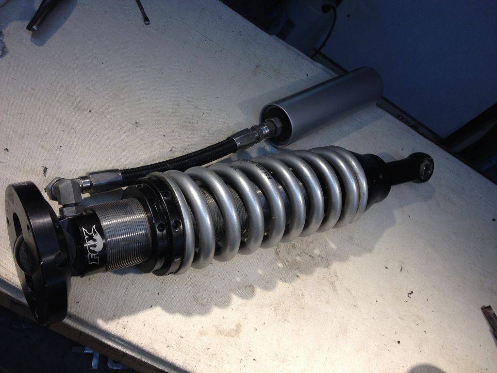

    I'm going to clear coat the bare metal on the threads of the coils but the resi's were pretty corroded too. I took a wire wheel dremmel bit to them and then so e 600 grit paper. Doused them with surface prep and rattle canned them the same metallic gray as the coil springs.
    I'll get Conor to make me a set of a Fox stickers for them before I install them. :D

    Damn! Looks like new! Very impressive!

    Honestly Mark, the results of the metal rescue were beyond my expectations. 8 hours of soak and about 5 min with a small wire brush and they look near new! :D
