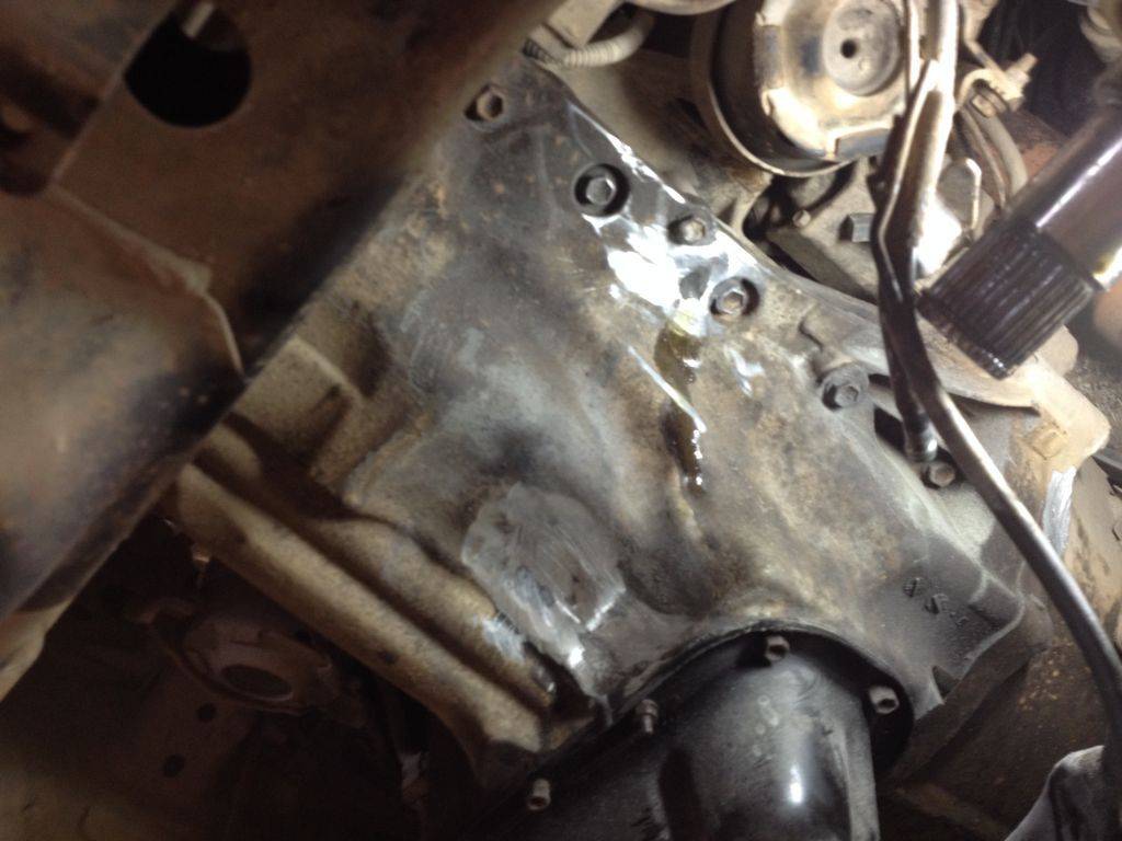

    The broken loop on the diff collar is not the main problem. As far as welding it, it's being done by a local heavy machinery shop that knows what they are doing.
    This is the issue:
    The pan is shot. The trail repair got me home but there is still a dime sized hole in that pan. As you can see it was not a 100% cure as it is seeping even with all the oil removed.
    It got me home - that's the important part. :thumbsup:
    Sourcing a new pan now. Unforutunately my chances of making the meet have gone from very slim to none. :(

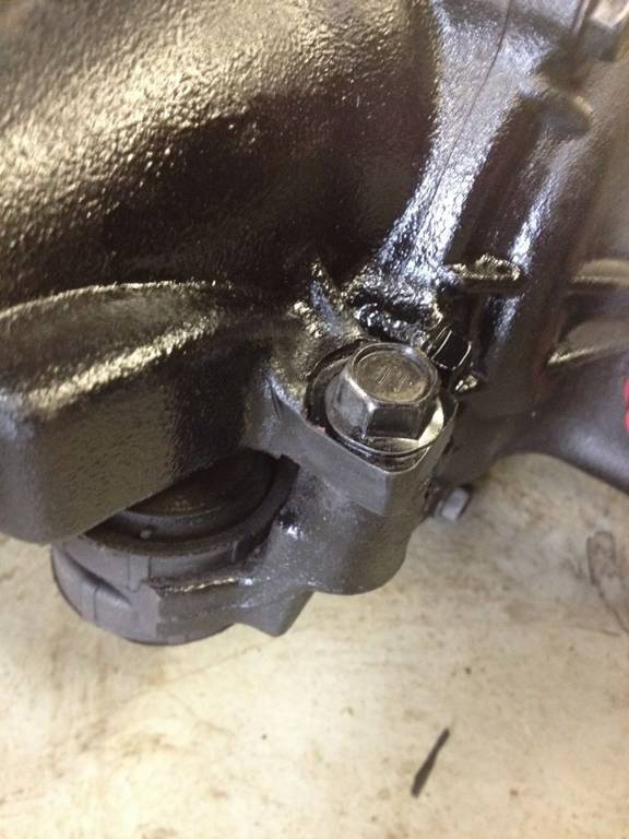

    Diff mount repaired:
