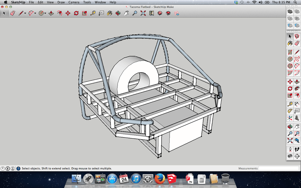

    Oh, and here's why I'm not worrying about the bed.

    Yeah - forgot that you were going that route. Been watching that since Colin did those fender pieces. No need for 6 extra pucks & bolts then! :laughing:

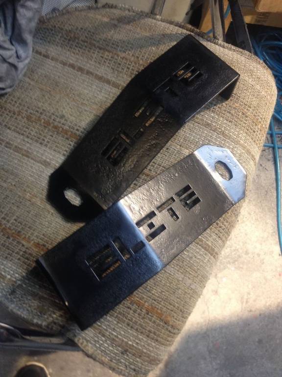

    From my last batch that went to powder coat:
    The side support/reinforcement brackets for my front bumper. Jerry & I had to delete them when we did the suspension upgrade in August so I just left them off. They were really rusty. I took a flap wheel to them and then just threw them in to get coated. I just need a little spacer to reinstall them over the resi support.

    JLink
    JLink Well-Known Member
    May 9, 2010
    #36795
    12,582
    Josh
    Ocean, NJ
    Lifted, Locked, Armored. Ready To Wheel.
    I can send you a pic of how mine are mounted. We should have the same resi mounts. I'm pretty sure I hammered out the dimple on the resi mount bracket and just bolted the elite bracket over it.

    HomerTaco
    HomerTaco [OP] also HomerTaco Vendor
    Mar 28, 2010
    #34129
    45,875
    HomerTaco
    HomerTaco
    HomerTaco
    Yeah - I thought that would work. Pretty sure the bolt is plenty long enough.
