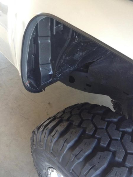

    My issue with 37's is the sheer amount of demo I'll have to do to make it work.
    Obviously I have no issues cutting up my truck but I really like the way it looks now too.
    I like the idea of having a huge selection of tires too - 37's are available in a ton of different patterns. I love the nitto trails but the fuckers are heavy as hell.
    I'd go with a Hankook Dynapro M/T probably - less expensive and way lighter that the nittos.
    Think we could tub out the front end in a weekend Ant? :p

    I did a small amount of tubbing on mine, and was stressed to the max!! It turned out just fine, and I wouldn't hesitate to do it again. You should do it the same time you do the body mount (-;
    Just take your time. I think it took us around 5hrs but that was while fabricating the mounts.

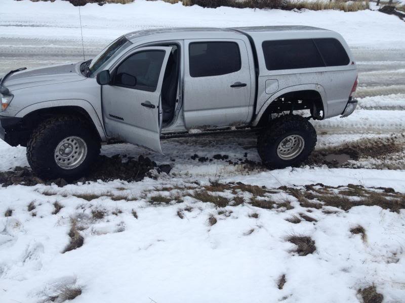

    Thought you were running 36's Shawn?

    Yes sir I am
    I have room for 37's easily and wish I did so. I waiting for a full crawl box write up so I can copy you (-;
    the tires in the picture was the old 305's. Heres 36 Iroks stuffed

    Mark (NWITaco) posted some pics of his fender well work back on pg. 68 IIR.
    He had LT though which moves the front wheel hub forward another 1" which helps.
