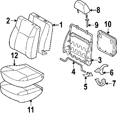

    I am almost done with my leather install! but I do have the fold flat seat - any idea how to remove the plastic backing on it?

    I recall that being kind of troublesome. I think I just pryed it off from the bottom. I might have broken one of the tabs that hold it on at the bottom, but there was still enough left to hold it in when I popped it back together.
    Here is the best pic I can find (part #10):
    There are 3 plastic rivet/clips along the bottom, then two bigger "hooks" that hook in towards the top. Carefully pop the bottom three clips free...I think the clips actually hook in from the bottom, so you need to push the whole panel upward about 1/2" or so to unhook them. Once the bottom is loose, slide the whole panel downward and it should come off.

    yep, pull stright up on the bottom hard as you can, it's two plastic pieces that hold on everything like your door panel, etc... DO NOT PULL ON THE TOP, you'll see why once you've pulled it off
