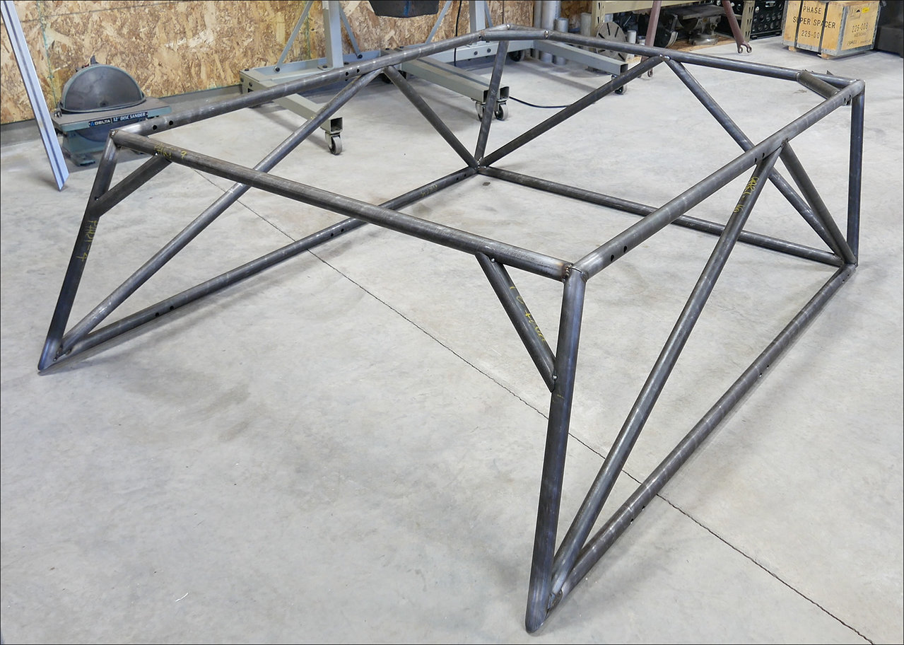

    The basic structure. Still needs finish welding and Dzus tabs for the panels. Looks heavy but it only weighs 60 lbs.

    ooh you guys will be using dzus fasteners for the aluminum sides?
    Ive only heard of using them on my fairings for motorcycles when racing. Guess they could have this application too.

    They are used on race cars, airplanes, helicopters......

    Invented for airplanes, then used on race cars and much later applied to motorcycles... :)
    https://en.wikipedia.org/wiki/Dzus_fastener

    As others have pointed out, they're used on lots of cool stuff. They're a nice slick way of attaching panels that need to be removable. The biggest advantage is that they're 1/4-turn and won't vibrate loose. Plus the spring catch allows some give making the panel less likely to develop cracks where it's affixed to a more rigid structure.
