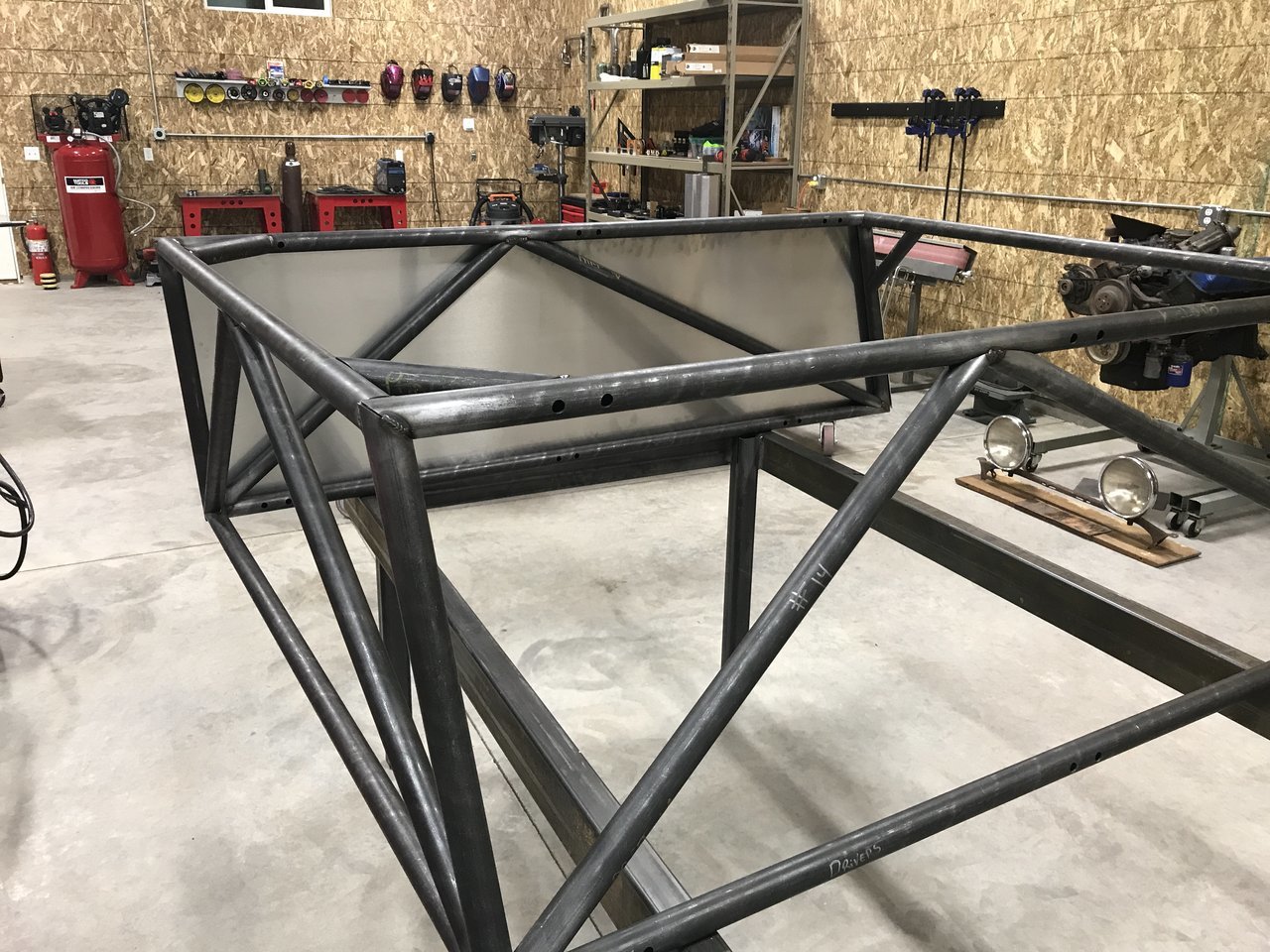

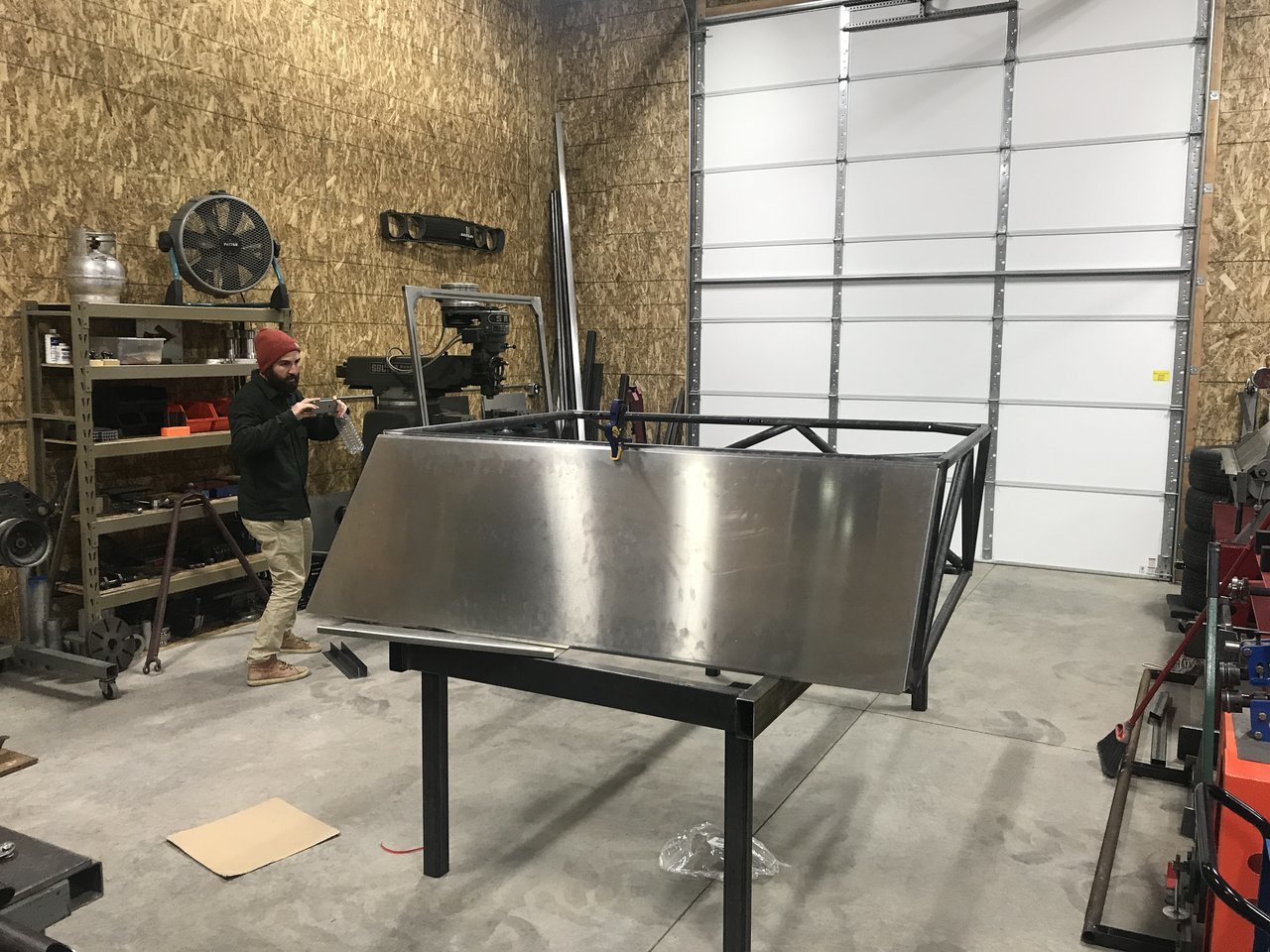

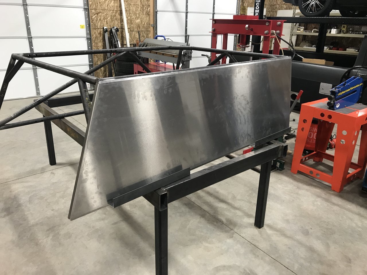

    We got our aluminum panels lasered the other day. This will get bead rolled to stiffen it up and more holes made for the dzus fasteners. And we started working on the hinge to make these sides operable. It’s a tricky challenge to make the hinges work with our seal and tube placement but I think we’ve got it figured out with a slick 6-bar linkage hinge. Machining prototypes of that this weekend. If it works like I think it will it’s going to be pretty rad.

    The top panel is a composite honeycomb panel. It's white and translucent so you get interior light but it is inherently insulated and does not turn the space into a greenhouse. It's also decent in the cold. You can't walk on it, though we will have rack options that would provide a walkable deck.
    There will be an optional roof fan but this thing ventilates really well due to the window placement and with the insulated roof panel it is really nice in hot environments. We're in Montana but I'm from Southern California and spend almost all my camping time in the desert or Baja so this the camper is especially well suited for hot deserts. It stays much cooler than a double wall tent.
    The t-Nuts will slide right on the ends, no unbolting required. We'll also have versions that you can stick in the track anywhere and rotate 90 degrees to engage.
    As for gaskets and whatnot, repairability is one of our major design targets. So the gaskets for the panels on the lower frame are all off-the-shelf items available from McMaster Carr or directly from Trim-Lok. The popup tent part doesn't have any gaskets at all.
