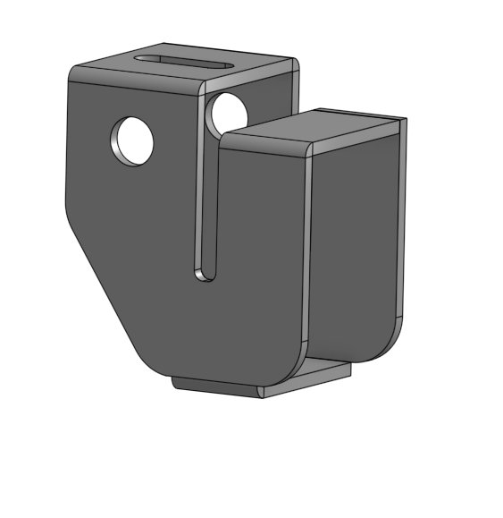

    So the 1st gen access cab ended up being the exact same geometry as the 2nd and 3rd gen models. Which is really good news for 1st gen owners who see themselves maybe moving to a newer gen truck in the future. That said, the 1st and 2nd gen regular cabs will require a different frame design from the AC trucks... one with no front rake. We'll build one of those when we get an order for one. But right now I think we don't have any orders for regular cabs. The only thing that changes on the 1st gen AC is the mounting brackets since they don't have the utility track. We welded up some brackets today and they worked perfectly (see the cad model below). In a lot of ways it fits better on the 1st gen because they don't have those dumb plastic bed caps.

    @wileydavis ”dumb plastic bed caps” are you recommending they be replaced prior to install? Will the GFC still fit without farther modifications to a Gen 3 with the plastic caps removed and replaced with KB Voodoo caps? Thanks.

    I just mean the the 1st gen beds have straight rails, with flat tops, rather than the curved and textured tops of the 2nd and 3rd gens. Just makes the fit a little better in my opinion. On the 2nd gen you definitely have to chop the fin if you go with the KB voodoo caps. We haven't done any installs with aftermarket caps on 3rd gens. The plastic caps on those isn't nearly as tall as the 2nd gen, so the loss in height might be negligible. With the gasket we use I don't think the plastic caps are a problem, I just don't like the design of them :)

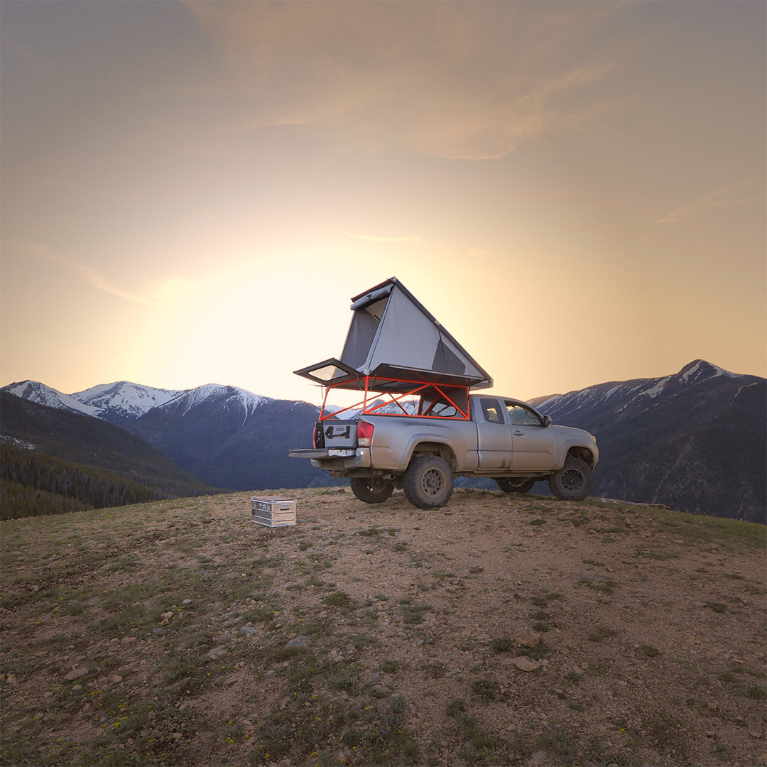

    Just a photo from last night. You know, to make waiting that much harder :)

    Yeah... thanks for rubbing it in ;)

    Living the dream right there. Good for you!
