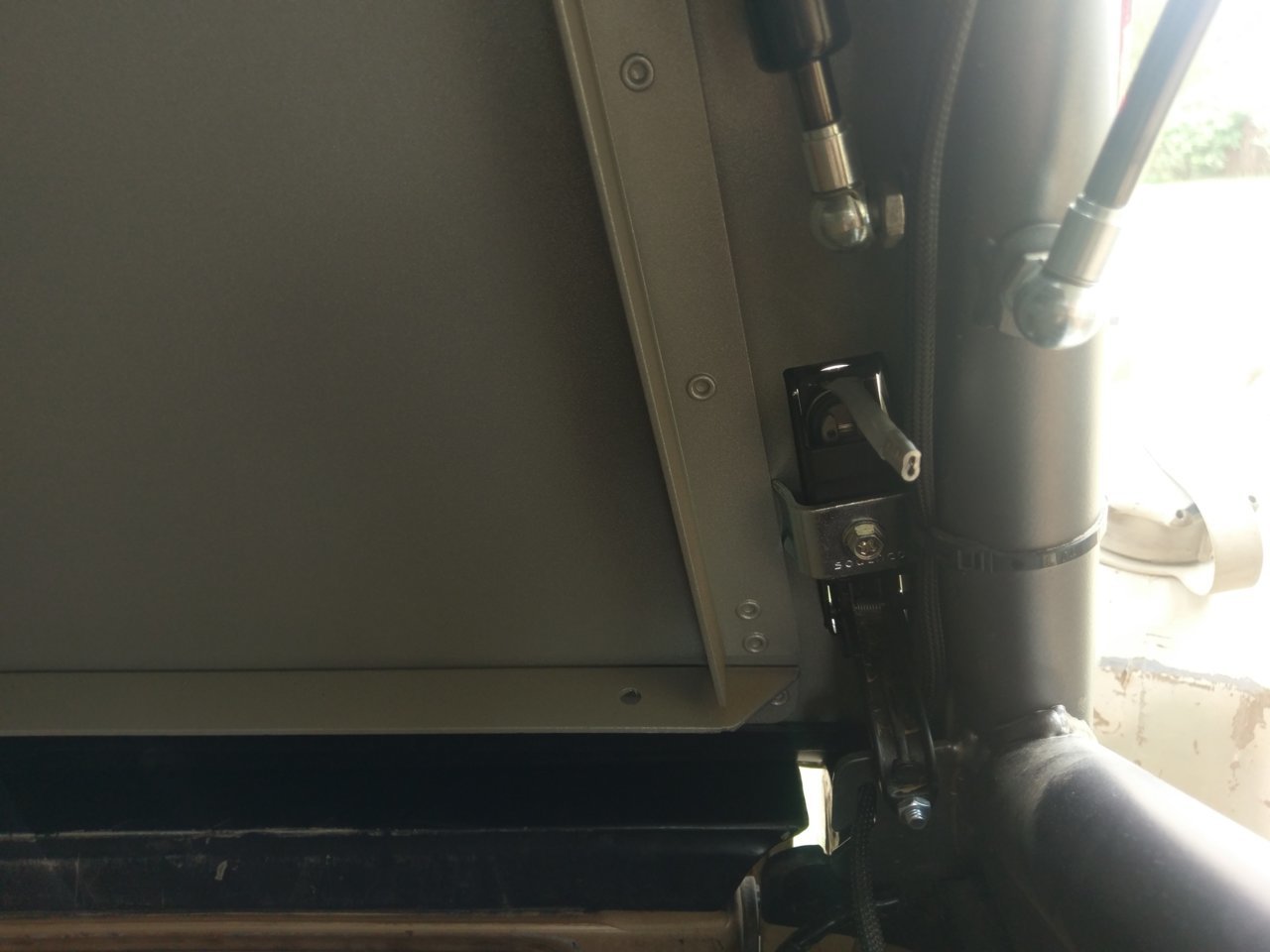

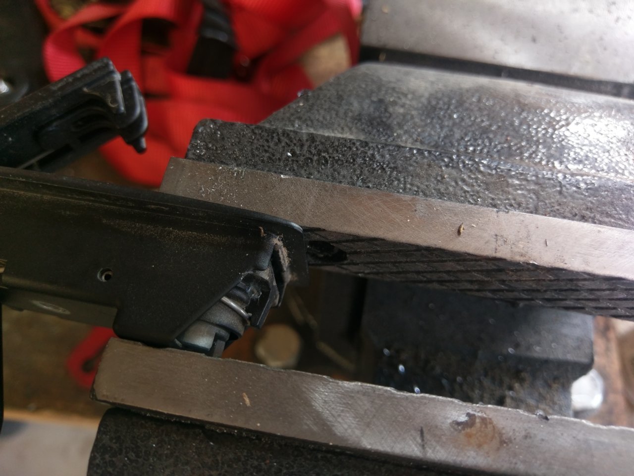

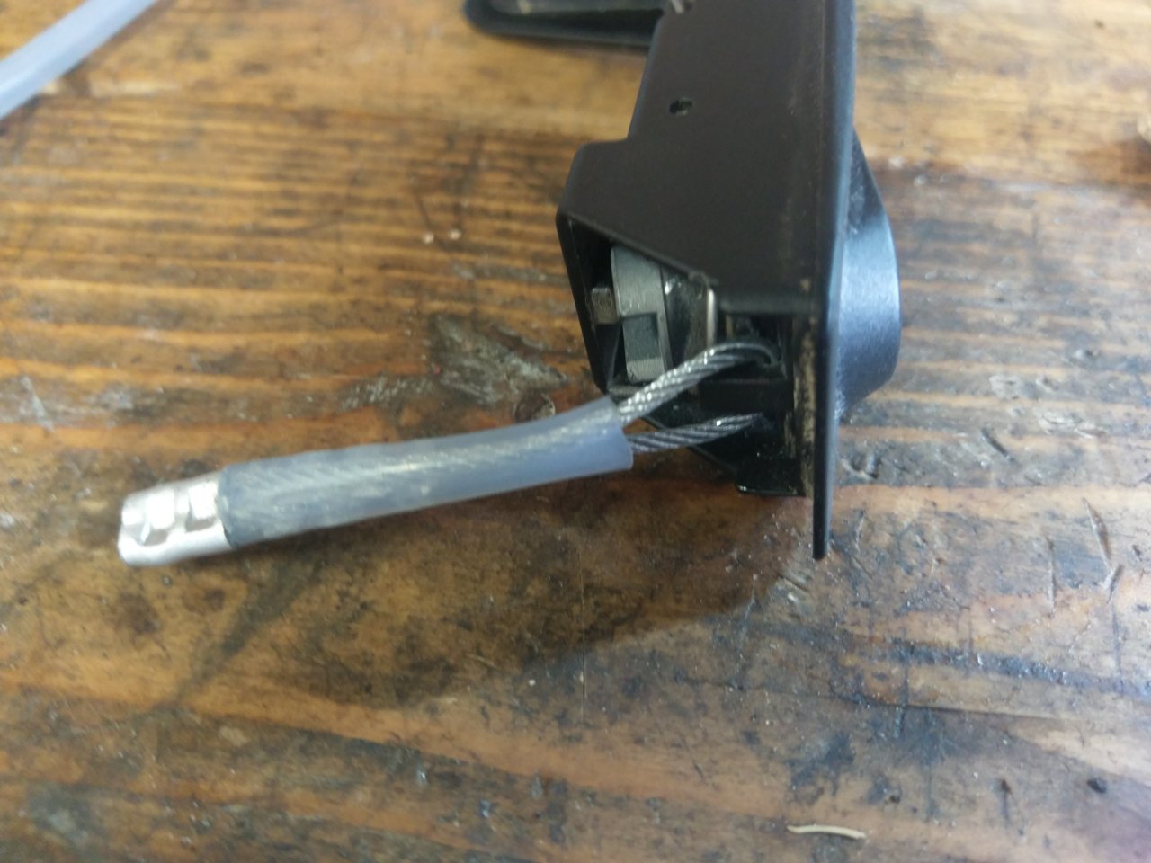

    First GFC mod. Was camping in grizzly country last weekend and realized with my cooler in the bed, I wanted the ability to latch, and therefore unlatch, the panels from inside. Just enough room to drill a hole and get a 1/16" cable on the inside of the latch. Works perfect.

    I was just unzipping the bottom of the big window and reaching down to unlock them.
