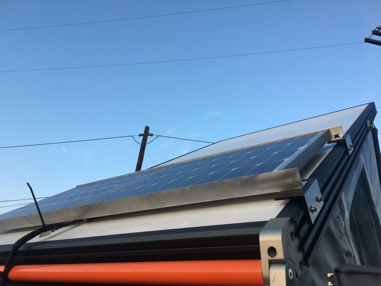

    I have 2 Renogy 50 watt panels that are connected to the solar input on a CTEK250 under the hood. This only charges the house batteries. The brackets are aluminum angle (3/16 for the sides and 1/8 for the cross members) that bolt to the extrusion with GFC T nuts.

    Nice. I want to do something similar. I have a 100w panel that was on my tonneau cover before the gfc arrived.
    I will probably put the charge controller in the bed. Cooler, but a longer wire run.
    I wish flexible solar panels were more reliable. I wanted a slim profile one for the roof, but reviews are not good.
