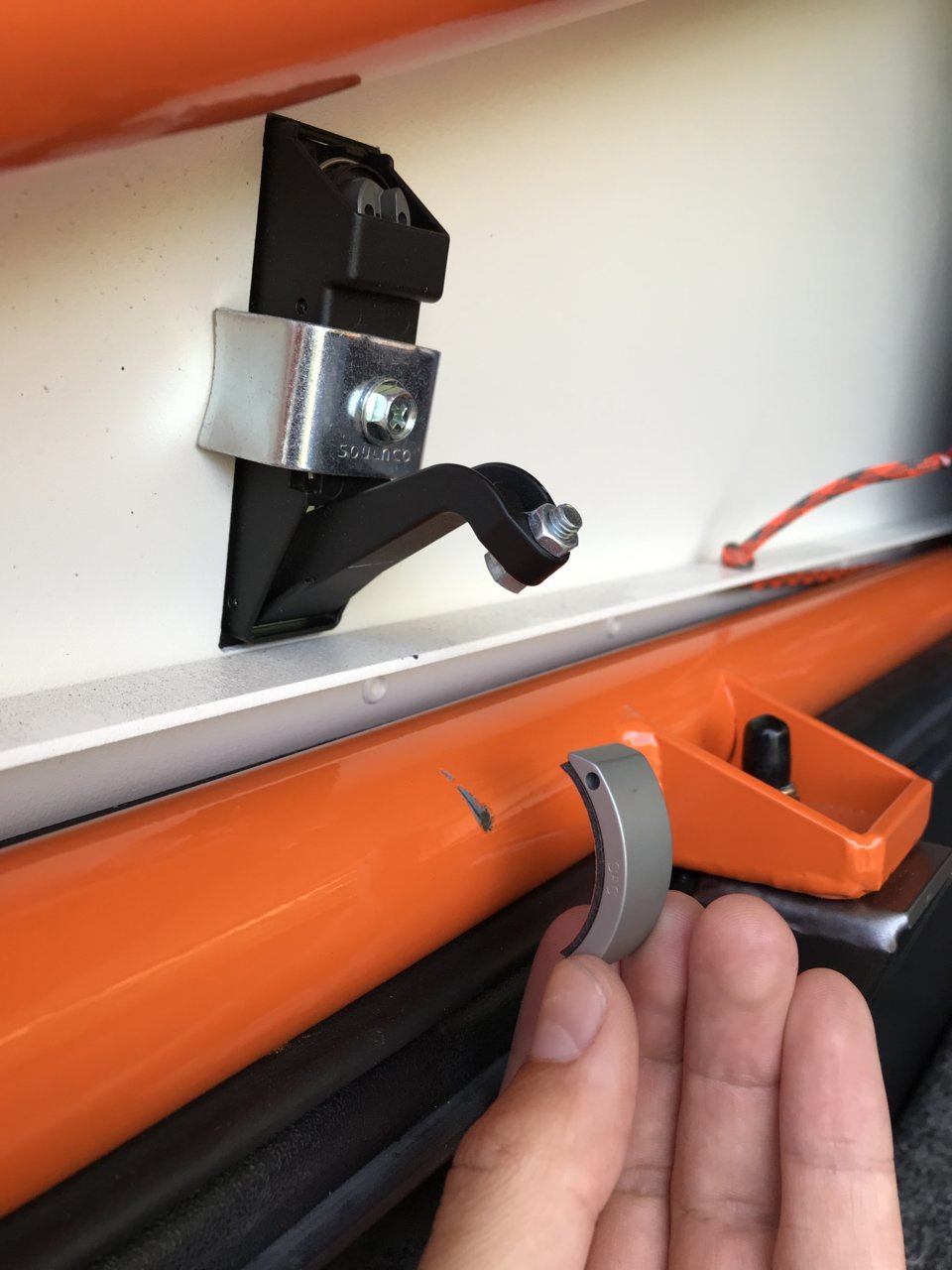

    Has anyone installed their frame savers yet? Is there a right/wrong way of doing it? I’m assuming there isn’t, just wanted to be safe. @wileydavis?image.jpg

    That's about right. The small hole toward the top and tht flat section somewhat parallel to the bed rail. As long as the striker plate doesn't stick past the top of the tube it should be fine.

    I can't believe we sent those out with the graphics on backward :)

    The added thickness of the frame saver is giving me some trouble when I try and latch it down and isn’t allowing me to close it all the way. am I supposed to remove anything or adjust anything else? @wileydavis

    The picture posted with them installed looked like the small bolt/nut was removed.

    The latch adjuster bolt needs to be removed.

    Awesome just the info I needed! Thanks Wiley and @crazysccrmd !

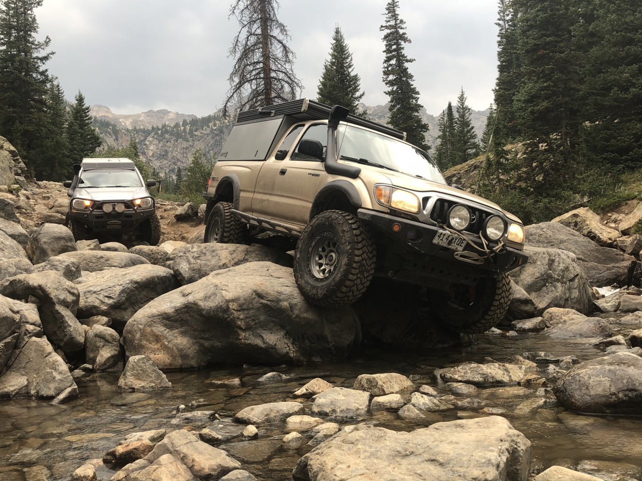

    Another weekend out in the GFC. Took it on one of the most famous technical trails here in Colorado, and didn't feel hindered by it at all.
    Scenic way home:
    [​IMG]IMG_1614 by Brett Bjorgum, on Flickr

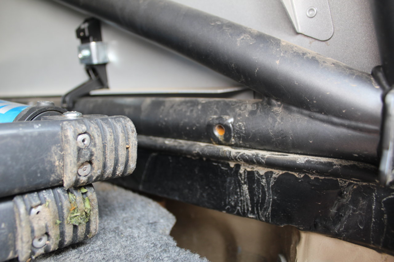

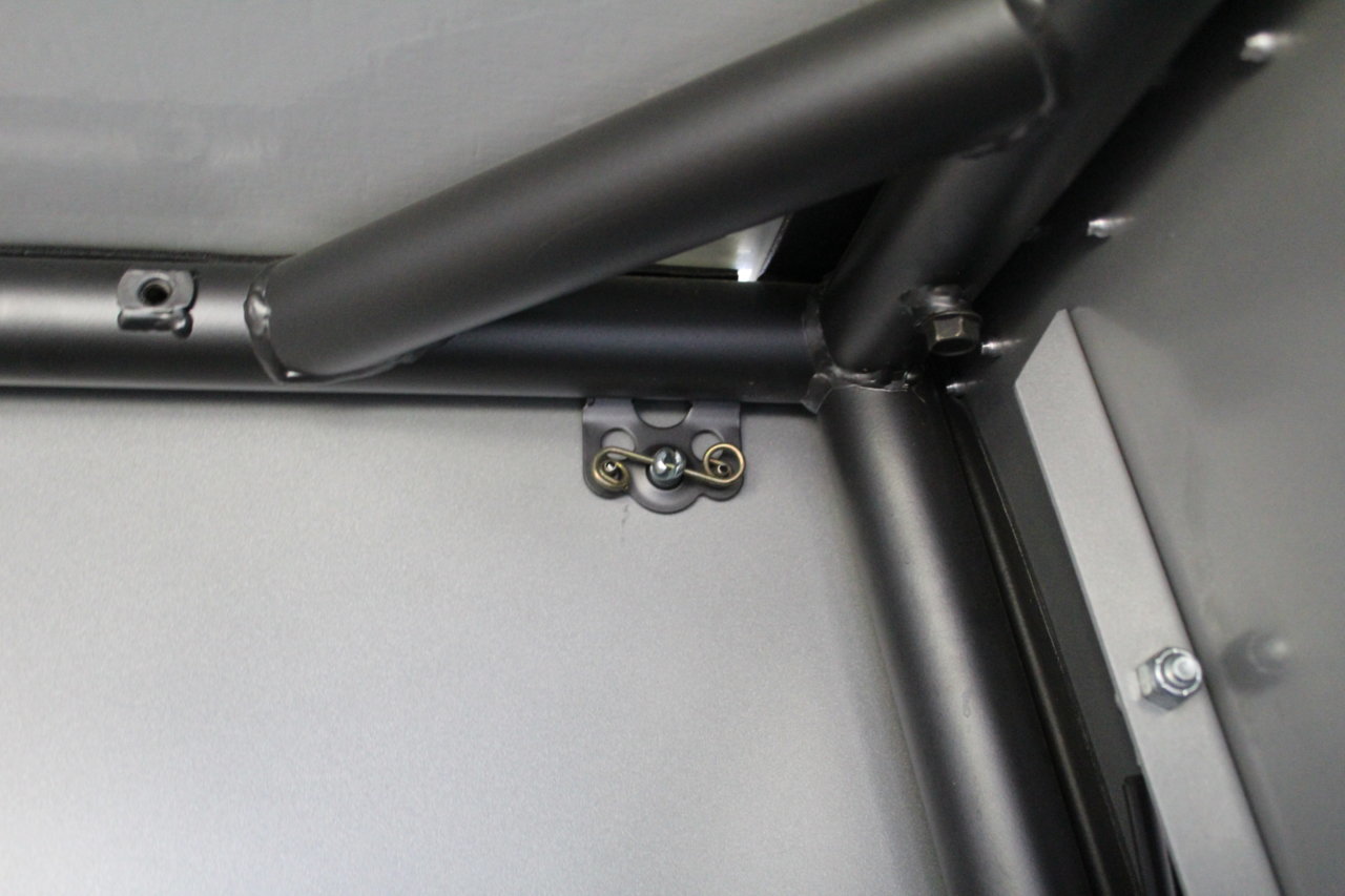

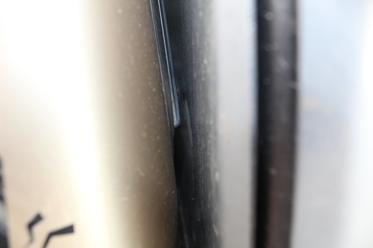

    Here's a few small issues I've noticed after having it for a month now:
    Front panel is rubbing slightly against the window trim on the back of the cab. Probably not a huge deal, but I'll be keeping an eye on it. And yes, I have fairly new poly cab mount bushings, so that's not the issue. Just a little too tight I think for the 1st gen.
    There's a section in the front right corner that I can see quite a bit of light through. Looks like the seal was cut a little short.
    Possibly related - I was sitting in the bed during a rain storm this weekend, with the side panels closed, and I had water dripping off one of the mounting bolts for the tent, albeit on the opposite side. Not sure where that was coming from.
    Last, it's evident the nuts in the frame were sealed for power coating, which is good, but then nothing put in their place. They're starting to rust. Could also mean moisture getting to the inside of the tube structure. I'll buy a handful of bolts to seal these up, but would like to have seen these filled from the factory.
