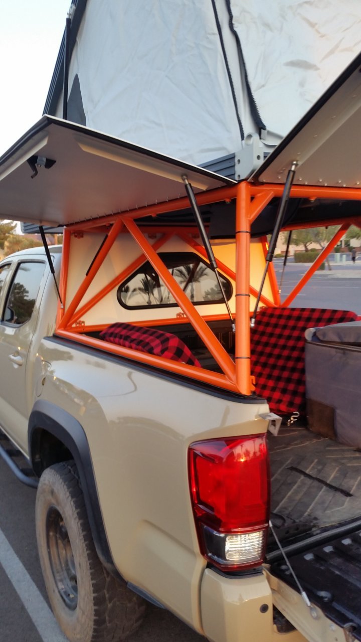

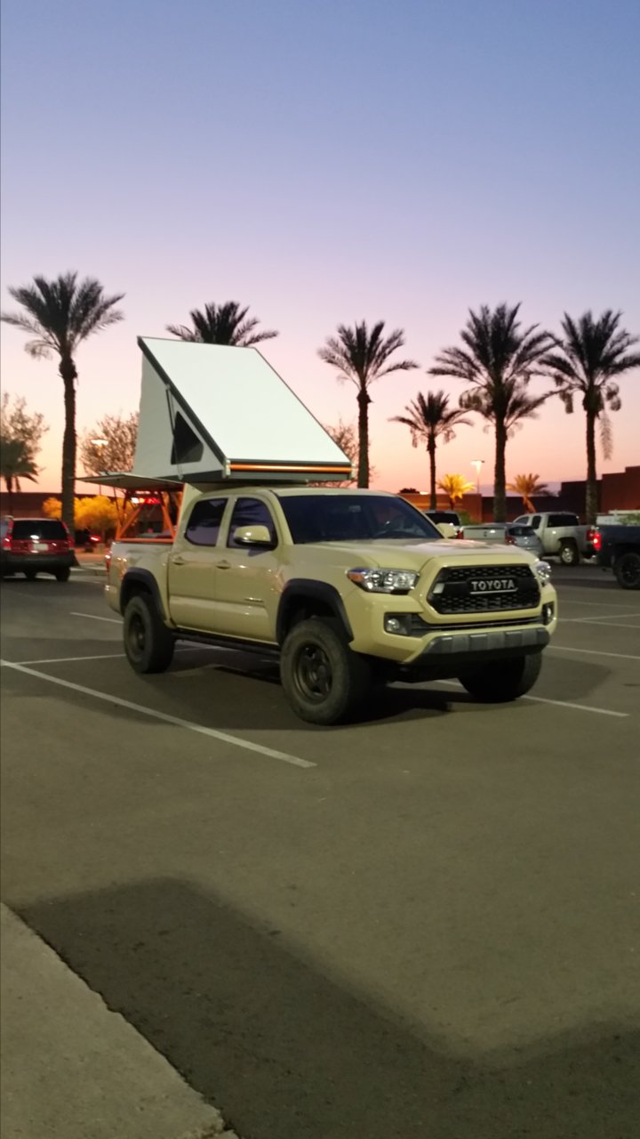

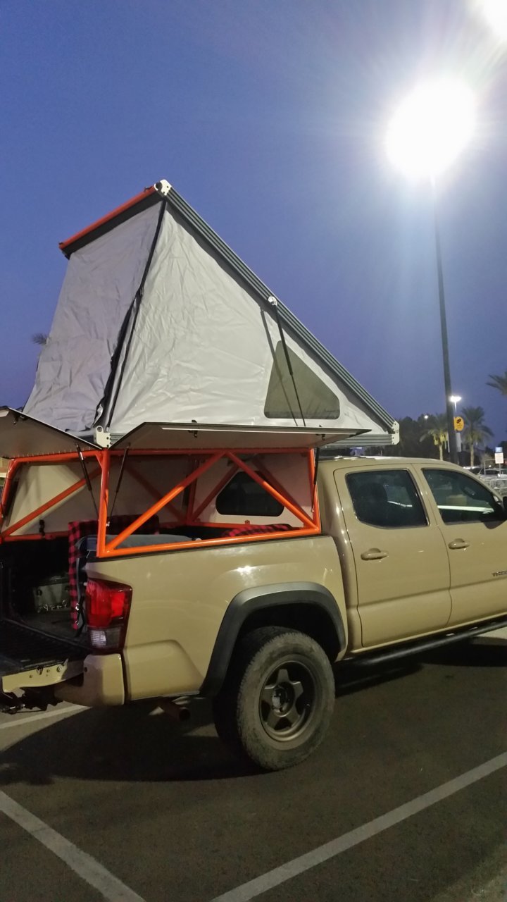

    Thanks to crumb for giving a peak of his GFC !

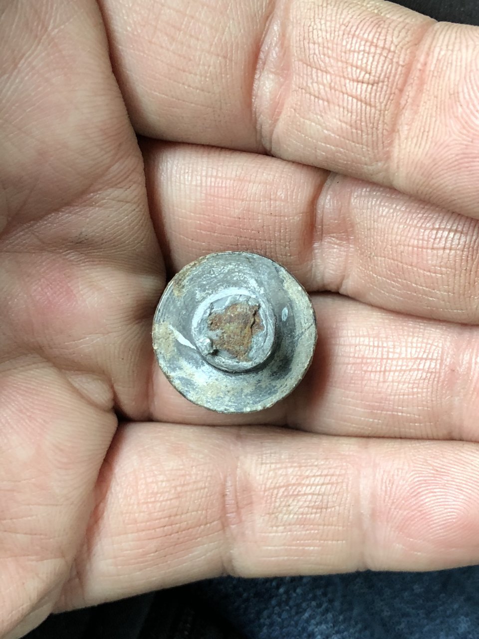

    Perhaps plastic bolt sleeves would be a solution to preventing galvanic corrosion. They also could help seal the holes.
    http://www.nyltite.com/headed_sleeves.asp
    These would be best installed at the factory since they would require an oversized hole.

    We loctite them at the factory. On our test campers we don't loctite anything so we can monitor what the bolts are doing. I mark all of mine with a paint pen so I can tell if they come loose. So far I've only had one (not loctited) loosen up. After a retighten it hasn't come loose since. But we still recommend loctite.
    The water that can get in the mounting bosses seems to come from capillary action along the underside of the hinge, not from inside the extrusion. We started pinching the side gaskets on the panels between the tent frame and lower frame to prevent this. It basically acts as a bridge preventing said capillary action. So if you remove the side panels for any reason, it's critical to reinstall them with the tapered top end of the panel gaskets pinched between the hinge and the top of the spaceframe. In all of our testing that eliminates the water in the mounting bosses issue. Even so, we'll be sending them out from the factory with a treatment of Boeshield T9 on the mounting bolt shank and in the inner wall of the mounting boss. And as noted before, the accessory mounting threads will come with preinstalled bolts and a smidge of boeshield to prevent the small amount of rust that can form on the threads in certain climates.

    I don’t mean water can’t get into the extrusion. I just mean that the loctite seals the threads on the bolt so water wouldn’t exit through the mounting holes and into the mounting bosses. That goes out the window of course if those bolts get turned without being re-loctited. :)
