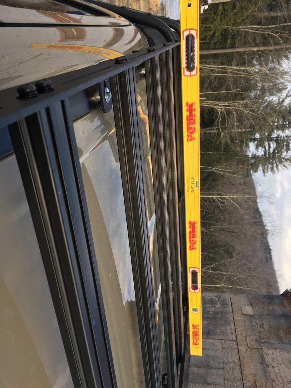

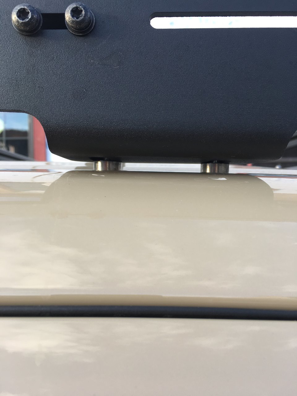

    So I put a straight edge across the top of the rack in came up with 9/16 of an inch above the shark fin. that plane is the outer part of the rack, the crossbars are 1/4" lower then that plane.
    Now if that is not going to be enough clearance for flex we could also machine new spacer spacer bushing.
