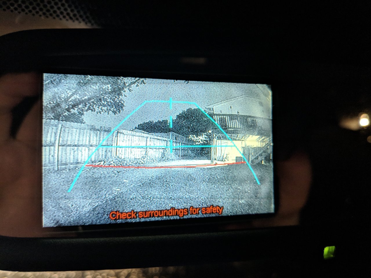

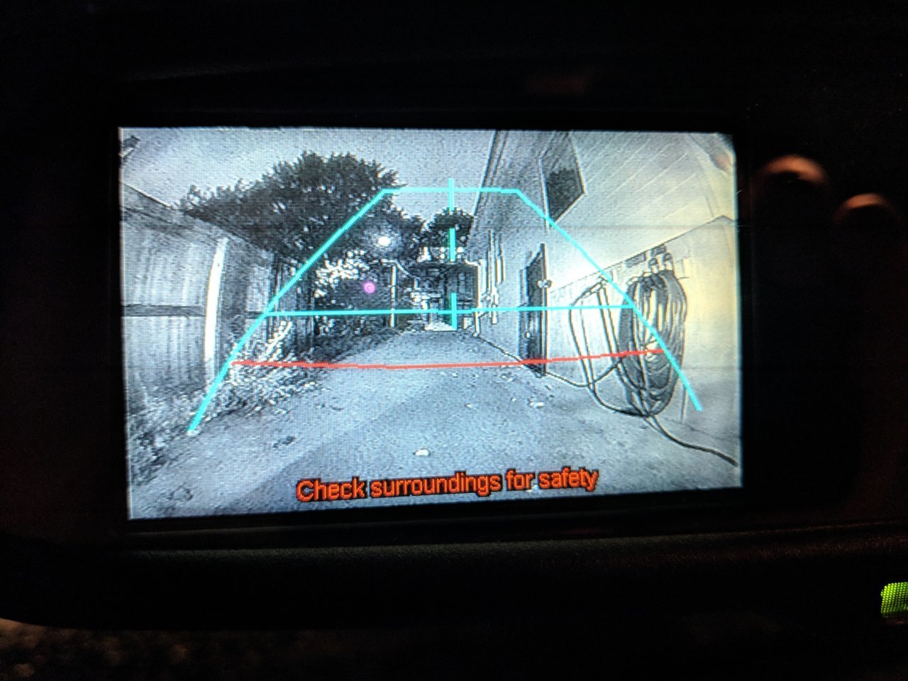

    i took some night shots for you. Obviously better in person than through my camera. I take back what i said before... i think the image quality is pretty good, but it has been several months now since i was using the original camera. camera3.jpg camera 2.jpg

    Thanks for taking those. Looks like an improvement over the stock camera, definitely worth considering.

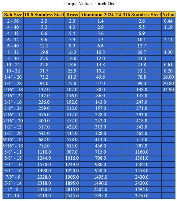

    Hey guys, well my GFC is mounted and my awning and brackets just arrived. I’m wondering if anyone has advice for mounting the awning brackets to the GFC? I picked up an ARB 2500 awning and 3 GFC brackets to mount on the drivers side of my vehicle.
    My question is has anyone used a particular method to mount brackets or anything else to the GFC T-nuts that use the extrusion? Only reason I ask is these are very fine threads (10-32) and you’re threading stainless into aluminum.
    I would normally just snug them up but as I said the threads are so fine (and Aluminum) i don’t want them to strip or worse have them fail when my awning in on.
    Googling led me to believe 18-20 IN/LBS per bolt is max for steel into Aluminum with 10-32 threads. I was thinking try that with some blue locktite and it should be ok. Anyone go this far? Or did you just snug them and call it ok?
    Also the ARB awning only came with 6 bolts. I picked up a dozen M6x20mm stainless bolts/ locknuts and they fit into the ARB extrusion perfect so I’ll use 4 bolts per bracket on that as well.

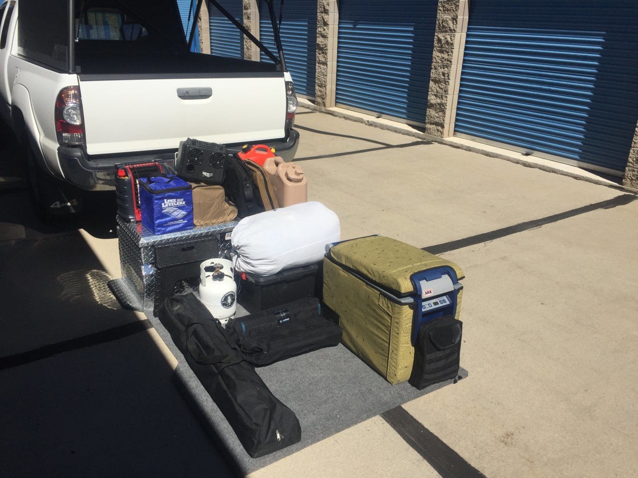

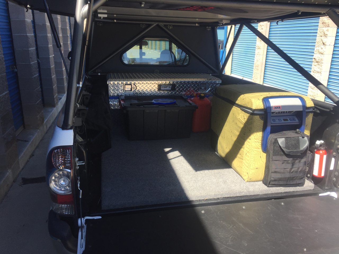

    About to head out again, this time we're heading to Escalante and Capitol Reef. Should be a blast as both are new places for us. Got some good tips on locals over on GFC Photos, Videos, & Trip Reports . Thanks everyone!
    We are OCD organized, try to keep it simple, and take only what we use. Yet, we try to be as prepared as our previous experiences have taught us to be. Daily driving, the rig is empty and ready to be a truck. Whenever the opportunity arises, we GOFAST to the hills.
    Here's a typical load-up:
    -Floor Plate System (I make these for WAY less than GG, if anybody's interested)
    -TrailFX Tool Box
    -ARB 50Q (Sub for Yeti45 w/ice blocks if traveling less than 3 days)
    -2.5G H20
    -2.5G Gasoline
    -Bedding
    -Stove
    -Kitchen Kit (in a black sterilite box, want to upgrade... Any recommendations? Pelican/Zarges/Alu-box?)
    -Mr. Buddy Heater ("Home" is 9,000' above the sea, LONG winters up here).
    -Lynx Levelers
    -Compressor/Flat Kit
    -BROG Recovery Bag
    -BROG Tool Bag
    -LP Cylinder (5lb)
    -Table/Chairs
    -Fold-A-Step
    -Demerbox
    -Strap/Rope/Stakes
    -Fire Extinguisher

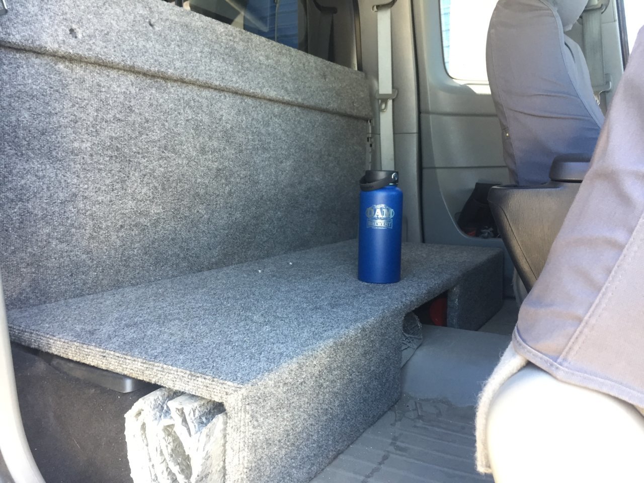

    Rear seats removed, another custom platform. Two small duffles of clothes, a BROG map bag, and a day pack/snack bag is all that rides in the cab. Flipped a truck once, nothing that would't feel ok hitting you in the head is ever allowed in the cab. Laptops/Nalgenes can really hurt...

    Decided to dig into this a little farther for anyone who might want to know the correct answer. Yes it does matter how much torque you apply to any bolt but especially when threading Stainless (very hard), into Aluminum (very soft) with fine threads (32 Threads per Inch). I do appreciate the responses of using a very light hand and a 1/4" wrench thank you. Here is an engineering chart showing approximate In/Lb. torque specs of various bolts into various materials.
    As you can see threading into Aluminum is less 2/3 the torque value of threading into another harder metal. I have an Inch/Lb. Torque wrench so doing it correctly isn't any more difficult that using a normal screw driver for me. If you don't have an In/Lb. wrench 19 in/lbs. is pretty damn light so be careful. I plan on using blue removable Loctite to farther secure these and hopefully preventing them from shaking loose.
    Hopefully someone else will find this information to be useful and it will save them a headache or stripped T-Nut. Do it once, do it right.
    If it wasn’t clear enough repeating it these are INCH/POUNDS... not ft/lbs much different o_O

    You're set up looks awesome! Have a great trip! I'll be headed north myself later on this week. It's a beautiful time of year up here, cool nights, beautiful colors I can't wait.
    Your floor plate looks awesome. Is that a BROG bag hanging on your fridge? I've been looking for something to keep my "kitchen" a little more accessible. Seems like a good option.

    I've been thinking about removing the rear seatback trim altogether and building something like this...have any pics of the build process or how you mounted that back panel?

    As you found, that torque range looks great for that material.

    Sorry no pics of the process as of now, maybe I'll take it apart later for better visuals. Back top "panel" is simple. 49"x7" outdoor carpet wrapped piece up top. Mounted with OEM headrest bolts. "Panel" below that is actually just some carpet hanging from behind the top piece. Bottom "deck" is bolted down with seatbelt bolts. Did this mod within a week of buying the truck. So much more useful for us than the jump seats Toyota includes.
