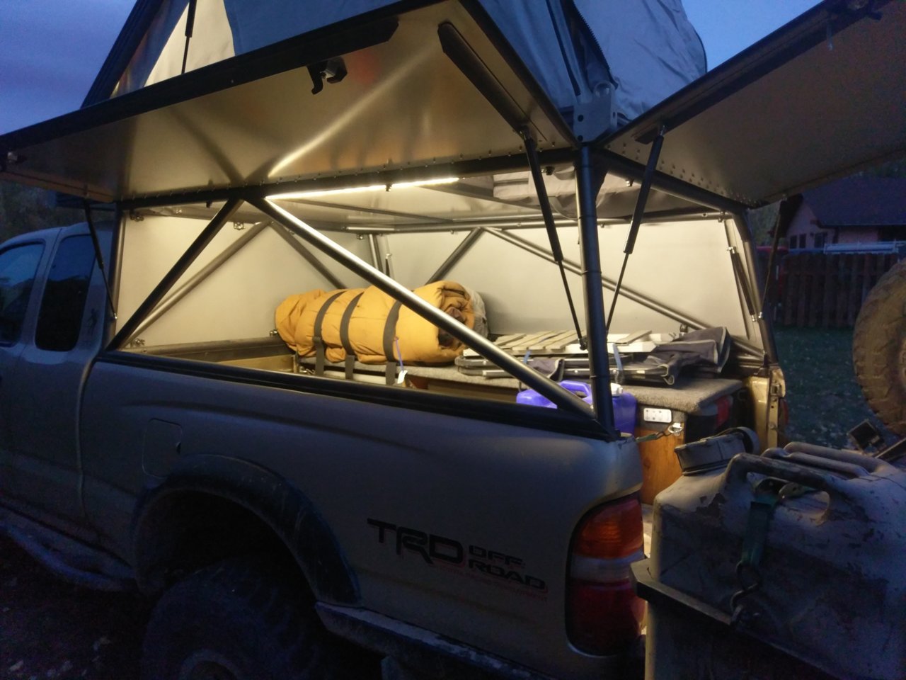

    Super budget Amazon special lighting kit complete with remote control dimmer was a great success. Was going to double the amount of LEDs, but they're not needed. Might add some to the panels to light up the campsite when they're open.

    Just whatever LED tape I found on Amazon.
    https://www.amazon.com/gp/product/B01339F5ZO/ref=oh_aui_detailpage_o02_s00?ie=UTF8&psc=1
    I specifically didn't get the RGB as I very much prefer the lower kelvin temperature lights, but I do see the benefit if you're dealing with lots of bugs.

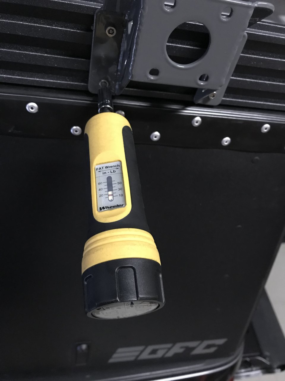

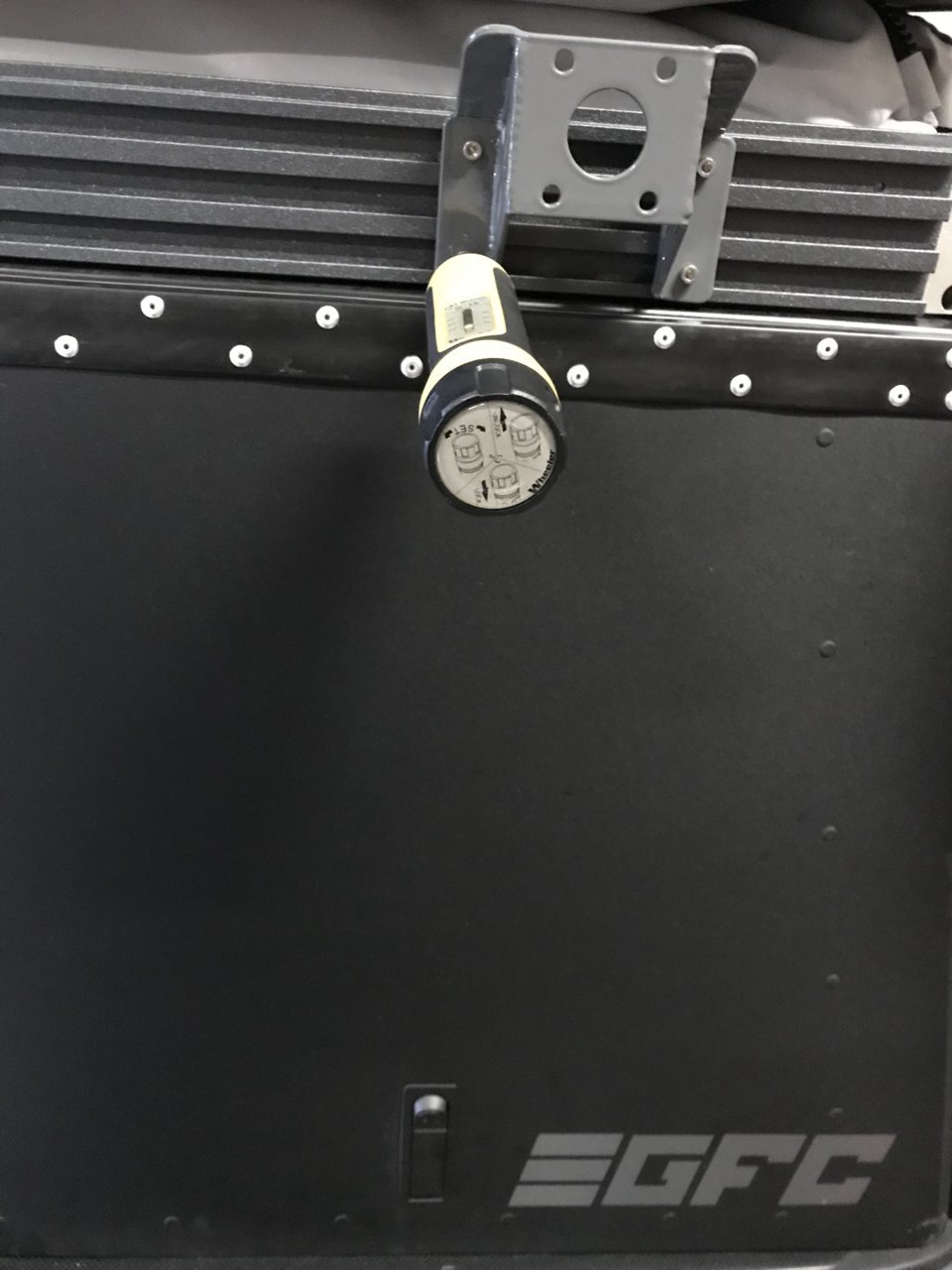

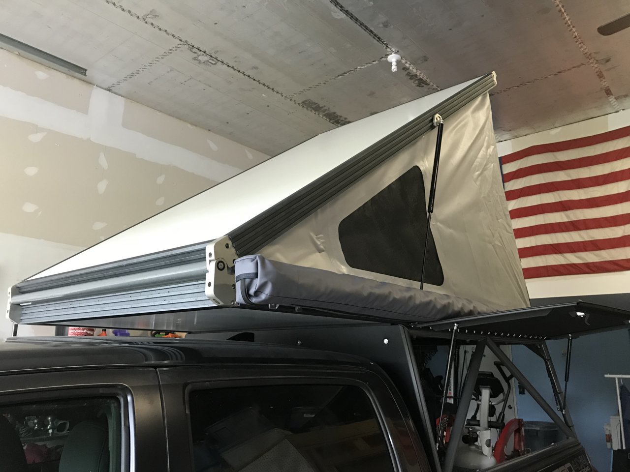

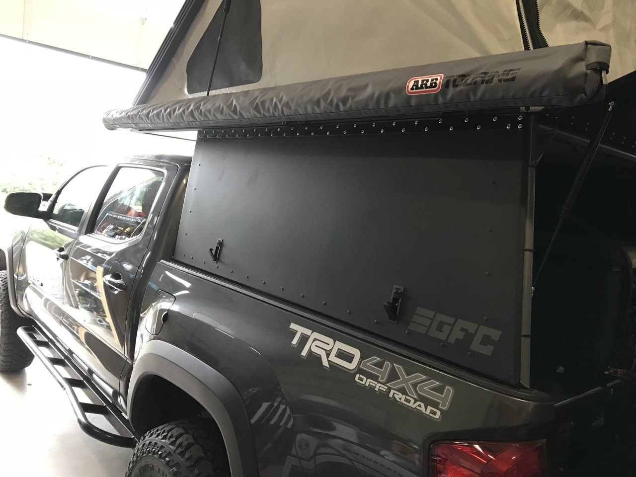

    Awning is all done being mounted. I went with a 2.5M ARB awning off the drivers side with 3 GFC brackets. As previously mentioned I decided to over think things and find specific values to torque the awning bracketsto my truck. Decided on 20 in/lbs, for the awning side i went with 12 M6-20mm stainless bolts with lock washers and locknuts.... because why not. I also loctite’ed all the GFC T-nuts with “blue” medium strength thread lock.
    I’m super happy with the mount it’s rock solid. I can shake the whole truck with just the awning. The only thing not perfect is the center bracket i used it biased toward the back due to the gas strut on the GFC blocking a portion of the extrusion.
    I used a wheeler “fat wrench” to set the torque. In my opinion the 2500 awning fits PERFECT. No distance shot because it was pouring outside so I did all the work in my garage but it fits almost exactly.

    I have been looking at those gunsmithing screwdrivers for years. Great little tools.

    That bitch is huge hahahaha.

    Are these lights in reaplce of the GFC kit? As in you didn’t order their lighting system but used these instead.

    Correct. Probably not as nice as the GFC kit, but for like $30 and a little bit of my time, I'm pretty happy.

    If I had a Nickel for everytime I’ve heard that.
    Hahaha, seriously though it is massive. But quite literally almost the exact length of the GFC platform. It fits perfect. I was gonna go with the 2000, but who’s ever said “man I’ve got way too much space”. Cost was within $20. It seems super well made for the price. I bought mine from Bomber Products and they shipped for free it was about $260.

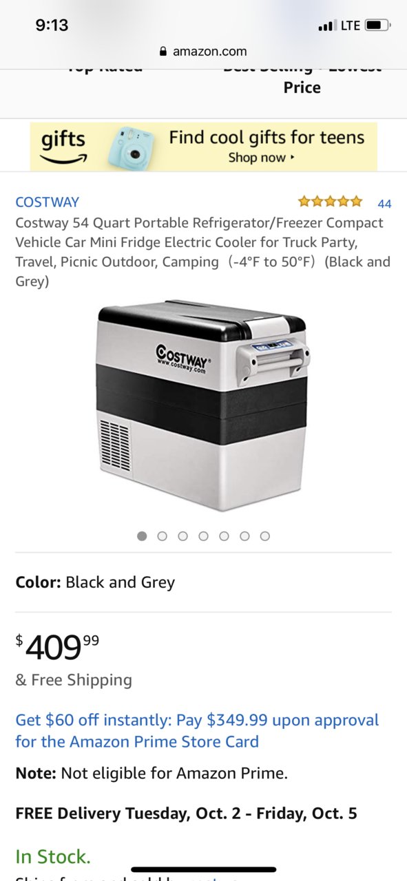

    I have been thinking about doing my own lights too. Saves me enough money to buy an awning or fridge slide.
    Speaking of fridges...I just ordered this Costway 12v. Figure that since there are such great reviews, I should give it a shot. I’ve been watching the prics increase almost daily.

    The prices are going to continue to jump. I bought it for $379 yezyedxay from costways website and it already jumped $10
