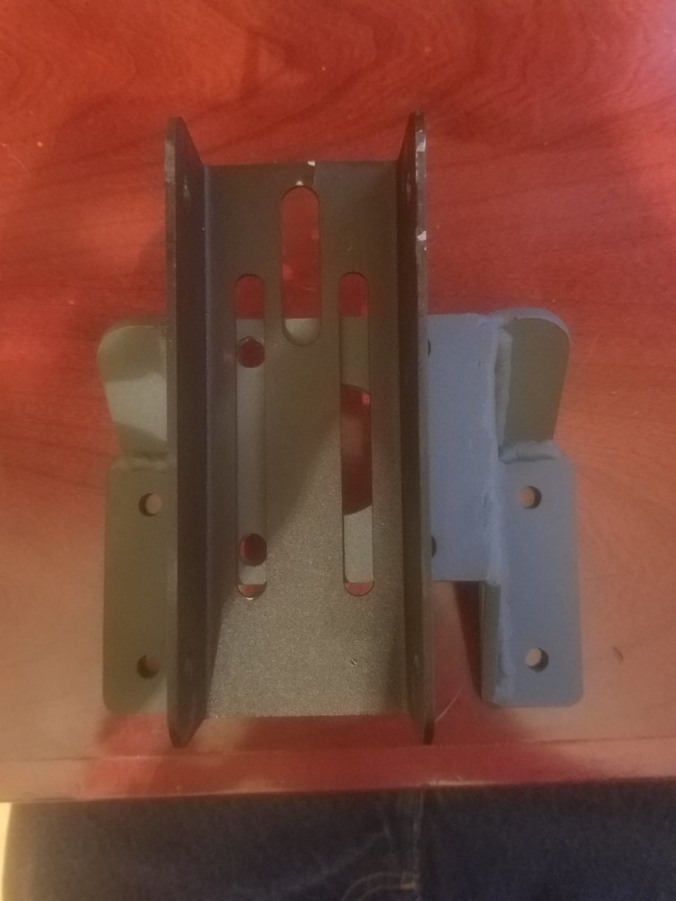

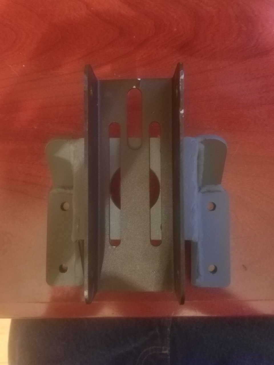

    It looks like you’re trying to mount a mounting bracket to another bracket. Pretty sure it was made to replace the mounting bracket you have. The awning should go directly to the GFC mount.

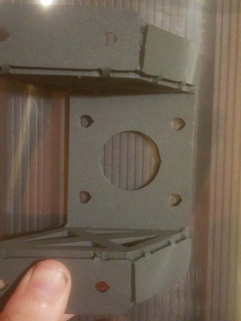

    I am not 100% sure thats possible. I would still be able to use only 2 bolts because of the spacing in the extrusion. See the 3rd picture in my post, it shows how wide the extruded slots are in the awning.

    I could go straight to the awning but will still only be able to use 2 bolts per mount, the spacing is much larger than the GFC mount bolt hole spacing. The 3rd picture shows the spacing of the extruded slots with the GFC bracket against the back of the awning.

    I think you’re out of luck for using the GFC mounts with that awning and having all four bolt holes line up. From some google image searches it looks like the standard Eezi Awn awnings have the same extrusion size as the ARB, CVT, TJM, Smitty, etc, but the Swift/Batwing/Manta use the larger extrusion size like Rhinorack’s Foxwing/Batwing.

    That is probably the problem, in my research I focused on the brackets being the same dimensions and didnt look at the differences in extrusion slot spacing. So I will either have to figure out how to make it work or see if GFC can make some for the swift/bat/manta awning size. @wileydavis any chance I could get an awning mount in the size for the eezi awn swift/bat/manta? Or maybe an adapter to make the current gfc mount work.

    Wouldn’t be hard to make an adapter. Use some flat plate steel with four holes drilled to match the awning extrusion and four holes drilled to match the GFC mount. Use a couple thick washers between the adapter and extrusion to space the adapter plate away from the extrusion enough for the bolt heads to fit that attach the plate to the GFC mount.
    Edit: Maybe instead of washers use cut bits of plate to provide more surface area contact to absorb torsional force from the awning weight bouncing offroad. More surface area contact between the awning extrusion and GFC mount that way.

    I see the issue now. I’d go to hardware store and grab flat metal, drill 3 holes; 2 for GFC mount and bottom slot of awning, 1 for top slot on awning. Middle hole that is flat can just use a rivet instead of a bolt to fasten it. If you have access to a MIG you can just tack it good enough and call it good (i doubt you need much penetration).
