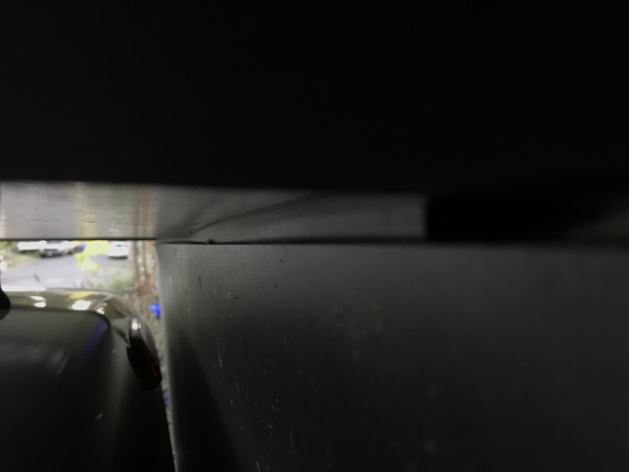

    Hmm. Mine is definitely not like that, I’ve checked. I can’t see any light in or out now after I added some tailgate seal to the bottom of the rear hatch space frame surface. That should be fixable somehow.
    I forgot, I also pressure washed mine and didn’t notice any water inside. I didn’t purposefully point it at the seals, but I didn’t avoid them either. Then I opened up the doors and washed the truck bed.
    I agree, the design is exactly in line with what I want.

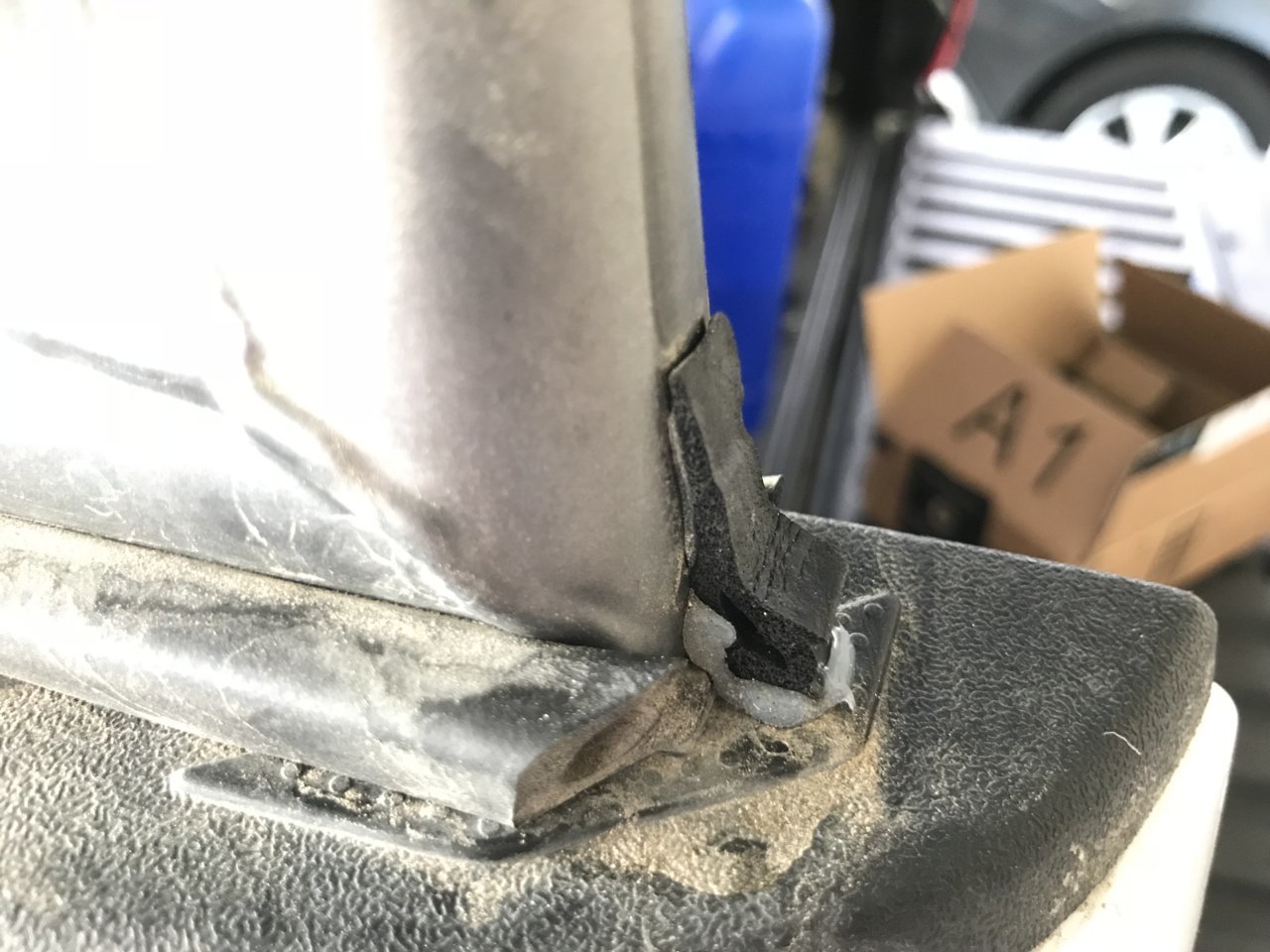

    My rear hatch seal improvement:
    There was a big gap here.

    If you could send some photos to the orders@gfcengineering.com email, Ben will take a look and figure out a fix for you. From that photo it looks like the hinge wasn't pressed far enough in when the tent mounting bolts were tightened. There shouldn't be a gap in the seal. Regardless, we'll get that sorted for you.

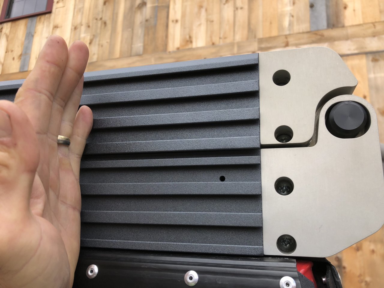

    86EADA31-55E1-4CD7-99BB-E63C4C89A842.jpg @wileydavis how far in does the male part of the closer bracket go into the extrusion? Going to mount some scene lights up there and going to run the wires internally.
    Thanks
    Morgan

    If I remember correctly those were the prototypes, may be the same but... Also what do those bolt into in the extrusion to keep them into place. Hopefully he can just give me a number from the end of the extrusion toward my hand that would be safe to drill. I am also talking the top part that pops up.

    Umm, I doubt it. I think they are bolted into a rifled part of the extrusion that you cannot see from the out side. I have been looking for a pic of the extrusion's cross section but can not find one.

    I'm talking these end brackets, they must bolt into the extrusion.

    The end plug extends 1” into the extrusion. They’re held on with those screws you can see on the front and sides of the corners. Those are thread cutting screws that cut a 1/4-20 machine thread onto a screw track extruded into the tent frame.

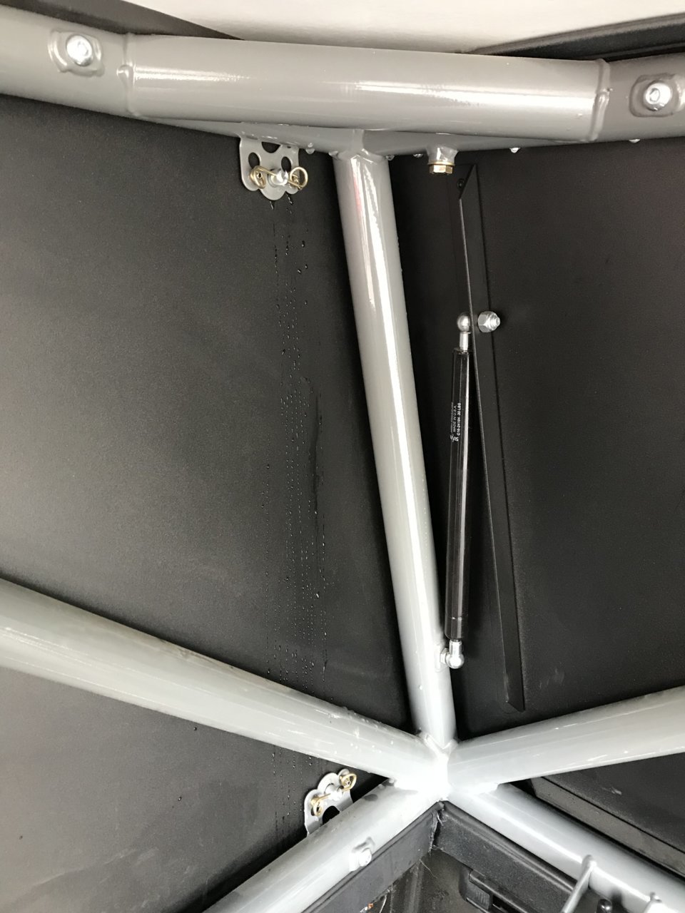

    Hey guys,
    I’ve spent a total of 10 nights in my GFC since I picked it up this month.
    I absolutely love it. It’s been great.
    I’ve noticed a few things that are starting to worry me living in Portland and with the rainy season just about to kick in.
    -The southco locks seem to be leaking pretty in the rain.
    -I’ve noticed leaking coming in from bulkhead near where the top
    Of the GFC meets the bottom of the bed panel.

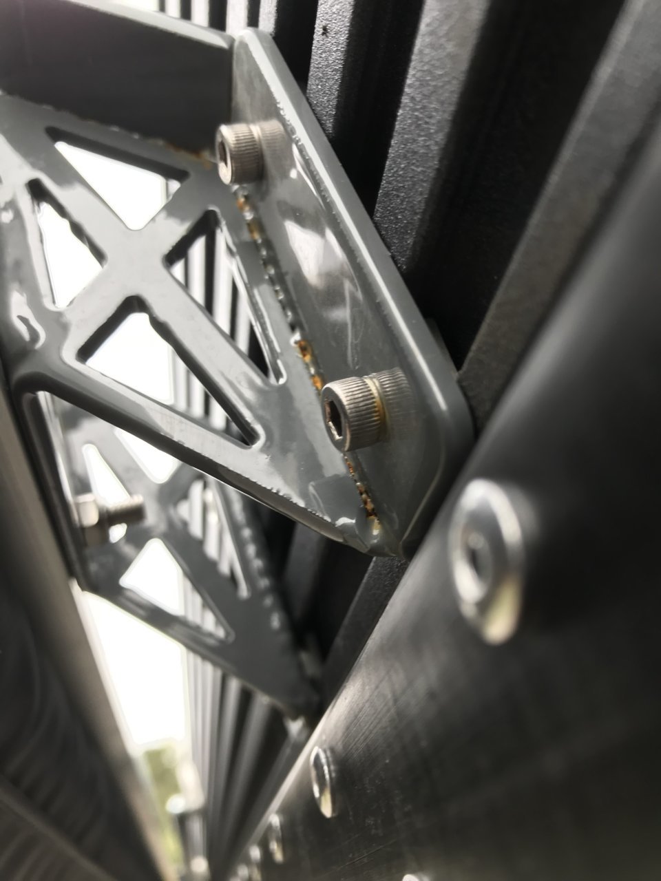

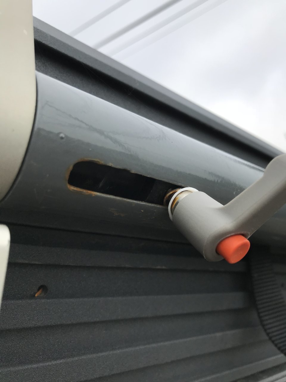

    -My awning bracket and tent latches are starting to show rust
    -I noticed the gasket or seal looks a little odd underneath the overhang where the space frame meets the tent. Can somebody check there seal and tell me if it looks the same. It bows back in towards the bed near the middle. E5AA359D-5D55-478A-8977-52F139E99550.jpg
    Included some pics below. Hopefully this all makes sense.
