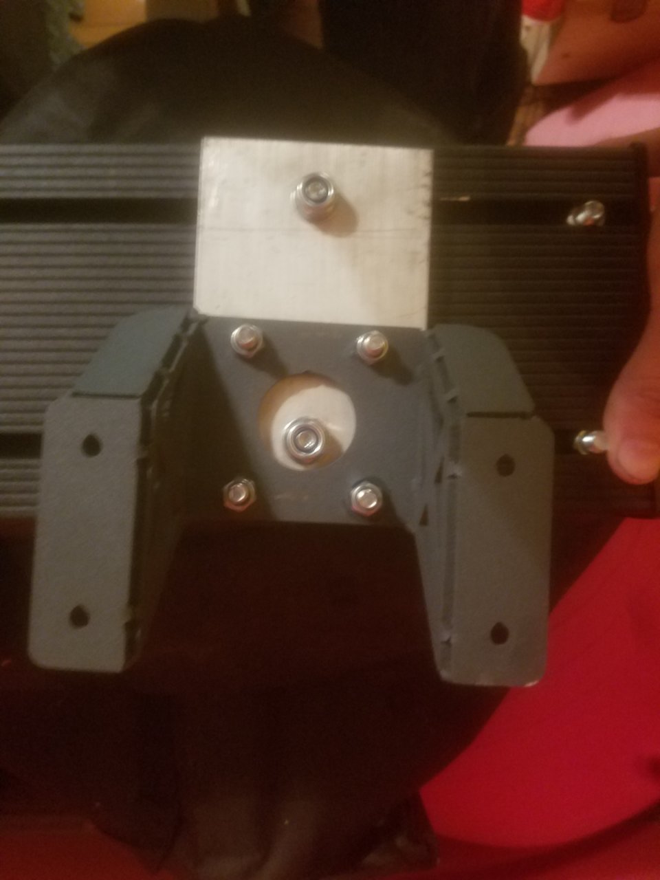

    Its an Eezi awn swift awning, I believe its the same extrusion back as the batwing and manta awnings. The bolt spacing that attaches to the awning is 3.125".

    Close. The brackets that came on my rhinorack batwing is 4". Can't wait to see yours mounted up!

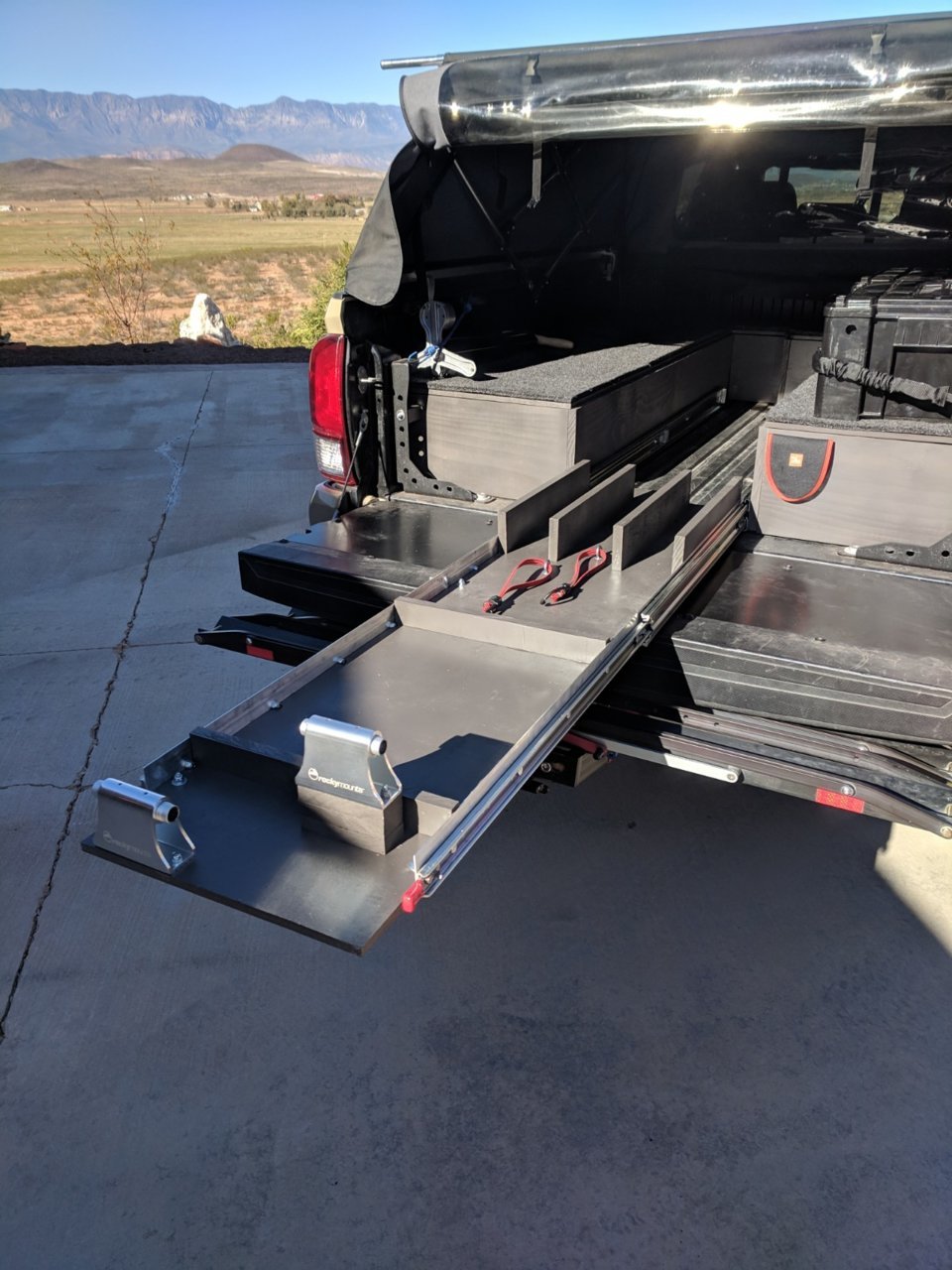

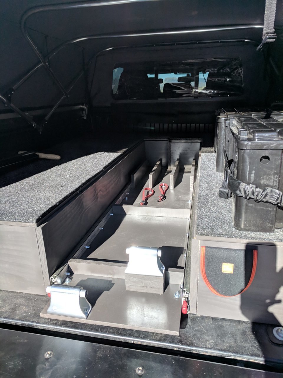

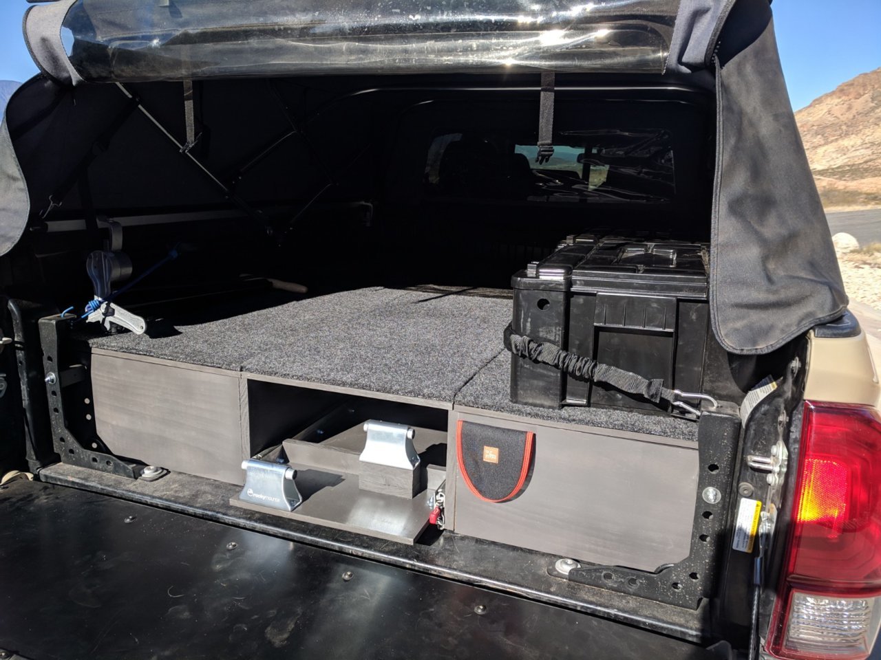

    Working on my drawers. The left lower side will be a bike tray, mounted on 52in sliders so I can just pull two bikes out and unload/load them in. It will have a Formica top so it’s cleanable and you can pull it out and use it as a table. There will be a small drawer underneath them. The right side is a 36in slide with a battery box in front of it. It will be carpeted on top with L-track on both sides. If anyone wants one made in SD, message me.
    Currently waiting on slides, carpet and some other parts.

    Roughly mounted the adapter and gfc bracket. Should work nicely. Going to use some blue loctite and I have lock nuts on the bolts so should hold together well enough. I say roughly mounted because its clearly not square on the awning but you get the idea. Simple solution to a simple problem.20181113_141130.jpg

    Looking good! Where are you getting your drawer slides from? I'm going to do something too, just not sure what yet. Seeing your idea there for the bikes has me thinking, would be nice to have the security of having them inside. Between my bike and the GF's bike that's two GFC's in price! ...but we also have dogs, like a whole bunch of dogs :D that need to have spots.

    Ya I wanted to put the bikes inside, they cost a bit more than the camper lol. The slides came from cabinet parts, about $190 for the 52 and $140 for the 36in. I measured 40 to the lowest point of the GFC. So the sliding tray has a max height of 7in to give me room for the bikes. They boxes are made from baltic birch, a mix of 1/2 and 3/4in and I coated them with some roll on bedliner.

    Ok, so is it 40" to clear the space frame as you slide the bikes out, or is that from bed floor to the floor panel of the GFC? Ever heard of these guys: https://www.accuride.com/products/shop

    Its 40 from the floor of the bed to the space frame, then I made a 7in tall slide so I can have 33in of clearance for the bikes. The accuride are top of the line, but also super expensive (~$350 a slide I think). The slides I got are fulterer.

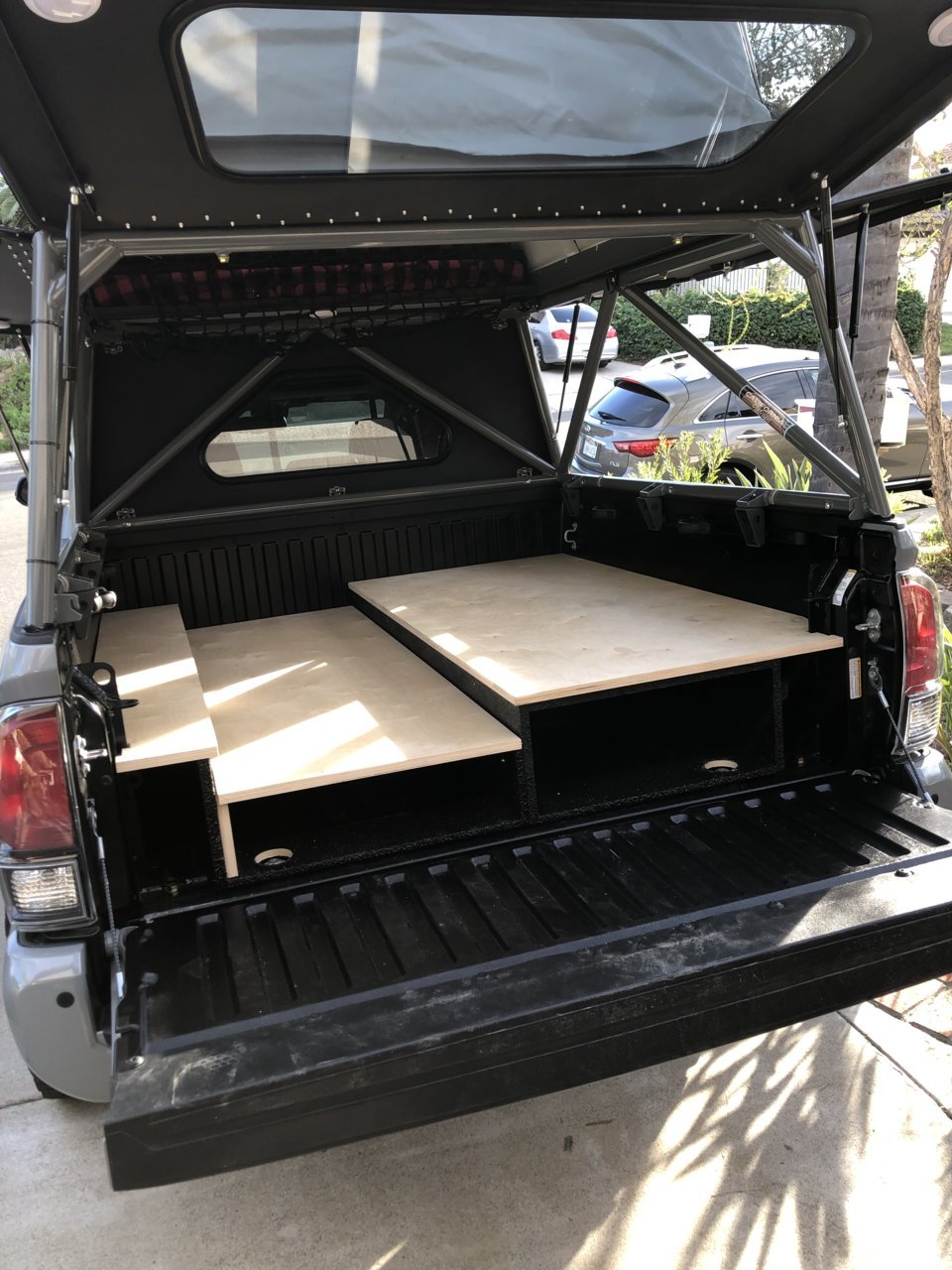

    NICE!! I'm looking to do something very similar. I want to do what you did - with a drawer on 1/2 of the bed. But, I think I'm going to add a 'basket' on top of the drawer system just to keep stuff from sliding around. I always seem to have things in the back of the bed that slide all over the damn place. The drivers side will stay open for truck hauling duty.
    My question is: why did you make cutouts in the plywood floor for the bolts? I was kind of thinking of getting those bolts 1/2" longer and using them to bolt down my drawer system...
    Any ideas on how to nail down 1/2 bed system? I guess I can just drill through the bed and use bolts...

    Let me know if you find those bolts! I put cutouts in them because they stuck up pretty high and made everything not level when I added the total choas bed stiffeners. Looks kind of lame, but when the drawers are in you wont see it.

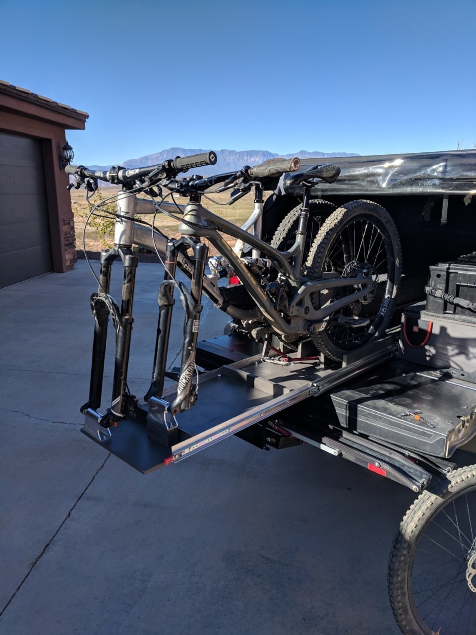

    I don't have my gfc yet (hopefully by the spring), but I did just finish my bike rack slide this week:
    With the center panel cover on:
    panel removed:
    extended:
    loaded up (it's a tight fit with my softopper):

    @ervandew What length and brand slides did you use for the rack? That is a slick setup!
