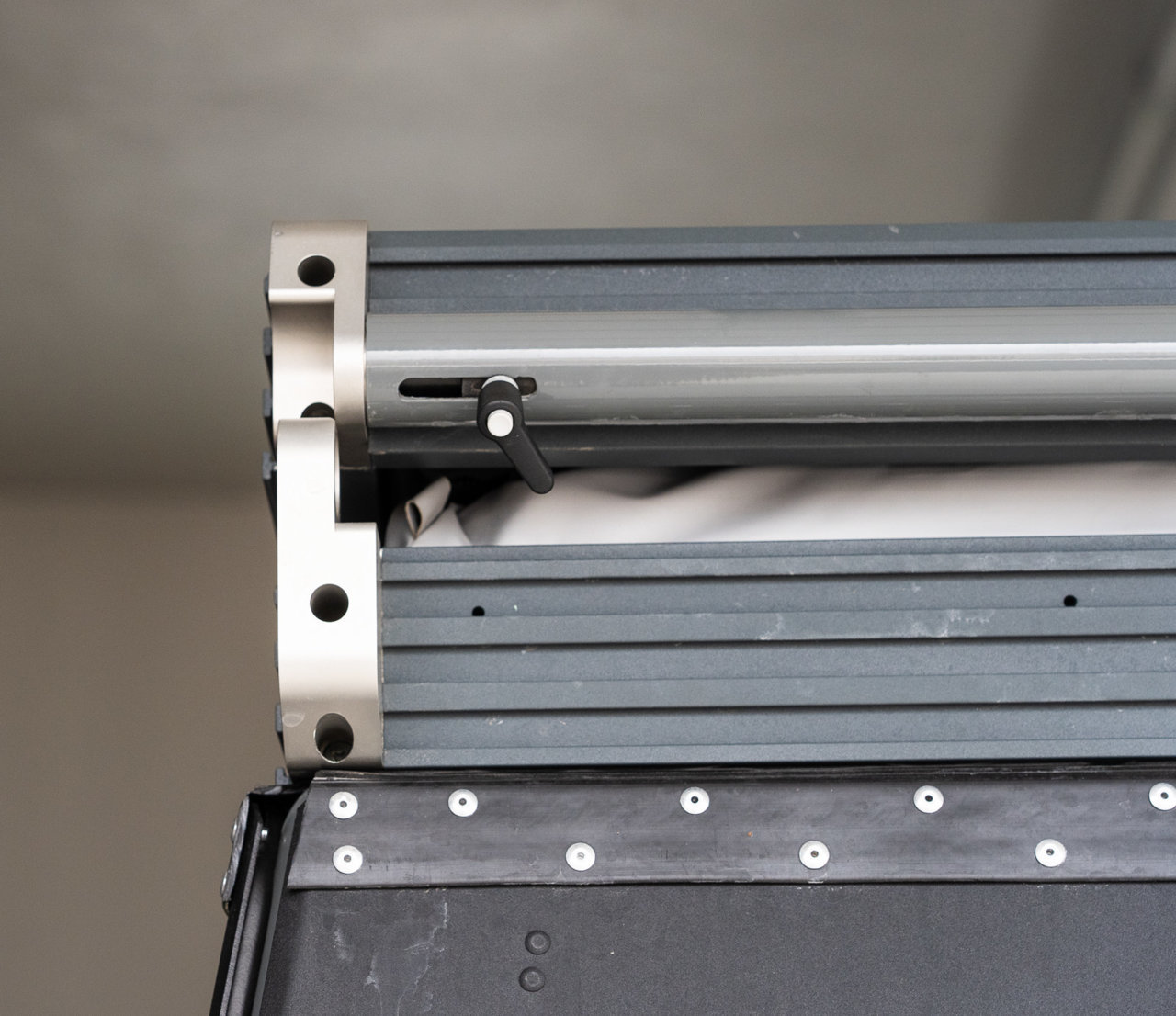

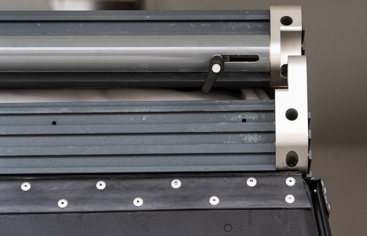

    Yea - you nailed it - my passenger side extrusion track bows toward the driver's side. Unlike some of the others, I have to close the Drivers side first, then while pulling down on the passenger side, I need to apply pressure to the passenger side to get the top extrusion track to come over and align with the bottom track. As I mentioned with the "bunk" set up for the cushions - not a problem, but for me impossible to do with all cushions in place. I think if Wiley goes with the 2" cushions he has mentioned, that would help, and also mine is only 1 month old, so thinking it will get better over time as tent fabric gets loosened up, etc.

    My theory is that the trucks bed rails that the camper sits on aren't flat. I know all of are beds vary a lot from the factory. This would cause the camper to be slightly torqued when mounted to the bed, causing the issue we all are seeing. Learning about how a tire swing-out will also exacerbate this problem, leads me to confirm this theory. When the tire swing-out it out, the frame rails torque slightly which causes the bed to torque more, making the camper even harder to close.
    A way to test it would be to take off your camper, and see if this misalignment disappears while off your truck. Then reinstall and confirm it exists again.

    Measuring the width (front vs back) looks like it is off only 1/16" - starting to look like mine is worse than most

    No, pretty even front to back. I don't think the idea about the truck rails not being flat causes it (though I could easily be wrong) - taking the camper off and setting it down on level would be instructive, but a pretty big hassle - as the other poster a ways back mentioned, "it is worth noting that extrusion manufacture has tolerances for warpage in all directions" and that is my hunch as to what is going on here, though I can see if you have a rear tire swing out (I don't), or are parked on an off camber slope, this could definitely change things.

    One thing I have noticed that makes a huge difference in components with tendencies to warp is the torque sequence in assembling. For these to have a gap like that would be unacceptable in my eyes. One thing you can try is to unbolt the piano hinge and loosen things up a bit and see if there is some play you can gain and re-torque it back into place. I'm not sure what the sequence is nor the specs, but would be worth looking into. To me this looks like one side was torqued all the way down before the other was even hand tightened. The only other thing besides assembly sequence would be the components being actually out of square causing the extrusions to sit at angles other than 90.
