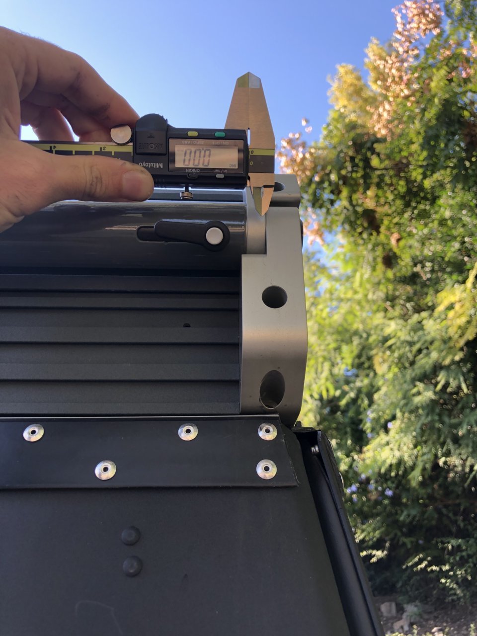

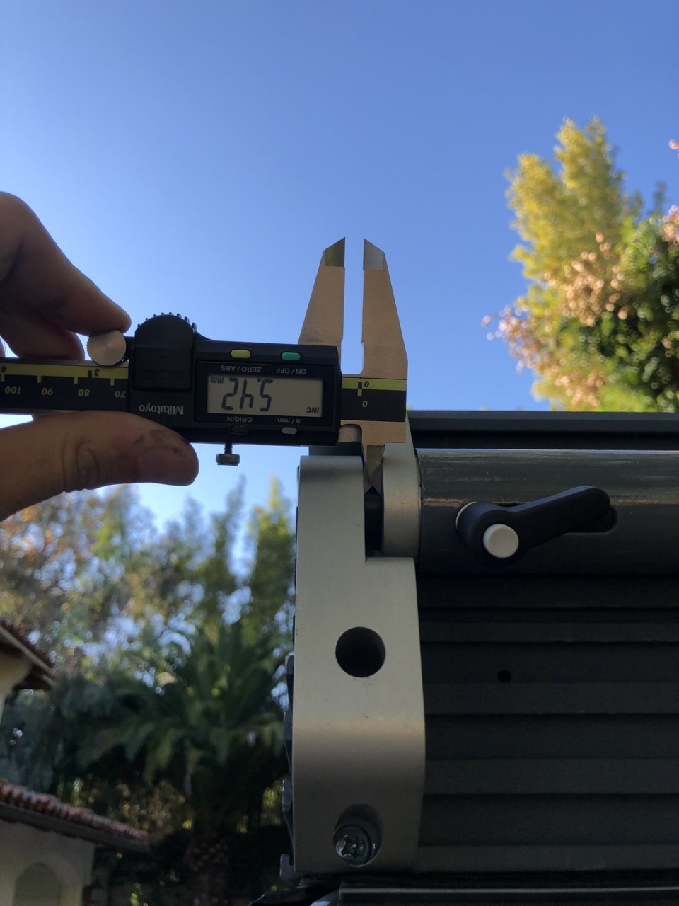

    Also, heres mine.

    I believe I was 80ish. Mine looks to be on the opposite side of @pygmyowl

    I was 101 on the Leaderboard. I thought mine was the worst, but gman36 is pretty close. A lot of the time I will be in "Bunk" mode (pin locks easily), and not trying to be a whiner, but it is hard for me to believe that the camper will ever "limber" up enough to get all the cushions in and get my passenger pin to close. The above poster who suggested incorrect torque sequence may be on to something, but I already made a return trip to Belgrade, and all Wiley did was bang on the sides with the dead blow hammer (with no effect) and state it was within spec. I will probably head back up there after the holidays, and see what they can do (if anything) to remedy the situation.

    Mine was built fairly early on and doesn’t have that offset. It is a bit harder to close with the swingout open but not impossible, even with all the cushions in. Looking at old pictures on my phone it seems to be a pretty even gap on either side. Yet again I find myself 4000 miles away from the truck and can’t get a current picture.

    I wonder if that gap is affected by someone picking up on the end of an open tire swing out, or by jacking up the axle on one side or the other. I would imagine the space frames are strong enough that the camper can’t twist, but maybe that’s just wishful thinking.

    My passenger side top extrusion came bowed out slightly, peaking around 5-6mm at the midpoint. My driver side extrusion is pretty dam straight. Assuming both extrusions were cut the same length, because of the bow, the length of that top extrusion would be slightly shorter, also explaining what we are seeing. Have you checked if your top extrusion on the driver side is straight? I took a few measurements relative to the bottom extrusion going the full length.
