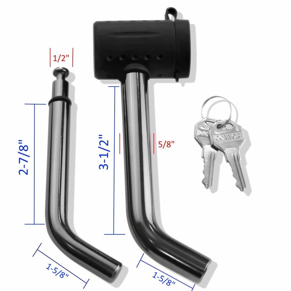

    Not sure what a s tab is? I was looking at replacing the passenger side bolt pin (designing a new one) with one that accepts a Connor swivel hitch lock. I'm just not sure how much the pin retracts into the cross bar.61UeQmTFl7L._SL1000_.jpg swivel hitch lock.

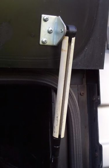

    Just do something similar. PVC with channel cut out that will snap over and hold up the strut. I've done this on struts for toppers before when they become weak. Works great.

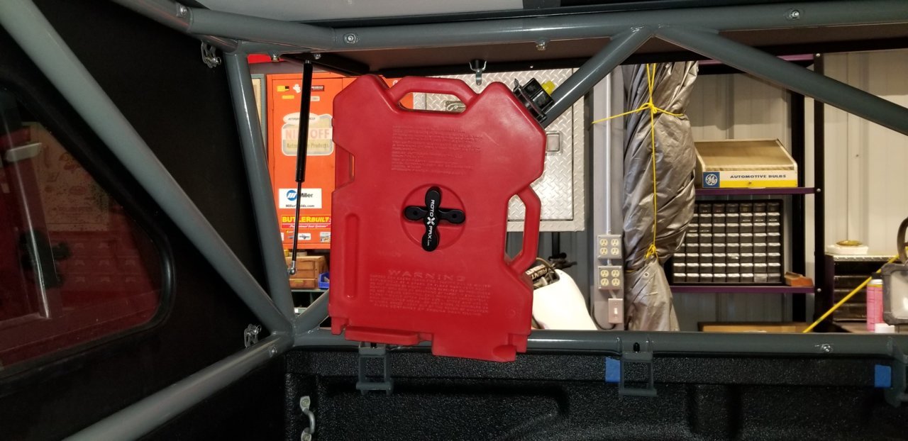

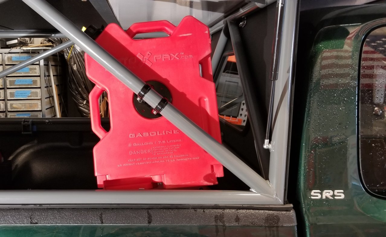

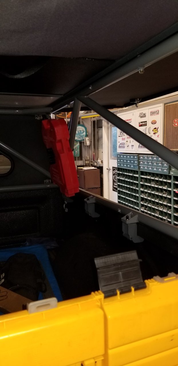

    Finally got around to installing a rotopax mount from AxisAlloys. Personally I'm not a fan of having my gear being on the outside mostly since truck gets left unattended while off hiking or fishing. This seems very secure and allows easy access without being in the way.

    Thats going to rattle like crazy against the bars, wear the powder coat right off in spots it touches

    Are you talking about the PVC spacers or the Rotopax post? If you're talking about the PVC that is why you cut the channel or groove in the pvc. When the top is up snap them in place over the rod of the struts. Just pull them back off before you lower the top. The PVC is cheap and easy to cut. If you're handy you can cut the groove yourself. If not I'm guessing you can find some one to cut the groove for $20-$25. While I have left them installed on toppers in the past, I definitely would not leave them on while travelling with the GFC.

    Pretty sure he’s not talking about the pvc. I do think that’s a good idea for helping to support the roof if you have extra weight on it.

    Rotopax, sorry just waking up.
    Slotted pvc is a great idea for the struts

    I suppose it could but I didn't hear any rattles with a full can, nor does it touch the panel. Have to push hard on panel to make any contact. Also put a layer of tape on the frame where the clamps go.
