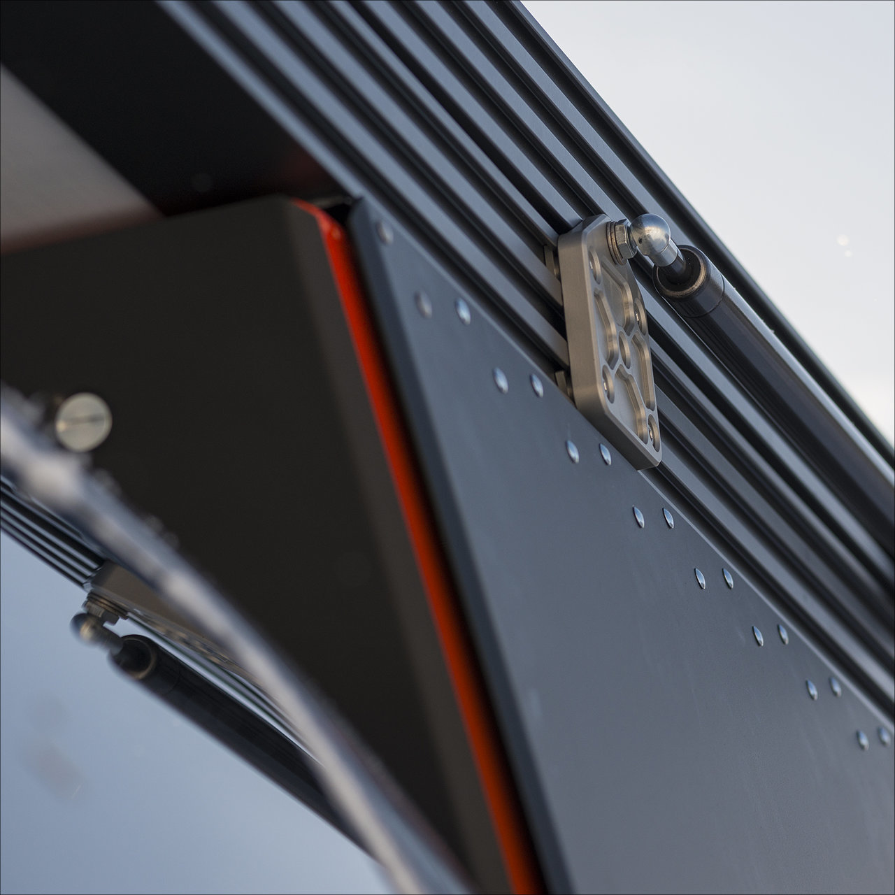

  12. Jan 15, 2018 at 8:35 PM
    #652
    wileydavis
    wileydavis [OP] Well-Known Member
    Nov 6, 2016
    #201729
    834
    Wiley
    2017 SR5
    It’s a one piece polyethylene hinge. The machined hinge was cool but didn’t prevent water from pouring in when open so we would have had to add a seal and it required more stiffeners in the panel which was heavier. So the poly hinge ended up being a lighter solution with better foul weather performance. I didn’t want to give it up but it’s hard to argue with simpler lighter and works better :)
