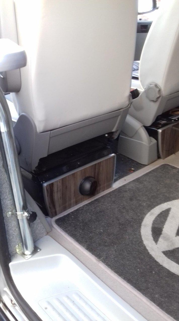

    VW, the origin of the 2003 Eurovan August 2018.jpg wedge poptop.

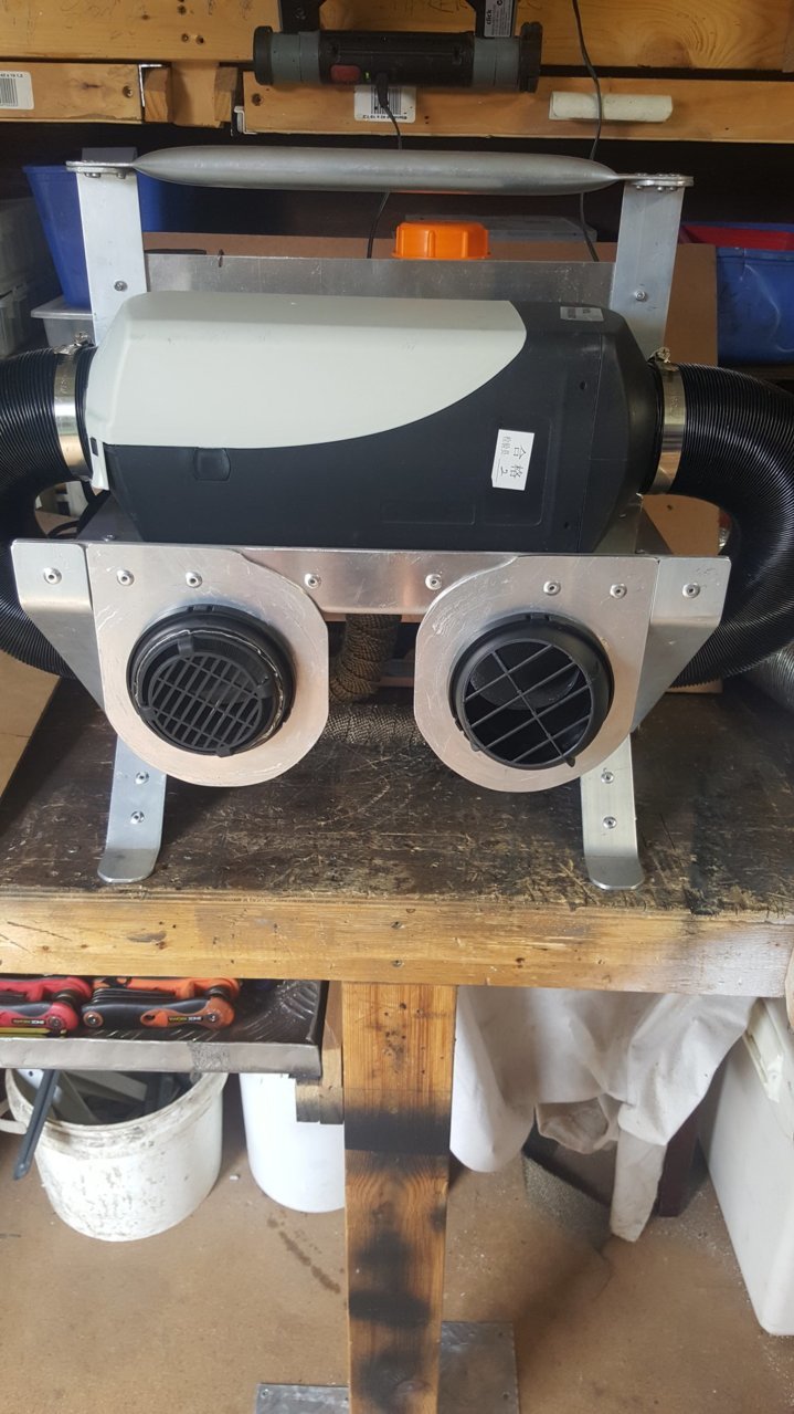

    Did you seal up the side pockets in the bed? I'm mounting my exhaust and intake for my diesel heater in the passenger side one and potentially using the driver side one as a positive pressure vent when i'm driving over dirt.

    Yep. The front side pockets I sealed with black spray painted butyl tape for the holes, and silicone around all the joints. The rear side pockets I did similarly and ran silicone through each bolt hole. Driver side rear pocket has my diff breather as well. So it’s sealed from the fender side but can still grab air from the bed side.

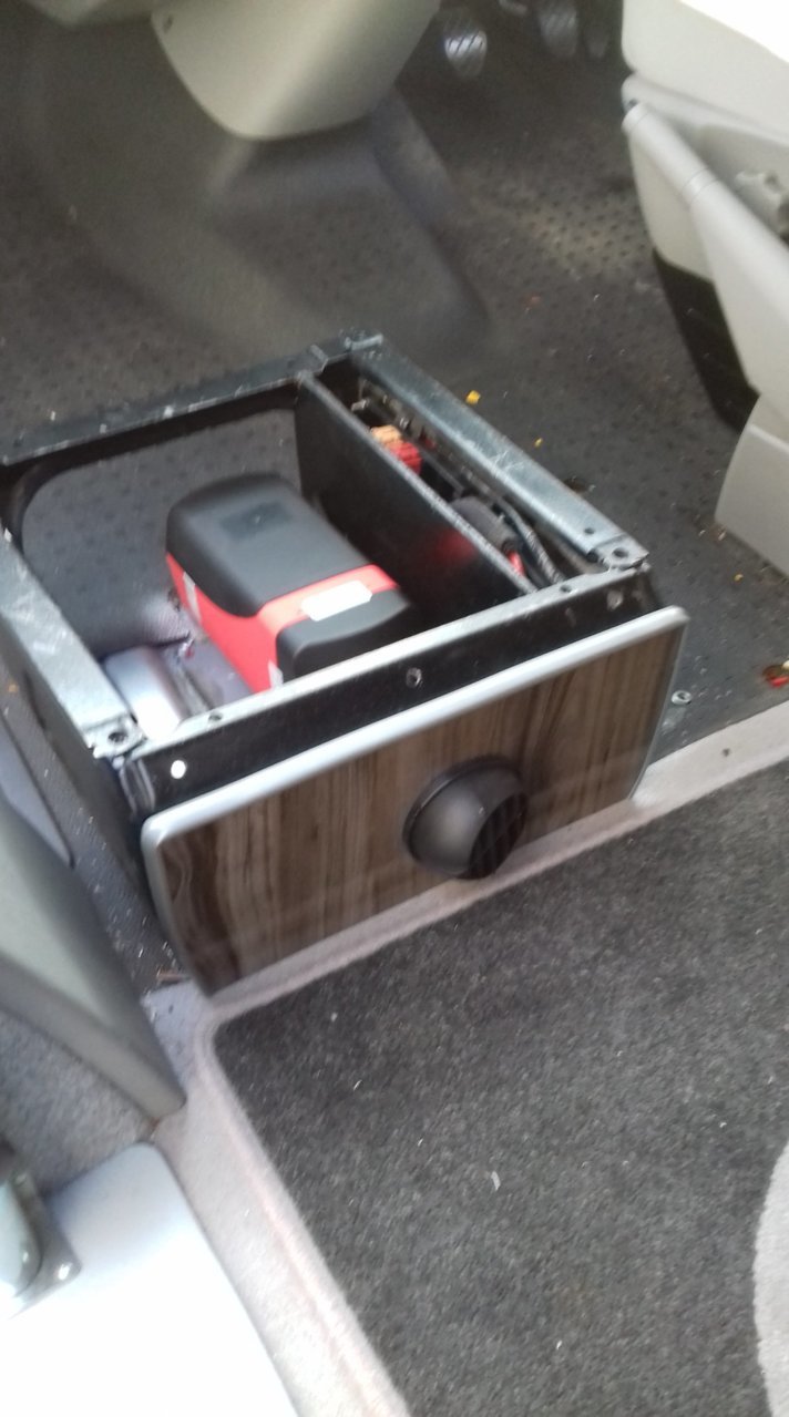

    It's on the list of to-do. I have a couple of 5KW Diesel heaters. They're kinda inefficient compared to the Propex ones because they use a glowplug for 5 minutes at 80watts to start the burner. But if you keep them on for longer than 20 minutes, you can actually use the exhaust gasses to run a series of inline TEGs to generate like 10-15 watts to charge the battery for the power lost. You can also keep the fuel tank inside the vehicle without any danger of it exploding. At the same time, you could spill it and make a minor mess.
    Propane doesn't work so well at high altitudes though.
    But basically you mount them inside w/ up to a 90 degree cant as long as the glow plug is facing up. The cheap chinese ones have issues with QA so you have to really check the seals and retighten everything, but then again, $200 bucks vs $800 bucks. A little bit of elbow-grease is compulsory. The 5KW units have a fuel consumption rate of .5L/hr, but I'd run it before going to bed and when I wake up. So 20 minutes at full blast is good enough for me. If it ever really gets bad at night, I can just turn it on with the wireless remote hanging from my neck.
    Just remember you want put the unit in a box so you can run a return and a hot air outlet. If you don't recirculate the air from your interior, it's basically wasting a whole lot of fuel trying to heat the wilderness which is supremely dumb.
    Tacodoc had a propex heater mounted similarly except his exhaust and intake went straight through his Tacoma's bed in two holes he poked through.
    The exhaust gets about 250F-275F, so just putting in an aluminum plate where the cubby is located would be enough to prevent the bed from heat issues. You could always seal around it with a cut out from a silicone cookie sheet.

    Well, if you're near the southbay, I can show you my heaters. Unfortunately, you have 3rd gen taco. They modified the build and no longer have cubbies on the side.
    These were originally used by the automated robots at the factory to pick beds from conveyers and place them on the truck frames during assembly. Somewhere down the line starting in 2014 or the 2015 model year, they retooled the assembly line to no longer need them.
    So folks like me have this great hole that dust and water can come in from. Ofc, I have other plans for them.

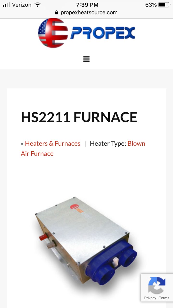

    The propex heaters work great. Just a little pricy. They now have an externally mounted unit. Looks like it could fit in one of the left or right rear quarter panels.
    I’ve used the hs2000 on small trailer before and only had one problem with it. The 12 volt voltage cut off was too low on the unit, like 13.6 or .8. When the Tristar solar charger would get up the 14.8 the control unit for the heater wouldn’t work. We had to pull the fuse to the propex to reset it. That unit is now wired to a switch to disconnect power during the day. We called them a year ago and now it’s nice to see there units have a 15 volt cut off. On a cold day you can see higher than 15 volts charging.
    We wrapped the forced air hot side pipe with header heat tape. It was about two inches away from an ARB 80 quart fridge. Temps were 220 degrees on the outside of the heated air tube before, after the tape it was under 90 degrees.
    https://www.propexheatsource.com/heaters/hs2211-furnace/

    Yeah, the Propex heaters are pretty typical because people generally use propane for cooking. I've just had some pressure issues with propane at higher altitudes. You won't see any issues like that w/ liquid fuel powered stoves unless they're sooted up and the generator or fuel nozzles get clogged. Plus fuel oil isn't pressurized or easily combustible, so the containers can be something simple like lightweight pet bottles, abs containers, dromedary bags.
    Plus for $225, I can get a heater w/ a remote control, ducting, a fuel tank, and all the accessories I need to mount/install/run the unit. I just need to provide power and fuel. I will need to baby the unit and run Kerosene every so often and run the unit at full blast to prevent carbon build up.
    The HS2211 is sold by itself w/ a rudimentary controller for $825. But you can run it at a low setting and a low speed setting without any worries about stuff sooting up. That's a pretty good plus. But yeah, in <20F degree temps, you might find yourself in a bit of a situation w/ your tank freezing up.
