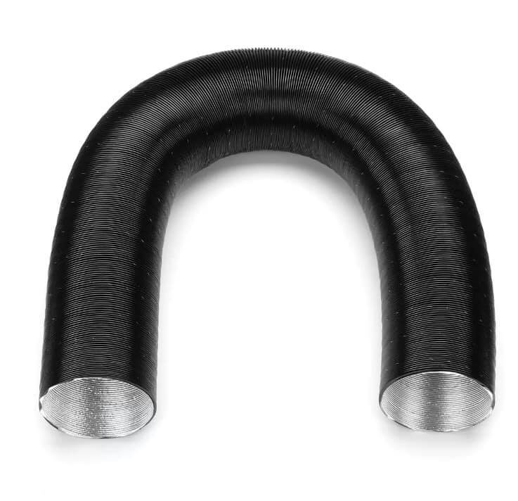

    The way the heater works is that cold air goes in from the return in the back and hot air comes out in the front, the design, while similar to the Propex, is slightly different. Generally people put ducting on the front outlet only because if you stow the heater inside a cabin, usually it's among cabinetry to reduce noise and also because it's unsightly and not something you typically interact with like furniture, a stove, or your bowl of apple raisin oatmeal. Since hot air rises, people generally just have the vent output on the floor.
    Also, the ducting, it's expandable. It might not be initially clear in the photograph.
    49614621_2247931921908196_25588303569082_45770dc01166992d2e552d787a5a8d377489a688.jpg

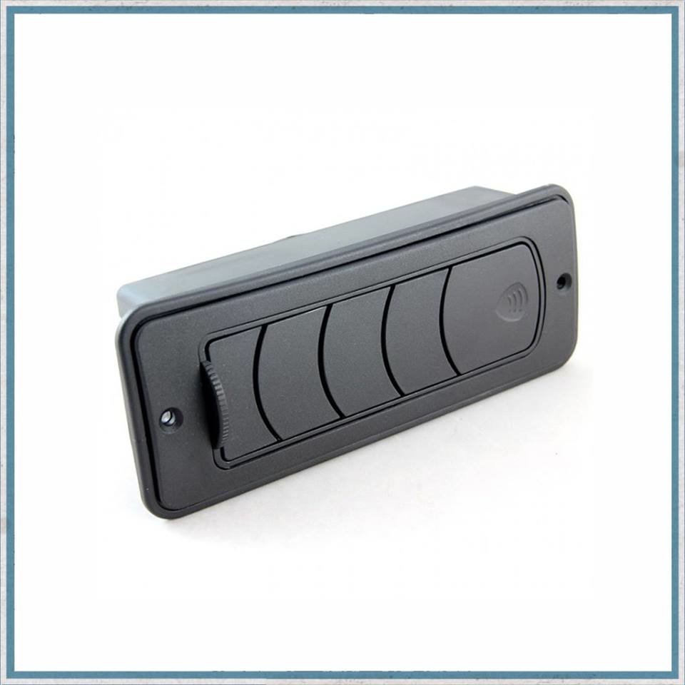

    you can pull it out so it extends roughly another ~50%. TBH, in my setup, the cabinet is open in the back for the return, and the front will be connected via a soffit vent.
