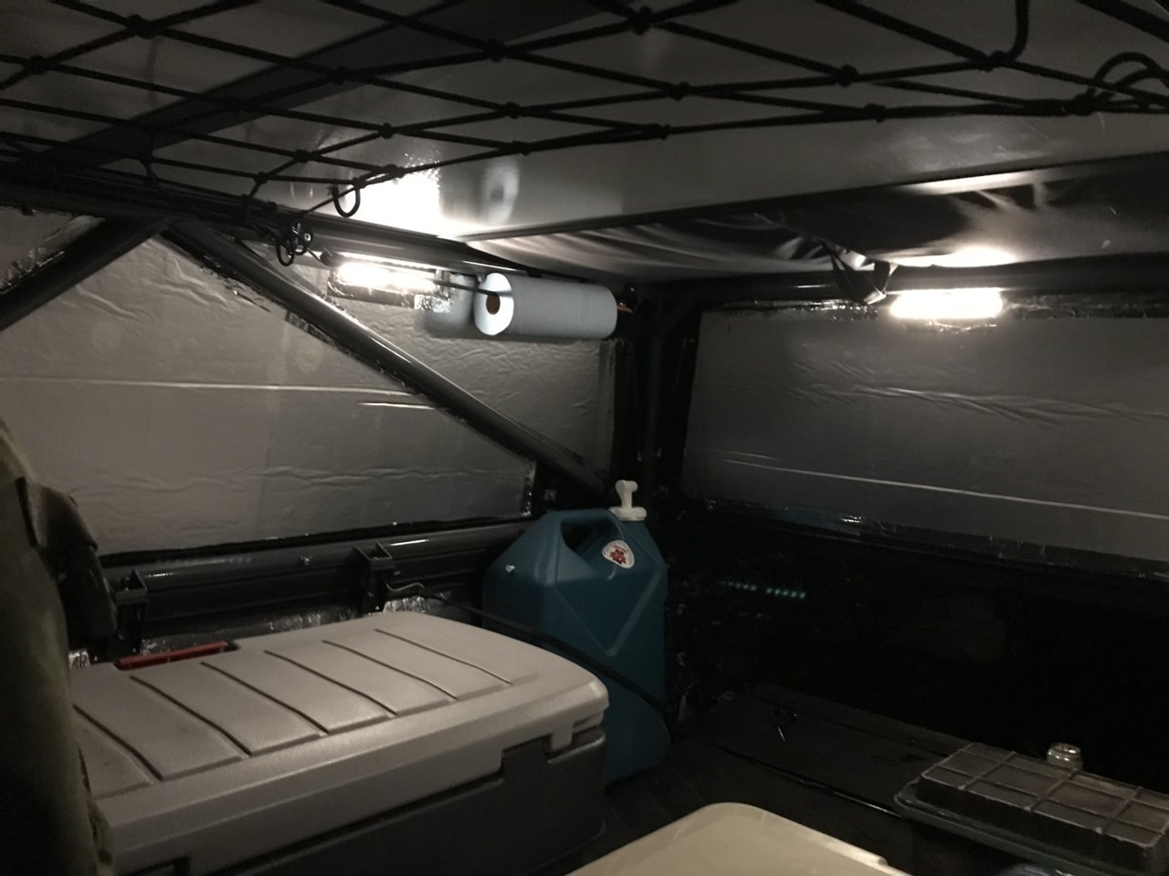

    I am about to be spending the rest of the month in my GFC. I decided to install some temporary insulation on the panels and bedsides. I am hoping it helps a little bit. I used polyiso foam board.
    Anyways.... back to arguing about locks, water, and geography.... :cheers:

    Looks great! Don’t forget to toss that on the GFC mods thread.

    How did you temporarily attach it? Velcro?

    I used reflectix tape. Planning on doing some more of the bed sides with reflectix tomorrow as well.

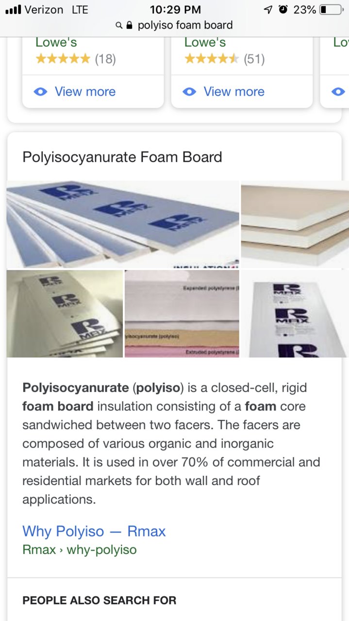

    So foam board like this? How thick?

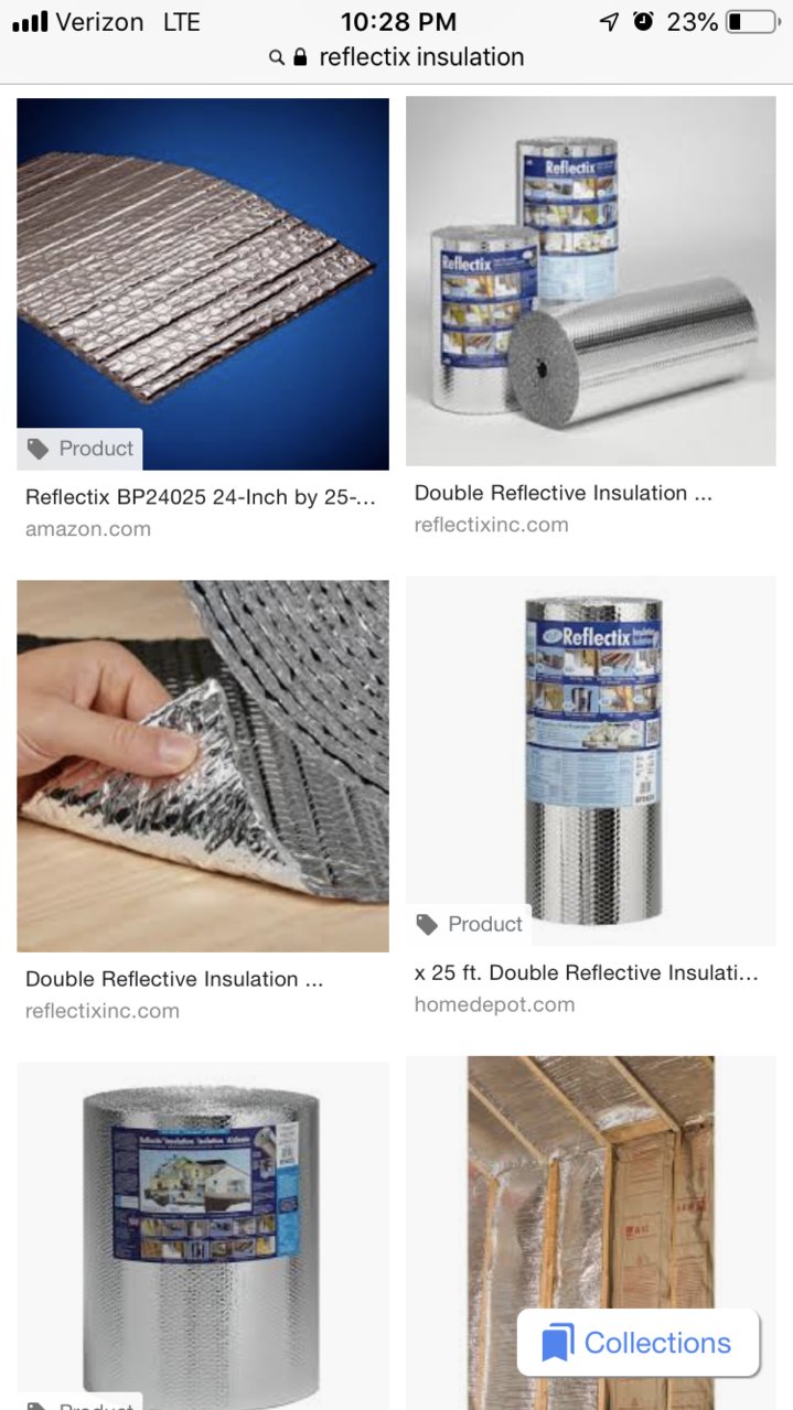

    And reflectix insulation like this?

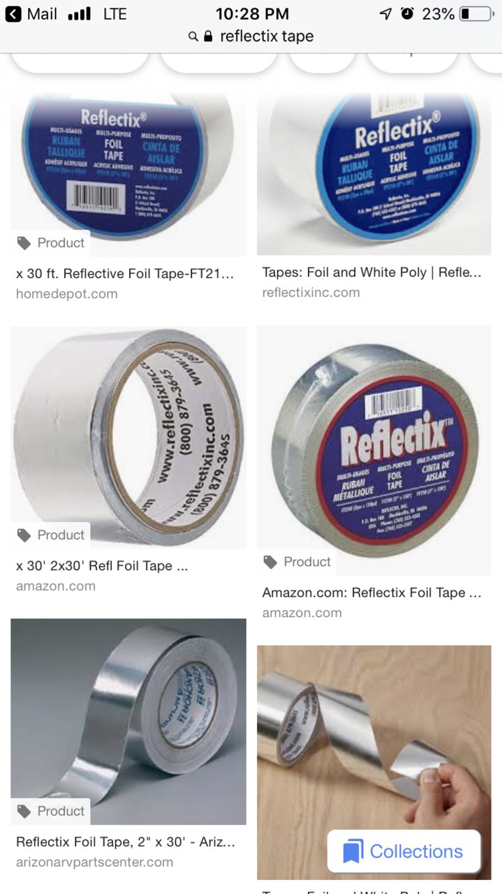

    And reflectix tape like this? Is this any different than foil duct tape?
    Curious how well it works!

    Yes to all 3. I used the thinnest board they had. It’s all so light you could go thicker.
    I’m not sure of the difference on the tape. I used some aluminum tape that I had from sealing up my bedsides once I ran out of the reflectix tape.
    Reflectix alone isn’t a good insulator. So I’m just hoping it might make a little bit of a difference in addition to the insulation board.
    This is by no means a permanent solution. Just trying to experiment and keep the dog a little warmer.
    I’ll be spending more time “downstairs” on this trip because I’ll be traveling with just the dog and me.

    To be honest. The panels sound so much more solid while closing. It’s pretty nice.

    That's almost exactly what I would do. I'd like to cover the the foam with white polycarbonate signboard, via contact glue, just thick enough to tap. You could then use that for various attachment points for light stuff. Hmm... might be more hassle than its worth?
    White formica would lighten up the interior, protect the foam and be easy to clean. Help with heat too, especially with the flat black that I'll will have....one of these days.
