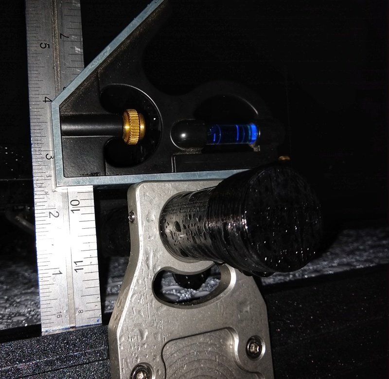

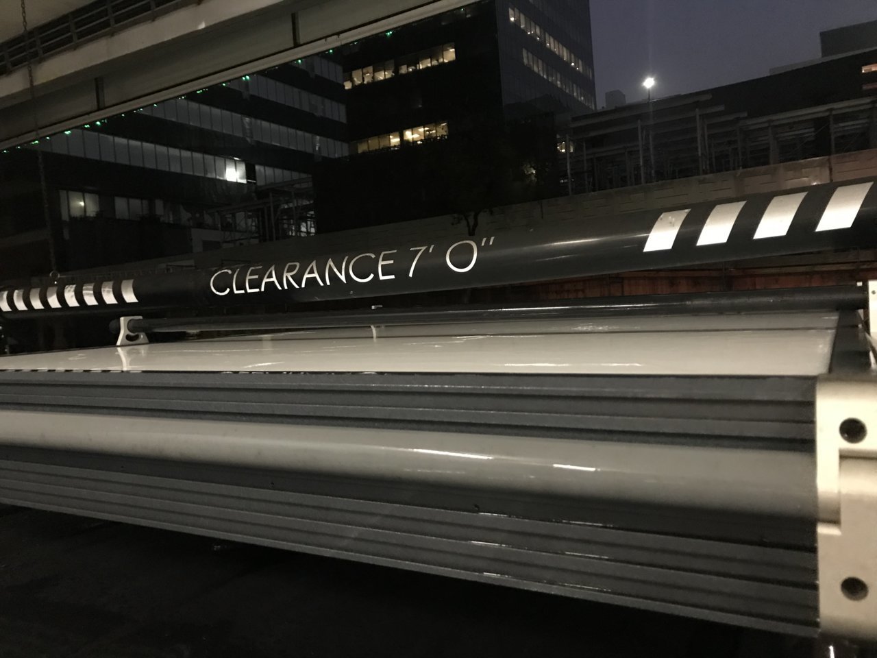

    Thanks for this! The cross bars are a little over 2 inches tall right? I think I’ll be able to fit in the garage at work without anything on top.

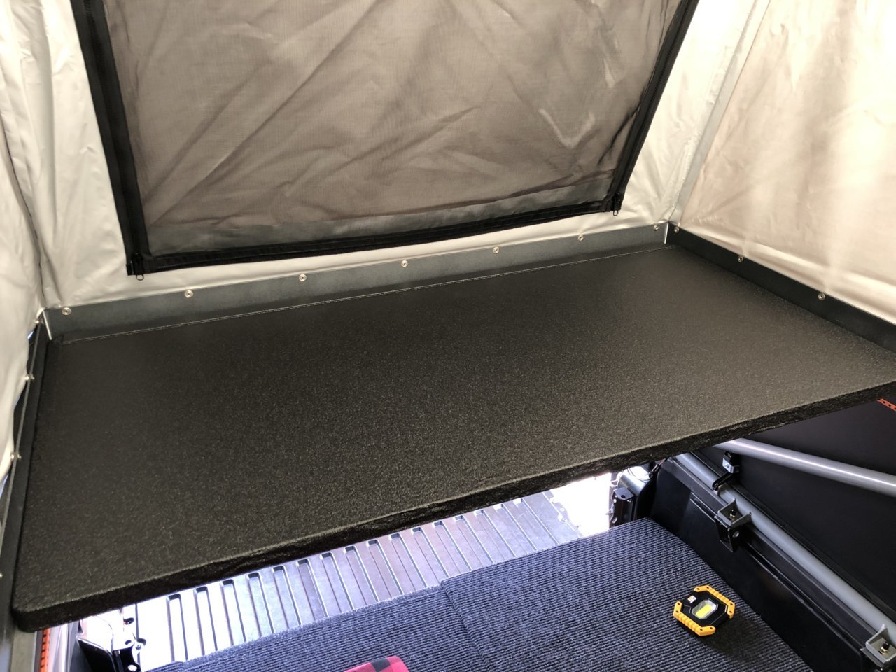

    Example... I’m in full size bed mode. The lip side of the big panel is facing the rear as it should to support the rear panels. If I remove the small panels and slide the middle panel towards the back I need to make sure I turn it around first. I forgot to do this one time and climbed up to close the rear tent window. The un-channeled side flexed a lot under load. It will probably hold a lot of weight before breaking but it sure didn’t feel good.

    Picture example.
    If I sat on this right now it would flex like crazy. Original panel had a c-channel that would have supported it.

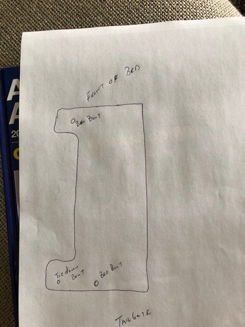

    I'm planning a 1/2 system myself. My current plan for tie down is:
    Use the bolts that hold the bed down and the bolt that holds the 'tie down'. I'm planning to head to the hardware store today or tomorrow to get bolts that are 1/2" or so longer to account for the plywood. My idea is to put 'flanges' on the plywood base that reach the bolts ahead and behind the wheel well.
    I just installed the 'bed rail' on the forward part of the bed. I will put 2 bolts through the cabinet and anchor them to this forward bed rail.
    I'm pretty sure this will be sufficient to hold everything down.
    You've got things pretty well dialed in and probably don't need my dos centavos. But, as much as I've 'borrowed' from your posts I thought I should chime in. :) IMG_1496.jpg

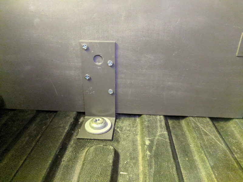

    I bought some of these which worked great for securing my deck to the bed mounting bolts:
    https://www.lowes.com/pd/USP-2-in-x-5-1875-in-Steel-Concrete-Angle/3692046
