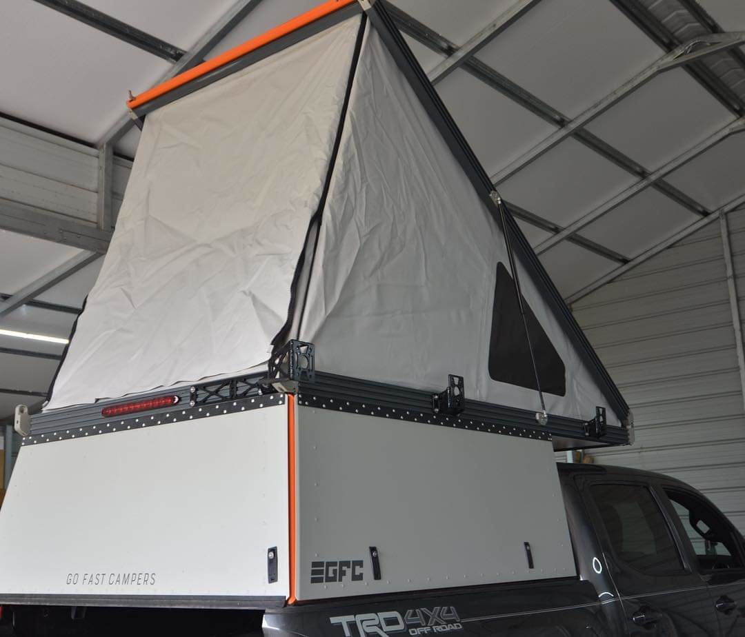

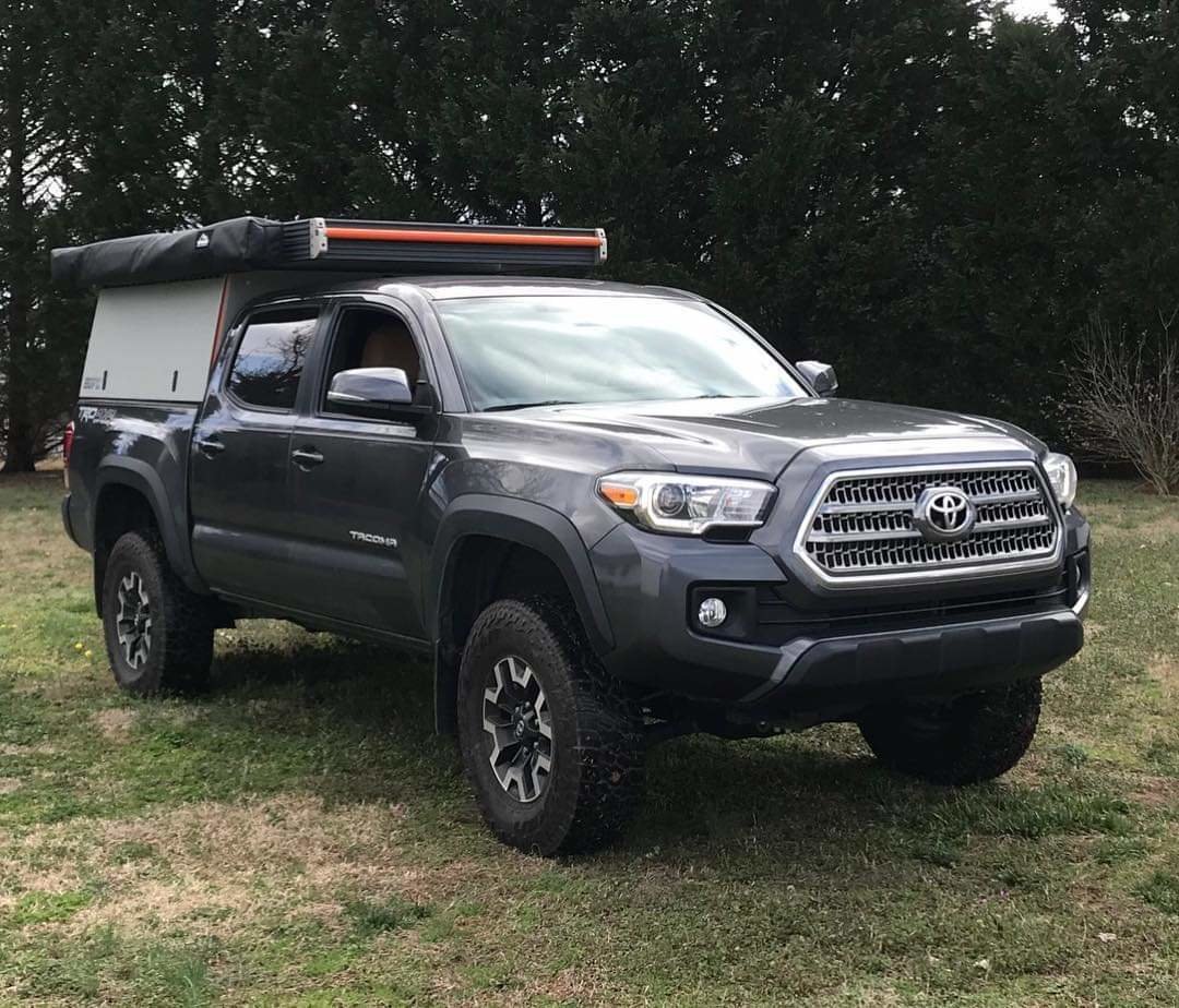

    Much more to come but here is a sneak peak. Full update to come once I have the pictures uploaded.Screenshot_20190216-171852_Instagram.jpg

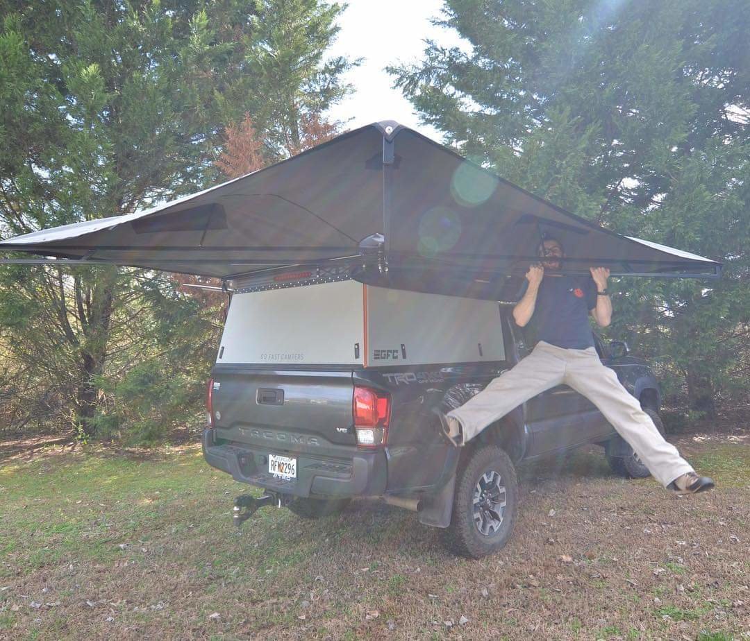

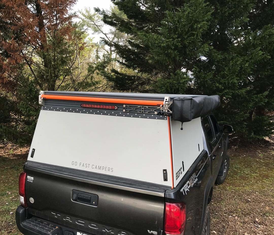

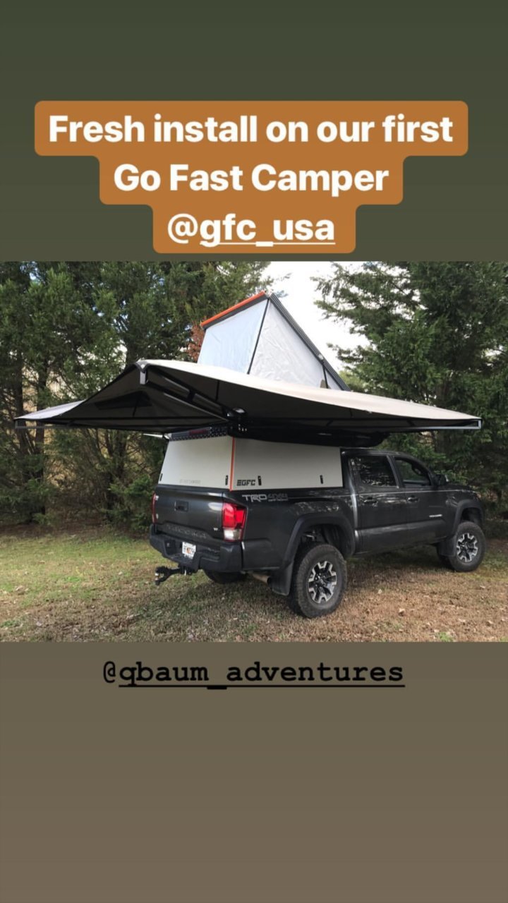

    Well, the official kinsmen hardware awning install was yesterday. I drove up to SC to their shop for the test fitting and overall install. I cant say enough good tings about this couple and their products. I would highly recommend you pick yours up in person if time allows, its was a great experience to see how they produce the awning from the ground up and how they're working hard to get this awning released with the highest quality they can produce. I am very impressed with the awnings quality and strength, as you can see from the photos. This should be the last awning I need to buy. The official release is soon (this spring or sooner) and he is still working on price point since they're are still nailing down some details. Much like GFCs, Kinsmen is working to continuously improve they're product and provide great customer service. I would not hesitate to buy from them again and I can not wait to really put the awning through its paces and get a long term review out.
    Matthew is going to make some small tweaks but overall he has the bracket design nailed down and it is super stout, as you can tell from his hanging off of it. We made sure to hang from the bar that put the most leverage on the mounts and they held up great.
    Full disclaimer: I am not sponsored in anyway, I just believe in these companies and love their products. I paid full price for what I have. I am not instafamous or a youtuber.
    Awning link: https://www.kinsmenhardware.com/

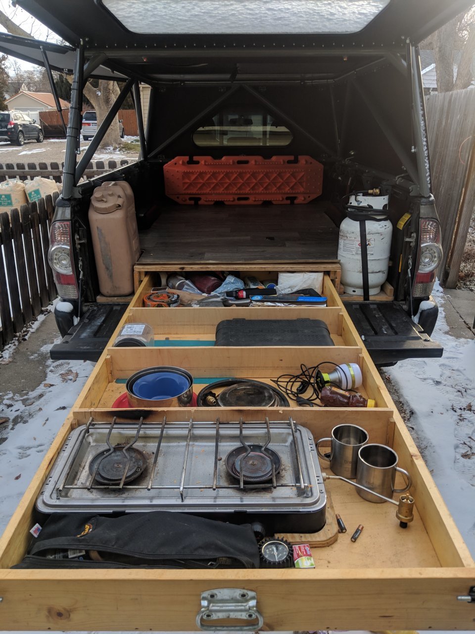

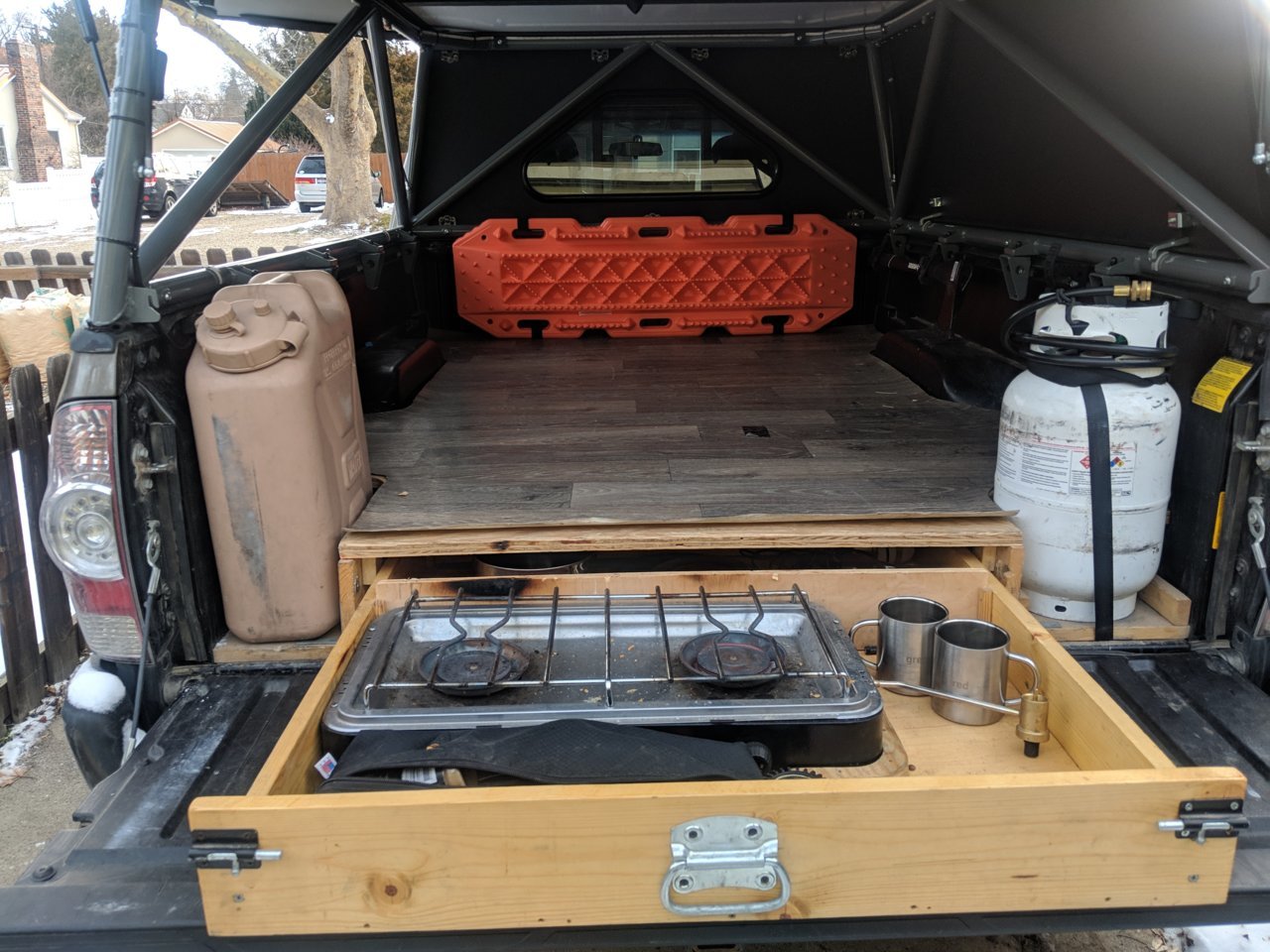

    You could add some aluminum foil tape to the backside of that cooking compartment to help with heat exposure. Standard practice for residential cooktop installation to mitigate damage to countertops, so not uncommon. Might help if you plan to use the same pan again.

    Are there chaffing patches for where the awning/supports contact the panels?

    -The rear panel lower rubber seal makes contact with the awning arm. You could add a patch of 3m tape or something but since its rubber on metal i didnt have him add that, although he did offer.
    -The passenger side panel only makes contact with 1 bolt. He is going to have bolt thread covers (like what gfc has on their exposed mounting bolts) but he is also making some slight changes that would fix this issue. 1. Raise the awning up .5" to 1" higher. 2. Using shorter bolts so the thread isnt as exposed.

    Awning mount looks good but I’m still a little uneasy with how much weight/stress is on the small aluminum washers held into small aluminum channels by very small bolts.

    These awning mounts use a newly designed tnut that gfc has developed. They use a 1/4x20 bolt instead of the smaller size currently offered. Matthew at kinsmen also has a lot more bolt holes than what we are currently using. I currently have 3 mounts with 4 bolts per mount but I could use 6 bolts per side mount and 8 bolts on the rear mount (handles most of the load) if i wished.
