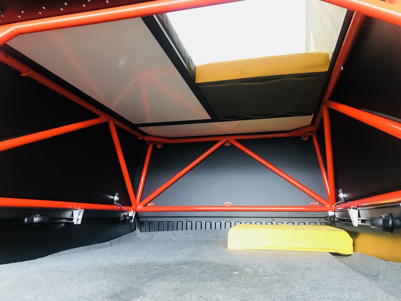

    Anything specific you’d like to know/see regarding the interior? The lower section looks a lot like this, not including the carpeted bed platform of course.

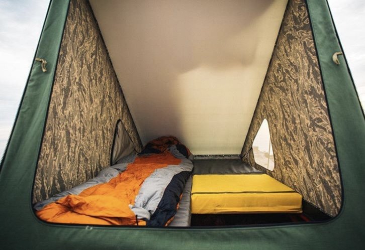

    And the upper section looks like this:
    In the final version the mattress cushions will all be the same color and the tent will be gray, not camo.
    The first two production units will be ready in early March and we’ll make a wall around video of those. But in the meantime if there’s something specific you’d like to see I can shoot some video of it as the only changes from this prototype will be color and finish details.

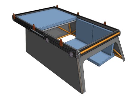

    The camper seals to the bed just like any topper. We'll ship it with gasket that looks like this:

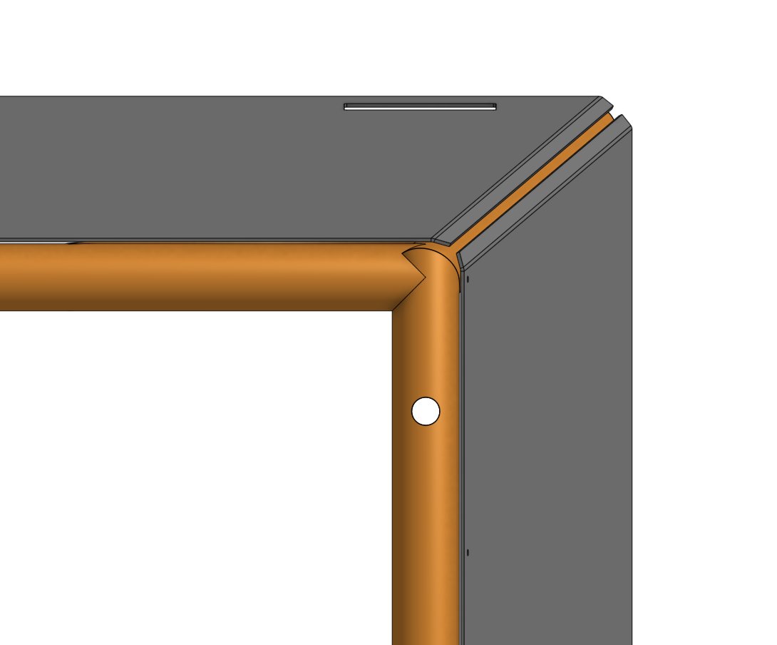

    Here's a cad screenshot of how the panels come together. At each corner there's a 1/4" reveal of the tube structure. On the inside of the panel, just to the inside of the bend, is a rubber gasket that seals to the face of the tube when the panel is closed. This gasket also prevents the panels from rattling (the camper doesn't rattle at all in the rough stuff). The top edge of the panels is sealed by the continuous hinge.

    The floor panels are a composite honeycomb. The two smaller panels have the honeycomb installed inside the cushion cover since these get removed most often, that way you're not having to remove the cushion and the panel separately. The large removable panel is separate from the cushion.

    We're not skimping on the mattress since there's only 1" of space between the mattress and the roof panel when the tent is closed, so only enough room for some compressible sleeping bags and camp pillows.

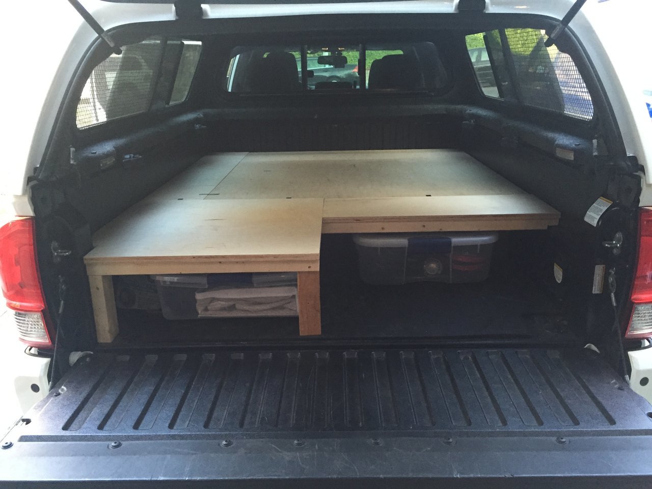

    I’ll still be using my current basic platform until the release of the gfc or just design a new one that has a slide out for the fridge, stove, and table.
    Current set up:
