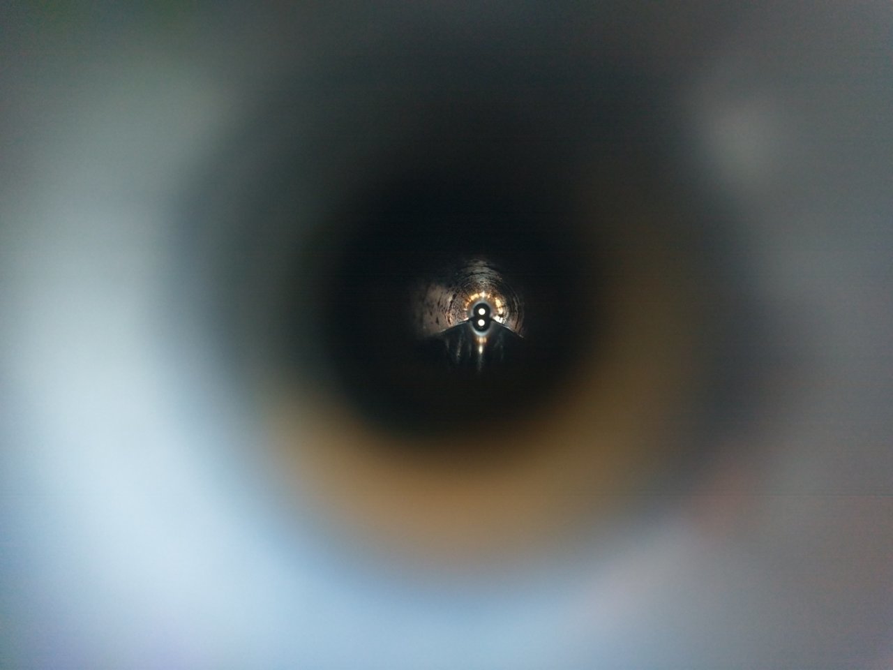

    I'd be worried that would just add places for water to get stuck. I think a couple drain holes on the bottom, a thick coat of paint, and the occasional spray of WD40 or better would be sufficient. It's not unlike the rear tube where there's already slots cut in it for the latches. I guess I'll have a close look over that one and see how the inside of that tube looks too, but I did spray some Ballistol in there a few times.

    I wouldn't spray any foam inside the tube, won't block water intrusion and would be a nightmare to completely dry out. I'd remove all the bolts and blow some compressed air in all the holes to try and dry it out. Then spray the heck out of it with some Boeshield or something similar. Drilling in some drain plugs probably a good idea. Keep us informed as to what you do and if you ever find the root cause of how the water got in. Good luck.

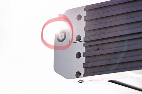

    I’m on the dry, clean and coat with a rust preventative agent team. I went and looked at mine and can’t see any obvious way for water to get in. Did removing the two allen head bolts on the ends of that tube expose the picture you took? I’d like to open mine up to check since we live in somewhat similar climates.

    Plug it with Sikaflex.:D Rust needs oxygen. Start with a dry tube and plug the tube just inside of where the bushing ends. There's no way that water can get in and if rust is already occurring you can stop it by cutting off its supply of oxygen. Also Sikaflex will cure in moist conditions; in fact its moisture cured. I've used it a lot in the marine trades. It will stick to most anything.

    Yes, just pulled the two Allen head bolts.
    No. This is the tube on the outside in the front, between the hinges.

    I would drill some small holes in the bottom of the tube for drainage, then add the wind skid so you never see the holes, at least that is probably what I will do if I have the problem - still a few weeks out from picking my GFC up.

    Can’t you just park it on a hill for a little bit and let the water run to one side then shop vac it out?
    I know this doesn’t fix your issue but I would for sure recommend contacting GFC before you go drilling holes or filling it with foam.
    I haven’t received my camper yet and I’m still kind if wondering where this tube is exactly and how is it covered normally? Can you take more photos?

    That would get some water out, but not all of it. I would really like to just remove that tube.
    It's a straight piece of tube with no welds, holes, etc. Not the main frame.

    This one. Got ya!
    Is the black area around the Allen bolt rubber? Like an expanding plug or?
